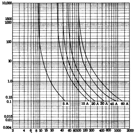

If I'm reading this correctly, a 30A rewireable will withstand 47A indefinitely:
but it will get a bit hot. 45A would be a much better choice, but then you wouldn't be able to use 10mm cable because you need to derate it if you're using those fuses.

That's an interesting graph! I knew wired fuses ran well above their rating but I never realised they were that tolerant ..... thanks for posting that Ban

To rupture a rewireable fuse instantaneously requires twice the rated current. IE 60A to blow a 30A fuse.
