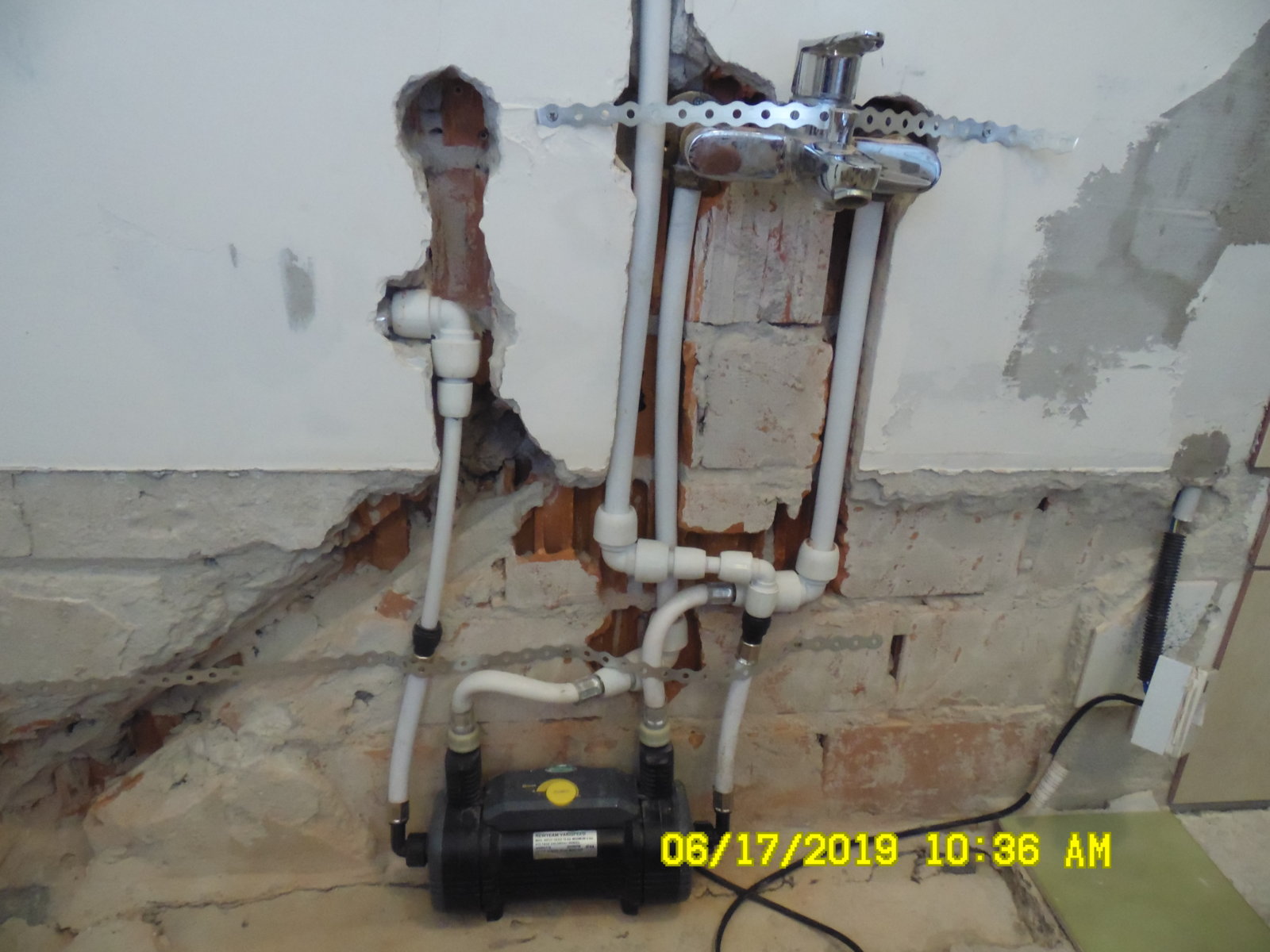

My hot water is a gravity system and the shower has always been a pathetic trickle. Some time ago a friend gave me a couple of secondhand shower pumps, the sort with a central motor and pumps each end for hot and cold. He also gave me some hoses for connecting to the supply and shower mixer plumbing. These only fitted the newer of the two pumps, so that is the one I used. This unit had no markings for what pipe goes where so I looked at the manufacturers website where I found circuit diagrams. These showed the end connections as inlets and the top connections as outlets. I assumed that it did not matter which end of the machine was hot and which cold but now I am not so sure. I mounted the pump under the bath and connected the left end to hot and the right end to cold, to match the way the pipes enter the shower mixer. The pump works fine for a couple of minutes then the motor seems to slow down for a few seconds then shuts off completely, leaving the shower output the same trickle as it was without the pump. I decided to try the older pump so today I bought adapters for the hoses, 3/4 inch down to 1/2 inch. I just looked at the older pump, a Quantum and it is labelled cold on the left, hot on the right. Do you think these pumps are the same both ends or can the hot only go to the

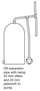

"A 'Surrey' or 'York' flange should be fitted in the outlet from the hot water tank. These fit into the standard hot water tank outlets but draw the water from below the very top of the tank to avoid drawing off the aerated water. Air in the water will cause problems with the pump."
Could that be the problem? When I originally put in the hot water system I simply drew off the water from the top of the cylinder.

It shouldn't matter which way round they are. They are designed to be fitted in airing cupboards though, as close to the hot water cylinder as possible, and the hoses on your outlets are bent far too tight. I wouldn't be surprised to see the hot one collapse and kink when it gets warm

I have now had a new idea that I can try. The outlet at the top of my cylinder is a stub of thick walled copper pipe with a 22mm compression socket at the top. If I recall correctly, this fitting does not have a stop so it should be possible to use a longer pipe that pokes several inches into the cylinder. If I solder a disc of copper to the end of that pipe and drill side holes I will have something akin to a Warwick flange. This will obviously be supplying all the hot taps as well as the pump as I will not have the tee arrangement of the flange. I was not keen on having to run an additional hot pipe anyway as it would be a big job.
Now think where will all the released air and CO2 go to? Will it be trapped at the top of your cylinder and depress the hot water surface until the same aerated water emerges?
I'm afraid that extra run of pipe and a Surrey flange may be necessary after all.
Will it not go up the vent pipe?

I see that the pump is connected to the bath taps, these pumps are really just for a single shower, so if you have been trialing it with the bath taps open, maybe you are exceeding its design capacity.

Here's an alternative way to a fitting a flange to get an air free supply.
