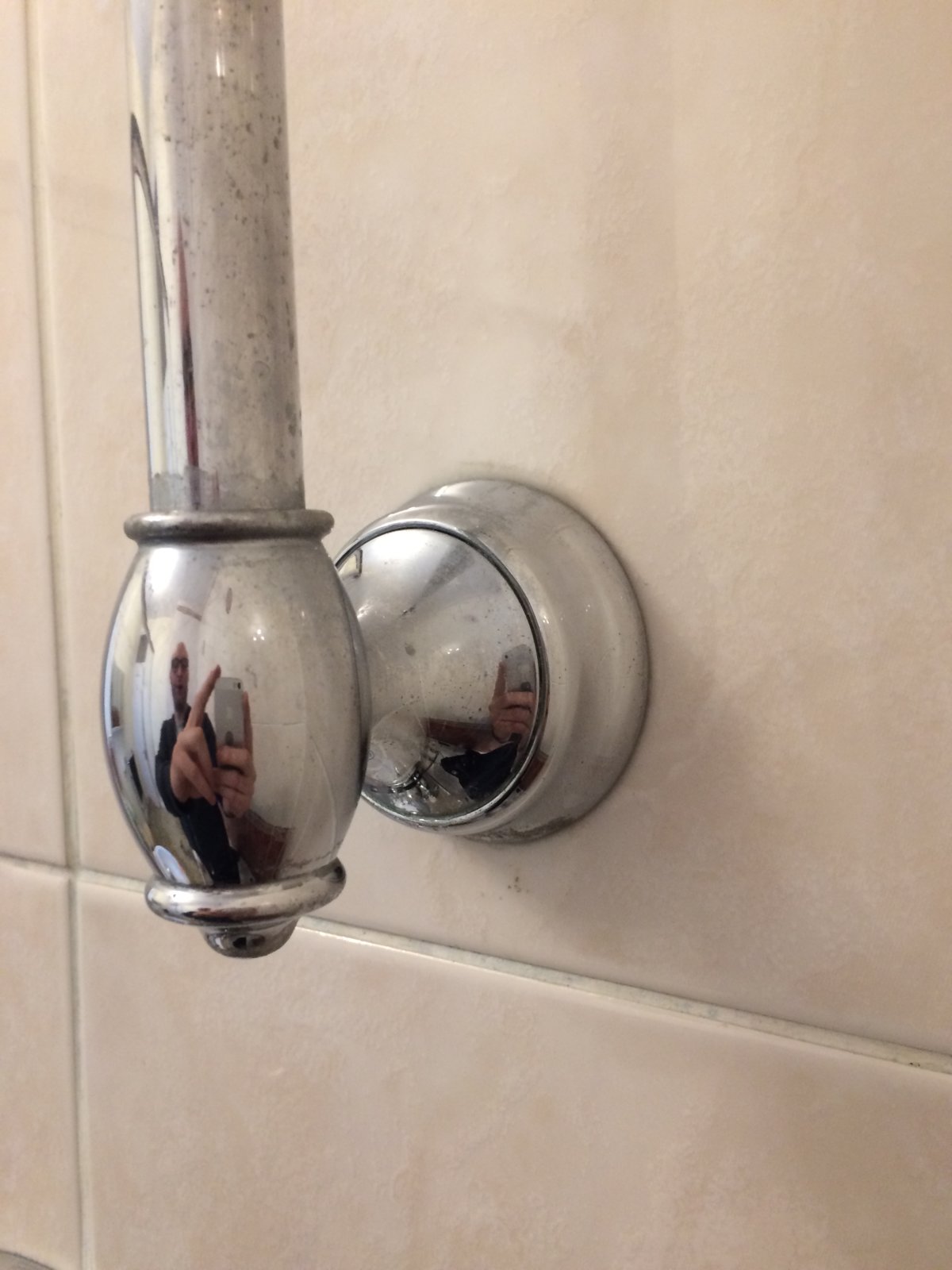

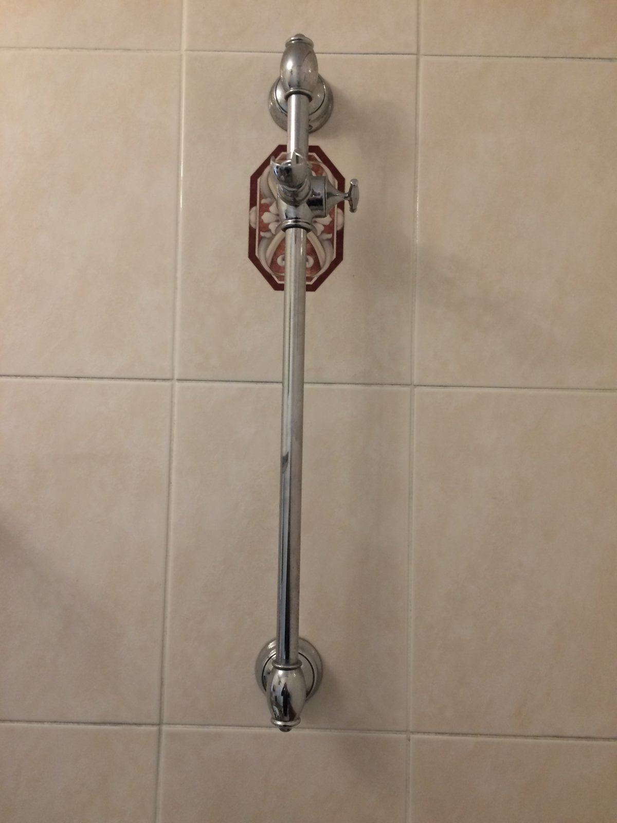

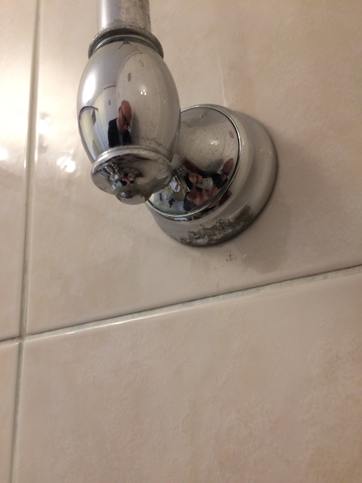

Hi All
I know it’s been asked before, but I’m struggling to remover my riser rail. I can’t find any decorative caps that could be hiding screws!
Pics attached. Thanks for your help.
MBR
87F3C4EE-87D0-4580-91F5-CA619F324FC5.jpeg D9E68B52-7DC9-4742-84F3-12A5404B7AF6.jpeg 2CD1AF53-DB5B-4867-8F20-0ACE81A52A88.jpeg
I think the chrome collars that are in contact with the tiled surface unscrews , exposing the anchor plates that are fixed to the wall
Thanks for replying. That was my thought too. I have tried that but no movement. It does seem to be the only option though - I’ll put a bit more muscle into it!
Thanks again!
Done!! God that was tight!
Thanks again for your help.
