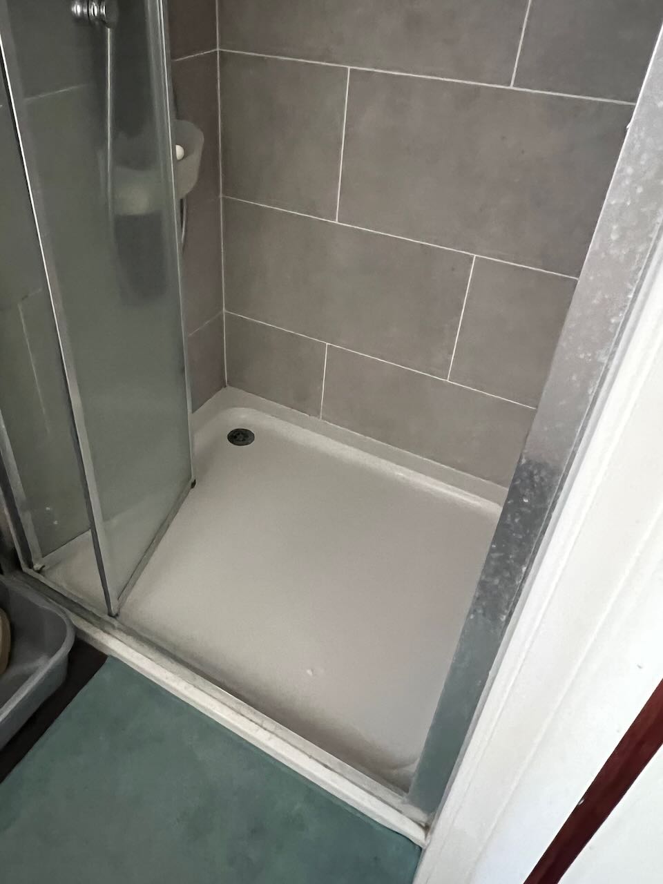

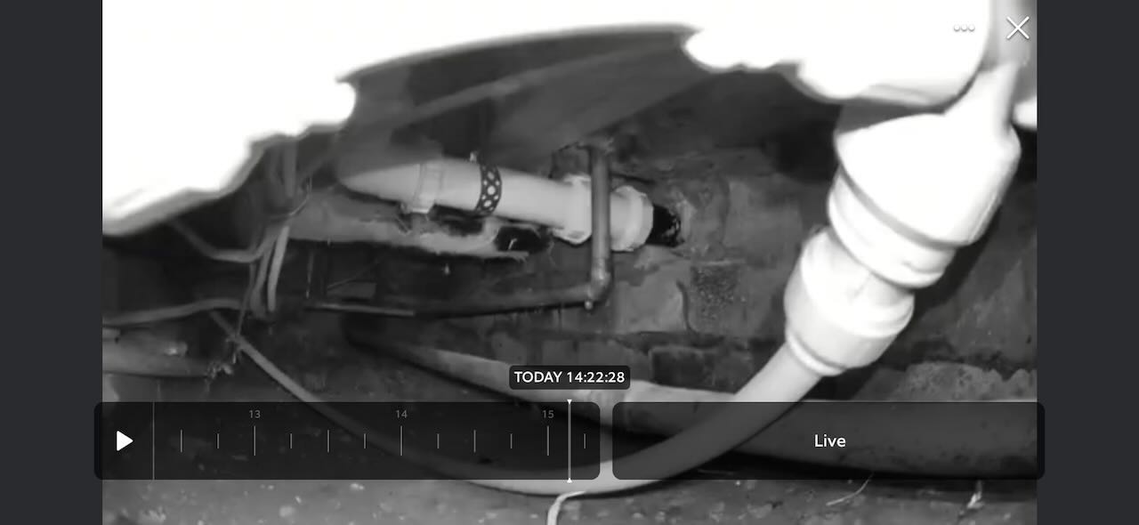

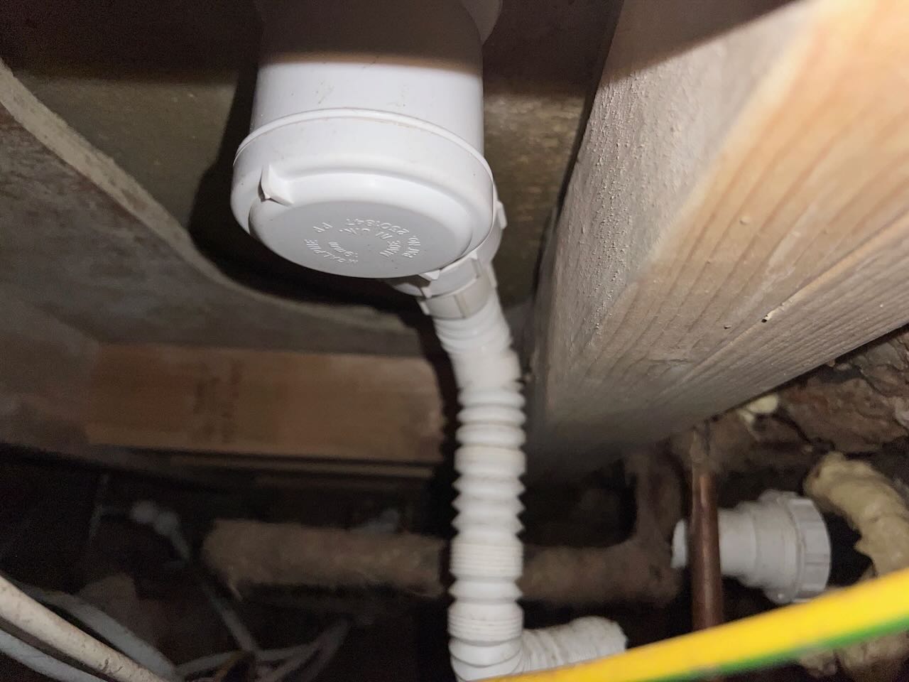

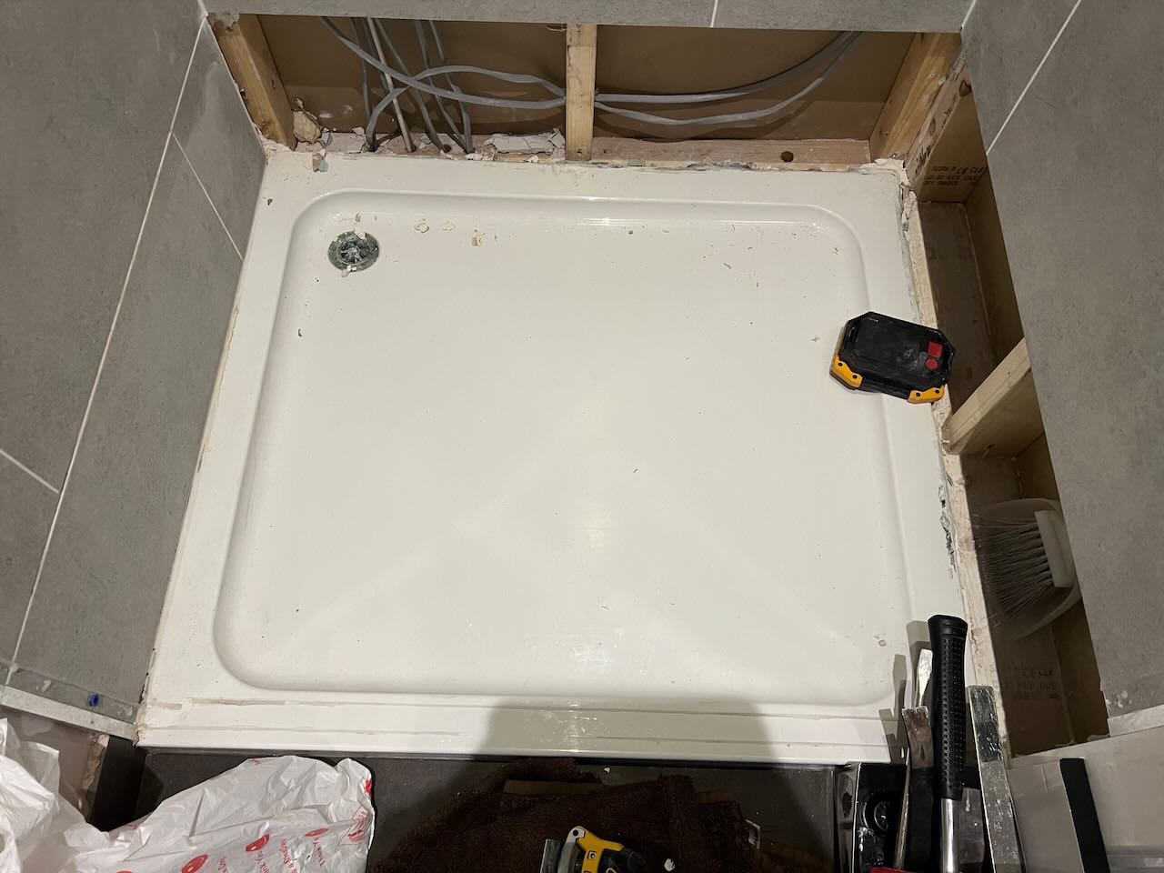

Im replacing a shower tray. Rats had bitten through the flexi waste pipe from the trap otherwise the shower was working fine for 12 years with no water ingress anywhere.
I removed the shower bi-fold door + tiles on the 2 plaster boarded sides with a multi-tool. Seem to have achieved a clean cut out on both sides.
I didn't want to disturb the wall side because of plumbing and its much messier dealing with a wall. I then removed the old tray by cutting it out as no space around edges to lift it out.

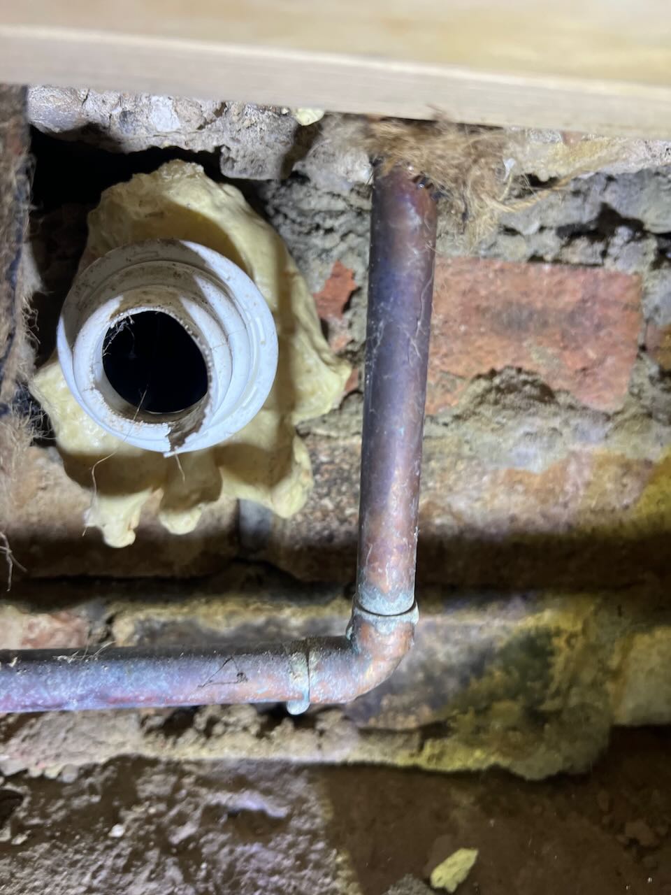

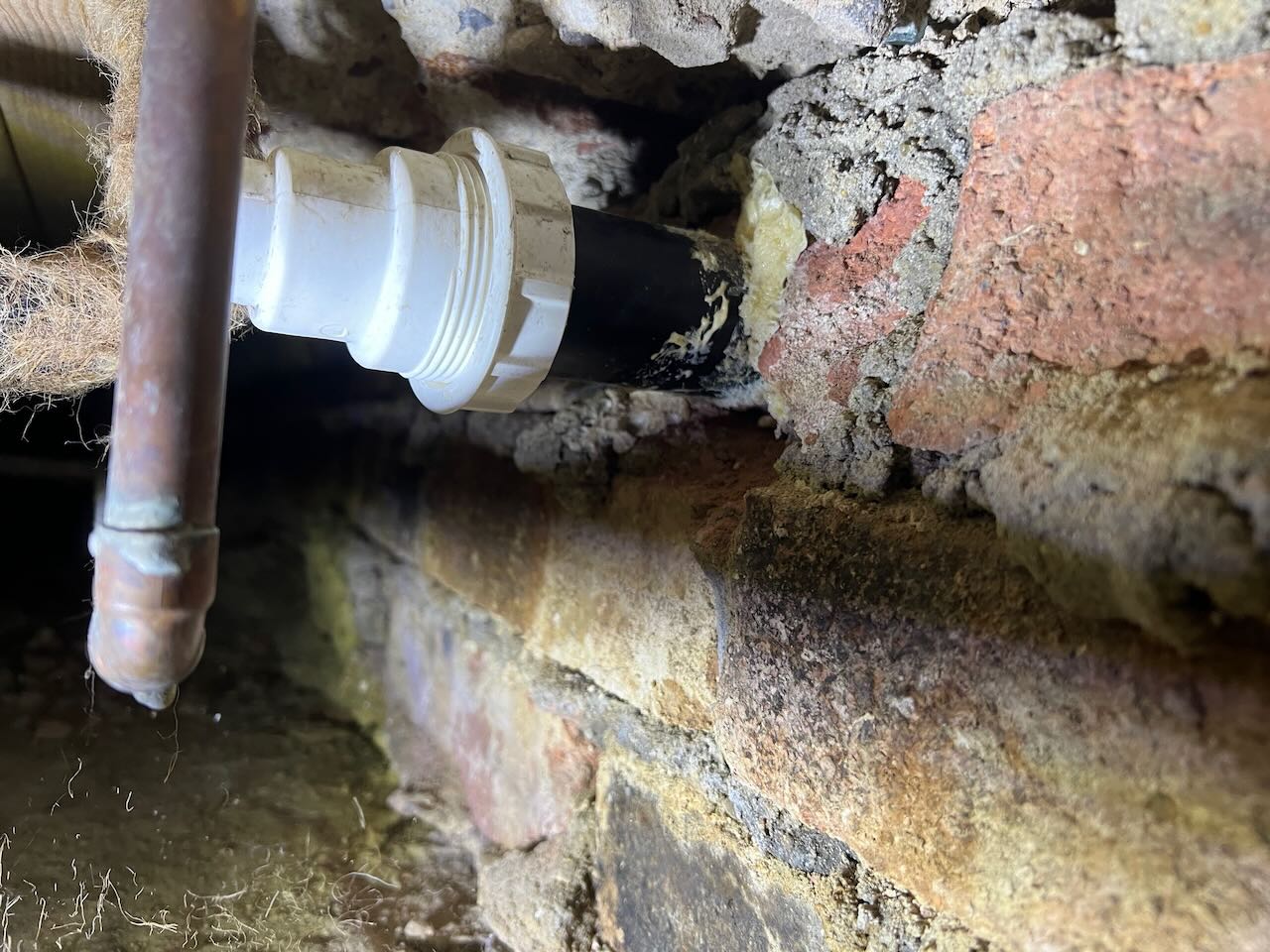

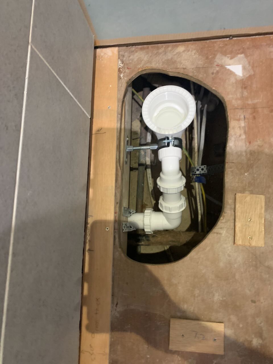

1. Is there an easy way to remove the old connection to the waste pipe? See pic. Its obviously glued on. I was going to cut on one side carefully if i can without cutting the external black waste pipe with a mini wireless dremel then use screwdriver to *hopefully* prize it off. Any easier way? It's in a tricky position.

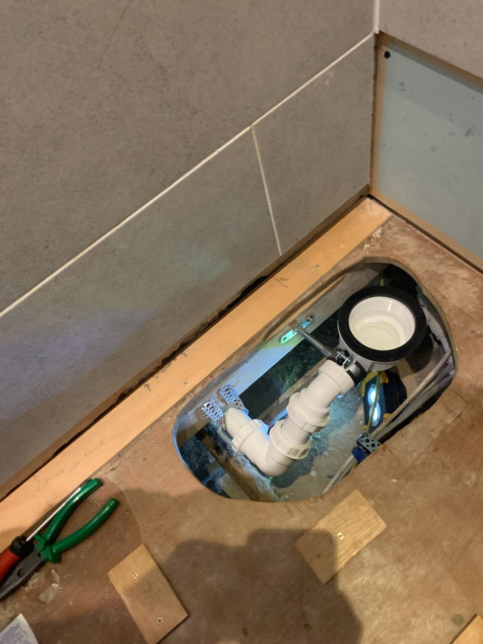

First, I'm going to raise the floor using exterior hardwood plywood as the new tray is 45m high but the current gap to the tiles on the shower side is 60mm - so the final gap will be 2mm for silicone. Could have brought a 50mm tray but higher prices + felt matching old might be best move. The old tray was 45-47mm high. Correction* : the floor is not level. Its 9mm lower on the shower side so ill need to put down a sloping piece of plywood = 10mm right to 1mm left.
Do I need to treat this new raised wood? The existing plywood does not look treated but was probably also pretreated external plywood (18mm).
What is the best way to connect the new trap to the waste so it never leaks or is bitten? I will be using a solid pipe. It will be floating, but supported, in the correct position until connected to tray. The rats are gone.

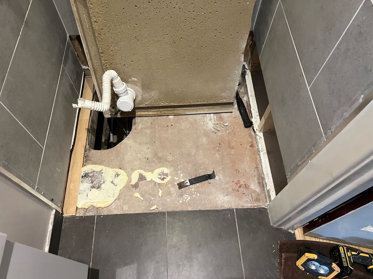

1 - how is was
2 - the bitten waste pipe
3 - removing tiles on 2 sides so tray can be removed.
5 - removed. can see piece of 7mm wood on left which was raised only that side.
6+7 - old connection on waste

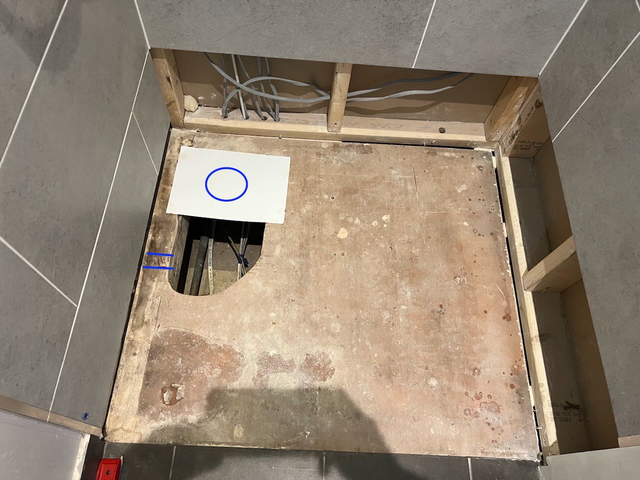

10 - cleaned & prepped ready for tray. blue lines is where waste is and circle is roughly where the trap will be suspended.

Is there a room below the shower tray. I just find it easier to remove part of the ceiling plasterboard below and do the work underneath. Also, fit trays with the waste on the opposite side and have a trap door in the bathroom/en-suite floor to access the trap (joist positioning permitting). Trays should be bedded on a screed of mortar containing SBR.
The waste pipe is probably solvent weld which means cutting it. I've seen on YouTube etc.. solvent weld reamers so you can ream out the pipe out of a solvent weld fitting.
The waste pipe section in the wall - pic6/7- is a compression coupler end of the old flexi onto the (edit) black waste pipe - so you just need to undo the nut and the whole white section will pull off, use a couple of sets of pump pliers if you need the extra reach

just use water resistant wood - WBP ply/OSB3 - if it is all sealed and no water gets to it it doesn't need treated but I always tank a shower space 'just in case'

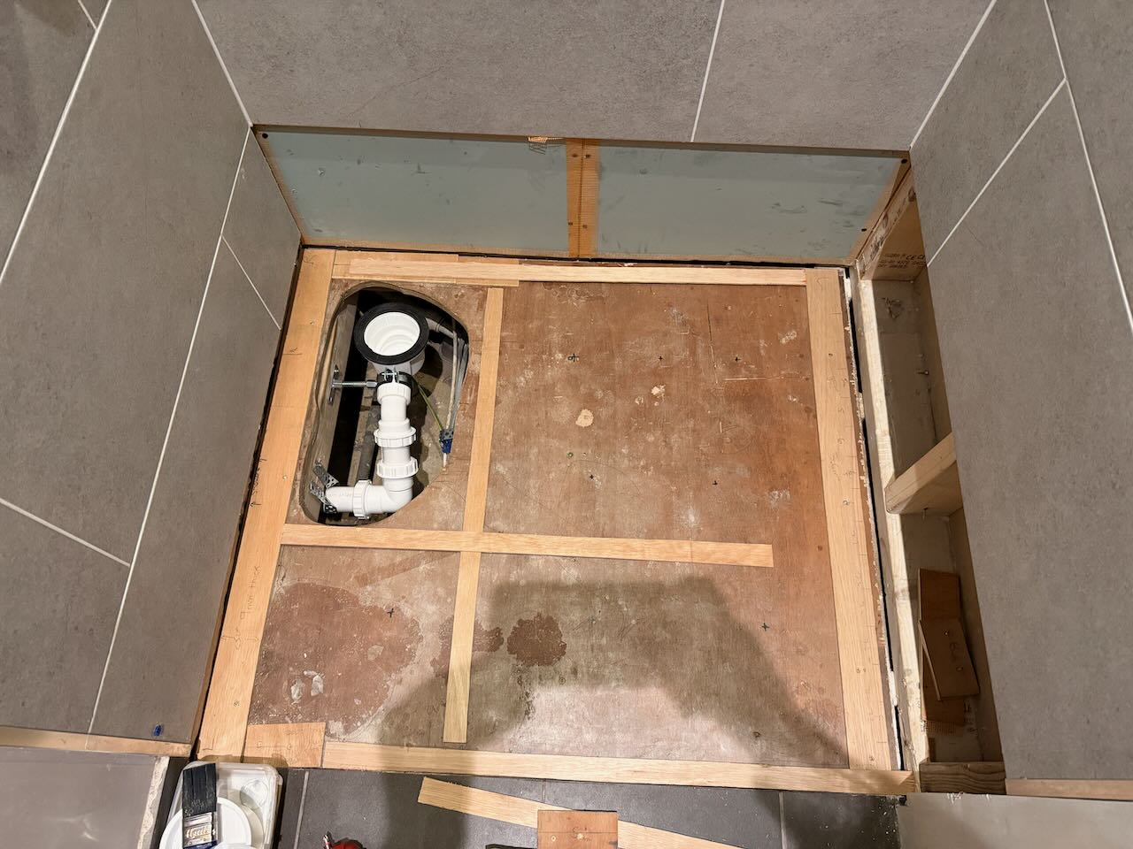

It a ground floor shower so only access is the hole in the plywood floor. Main bathroom is upstairs so this 'extra' shower + toilet were added when we did kitchen extension. As its an existing shower setup I'm just replacing like for like.

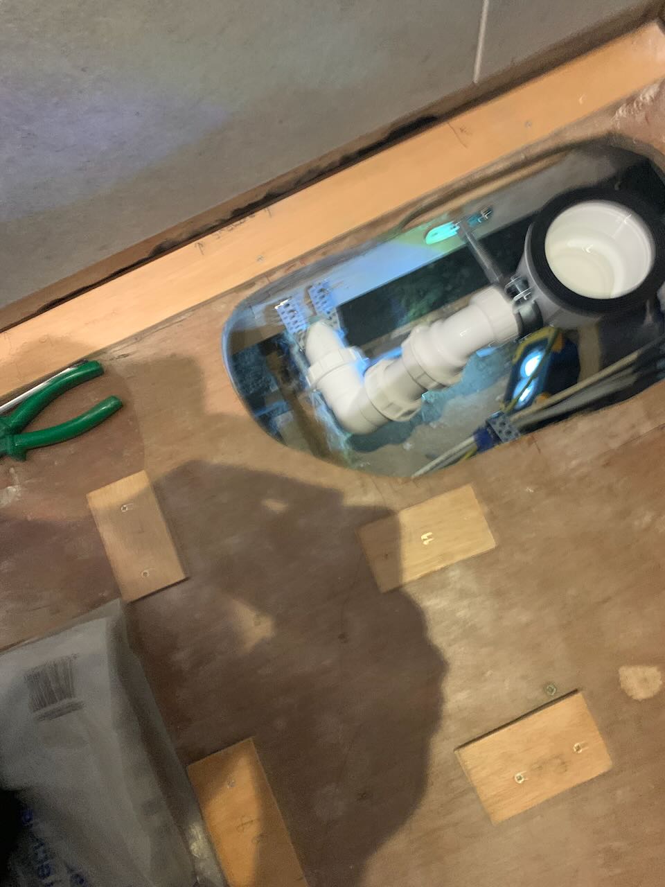

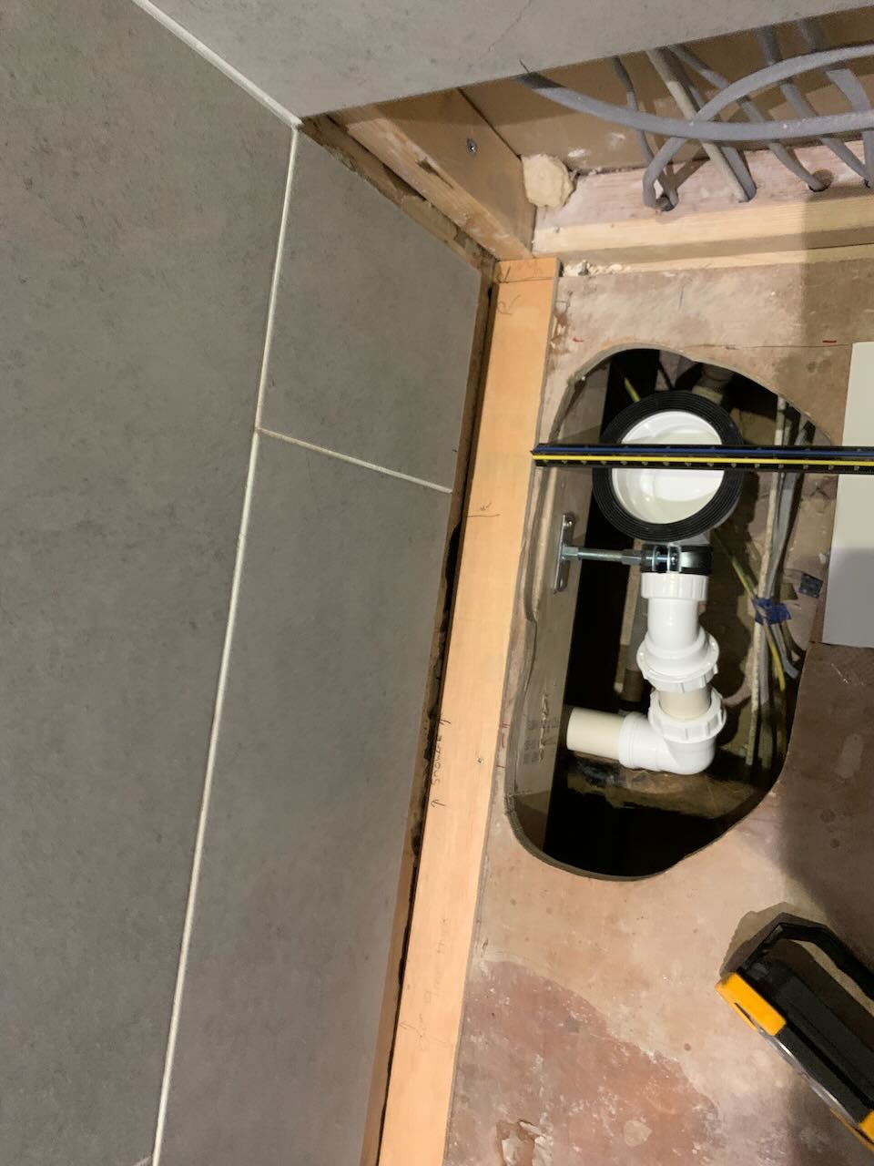

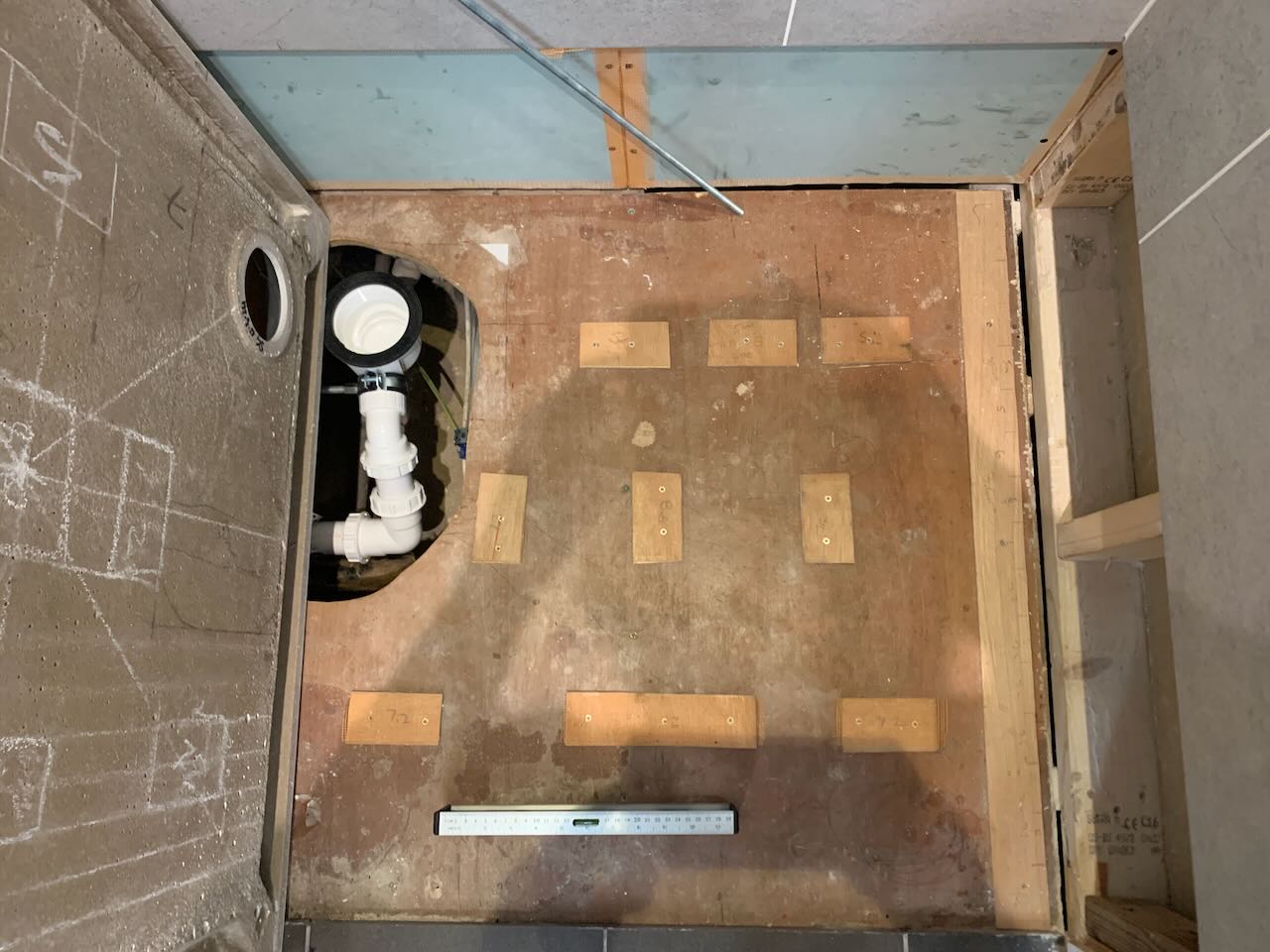

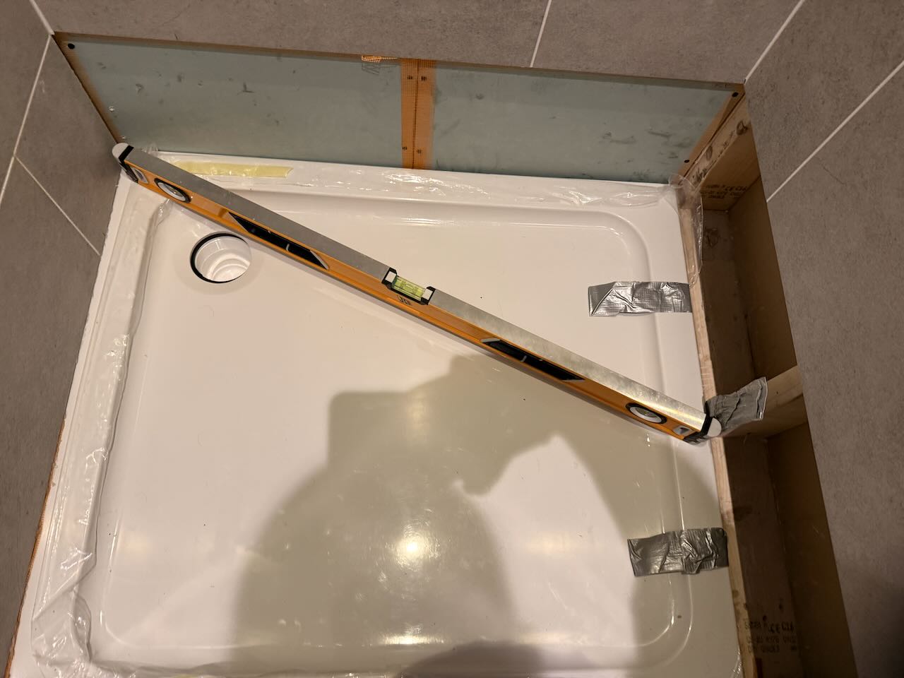

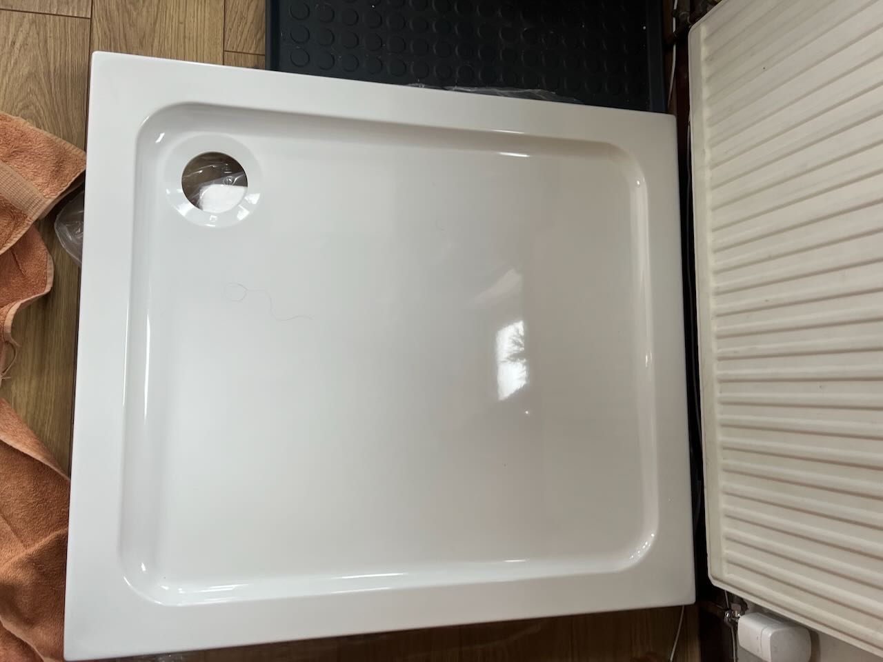

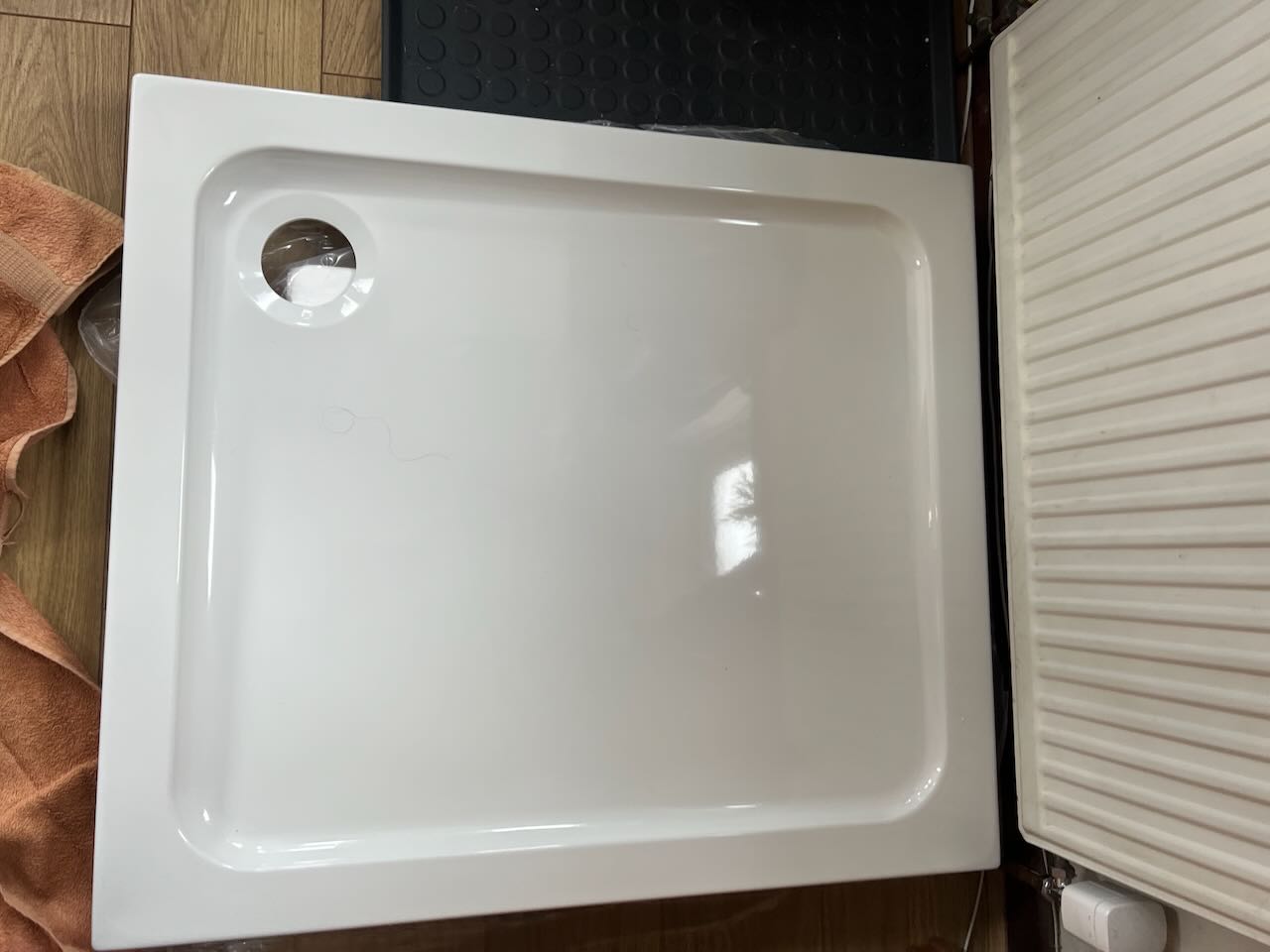

After over a year ive finally got around to "doing" this. Ive installed a trap & pipe to the waste and that seems to be working without leaking and it the correct position to screw down on to.

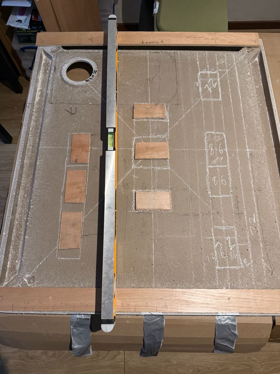

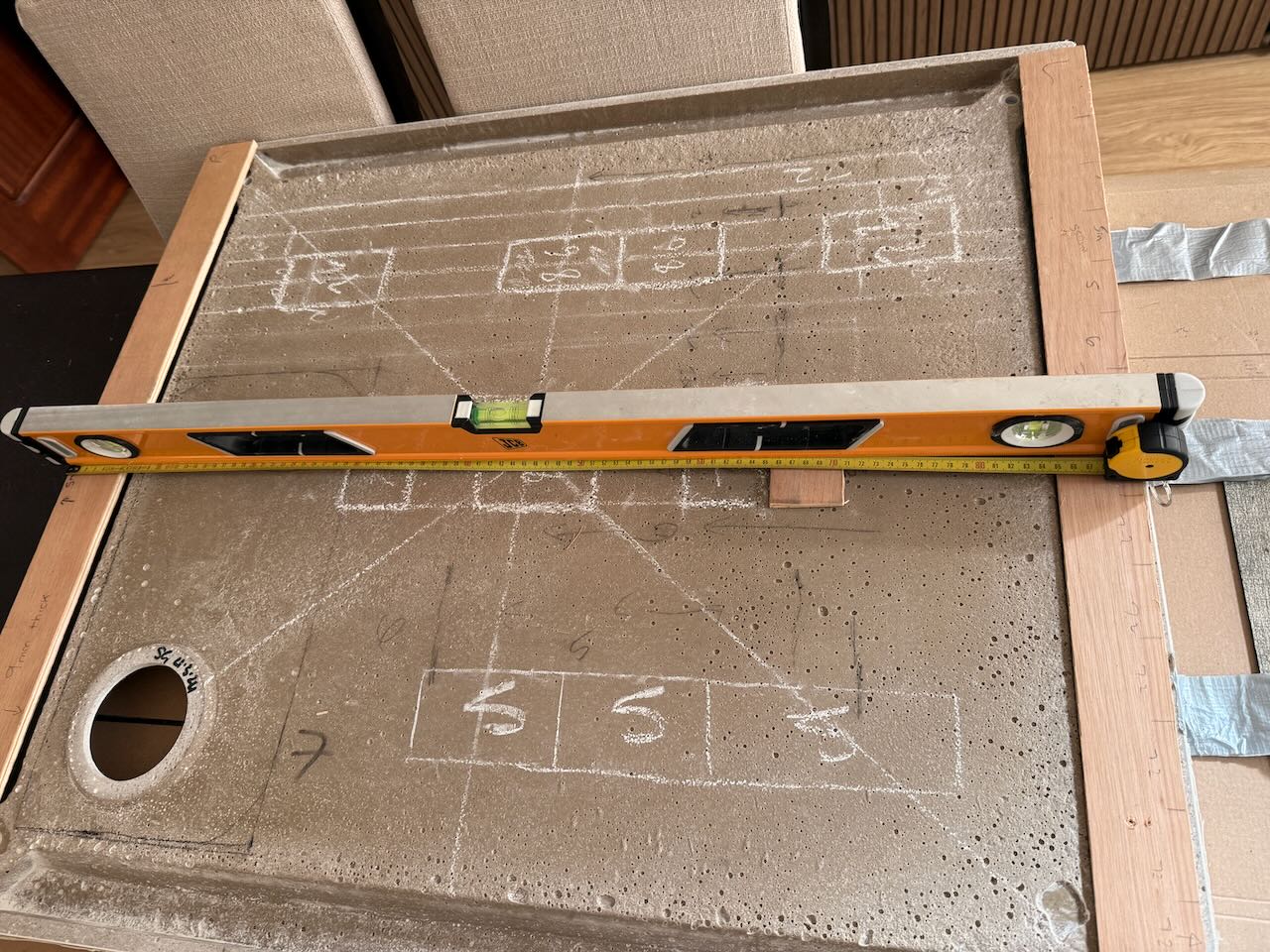

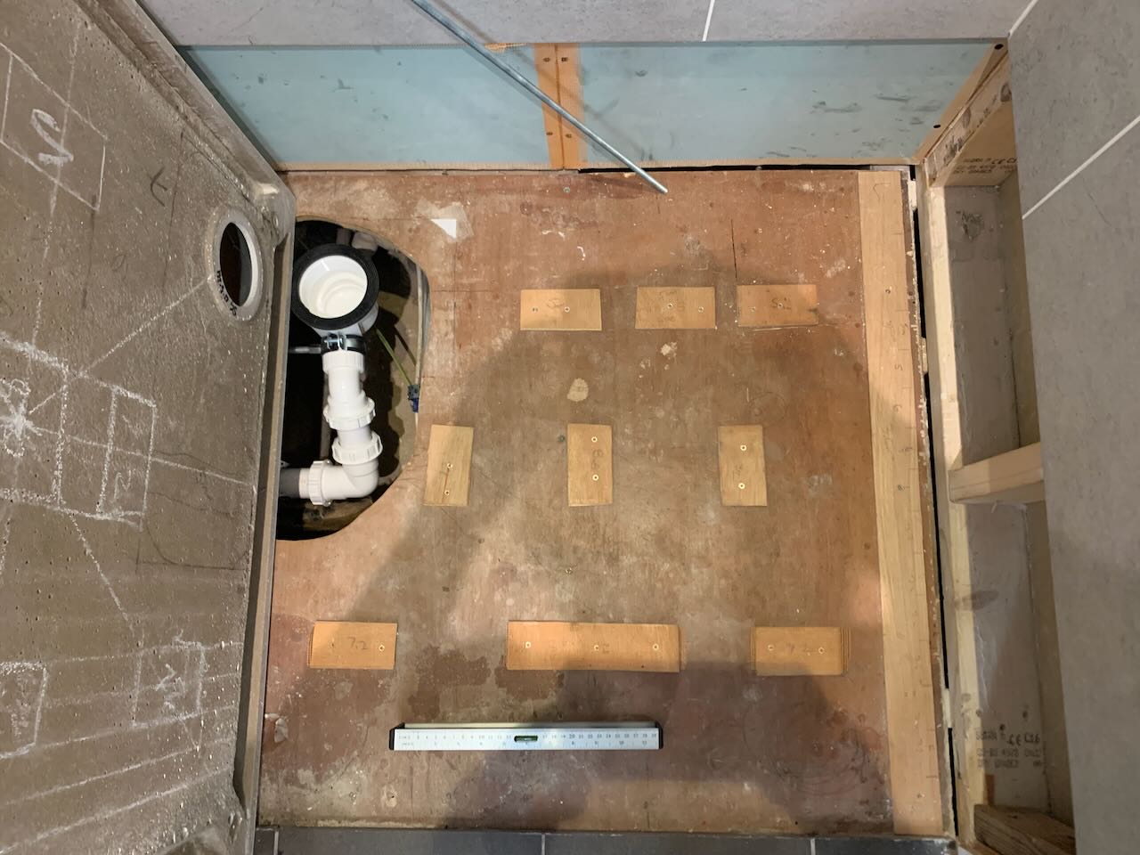

The issue is the bottom of the con concrete shower (900 x 800) is not even. Ive raised the trap side by 9mm hardwood plywood (sealed) so it sits 2-3mm away from tiles for silicone. The other side is raised with 3.6mm hardwood plywood (sealed). And it is level with these additions.

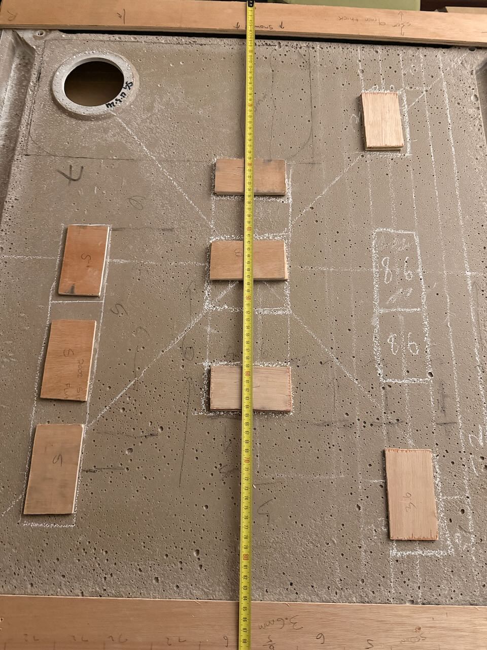

How do I support the un-even bottom of the so it doesnt crack after 100-1000's of showers of the coming years.
After putting the tray on a table and using a level I tried to place blocks of plywood to support the main areas but it didn't sit level in one corner. I don't want to trial and error any more - ive spent a lot of time and I am about to call someone to do it but i'd prefer the satisfaction of doing it all myself.
I know you can use self levelling compound etc - which I brought have yet to open. But if the bottom of the shower is not even wont that cause it to sit even anyway if placed after drying?
Or frame the hole and non tiled side and use some premixed cement to the level on each side and lay the shower down before it dries?
What is the best way do to it? I cannot raise the shower as my mom will be the primary user so it cant have a step.

Some but not all stone resin trays are lower in the centre section than they are at the sides - It escapes me why they do that for exactly the reasons you are describing. I presume the tray manufacturer has asked you to use sand and cement to bed it into?
You have done well using packers of Ply to take up the gap. As long as you support the tray over most of it's area then you are doing the best you can, just ensure that all the raised areas are securely fixed down to the sub floor when the tray is set down so there isn't any flexing, then that's really as much as is achievable
The only thing I would say is that you have left quite a gap around the waste section and it may be prudent to infill some of that with ply to the areas around the waste is more supported. Also is there flex in that clamp @ the trap? Usually when the tray is set down and you then fit the top threaded waste fitting, the trap and seal is usually pulled up and tight onto the bottom of the tray to provide the seal or is the trap at the right height so it sits on the tray once it's fitted?
Manufacturer : I don't know what the manufacturer recommended, id have to check. Likely sand cement.
Support : I took time doing the ply to avoid cement etc but it's not sitting level with my custom packers and im not wasting more time on that. So thats why I was asking what is a better way. I think I need to frame the area with low frame 3.6mm and use cement following the 9mm on one side down to 3.6mm on other then lay the tray into it. Any small excess will sit into the crease around he bottom edge of tray.
Waste section : It was done like that by the previous fitters to allow waste fitting - I think that they had to conform to the shower tray + waste position we brought at the time. Im guessing as long as the sides and rest of the tray is fully support by a cement base it will be fine as putting full weight wont happen in that area as close to taps mid way up.
Waste Trap : The trap is at the right height and the screws are loose intentionally so there is play to allow for fitting. The brackets are primarily for position.

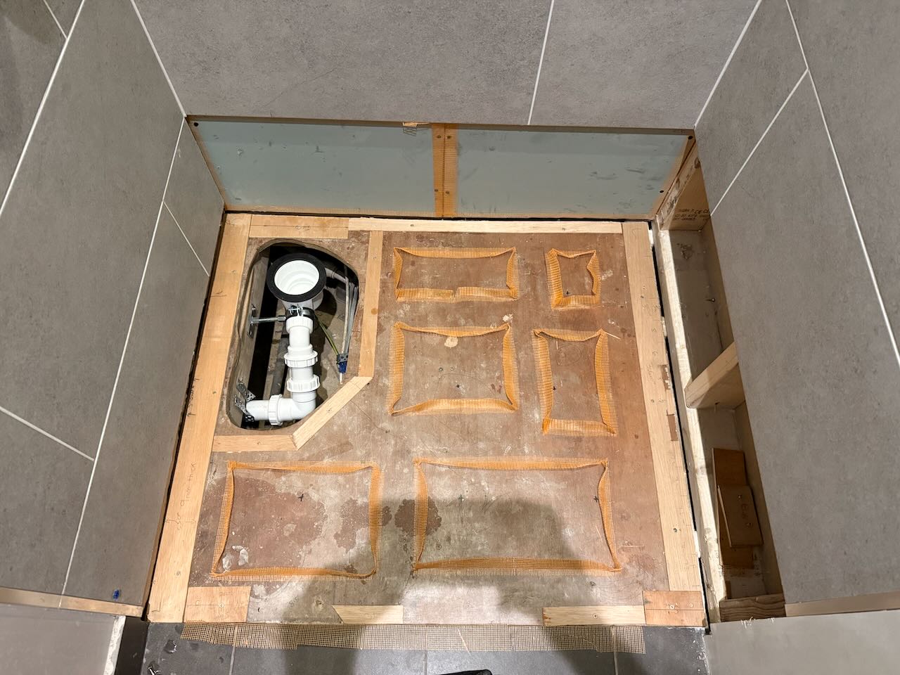

I researched SBR and im using it on the plywood so waterproof (1:4 ratio with water) and I will apply a 1:1 ratio for the bonding.

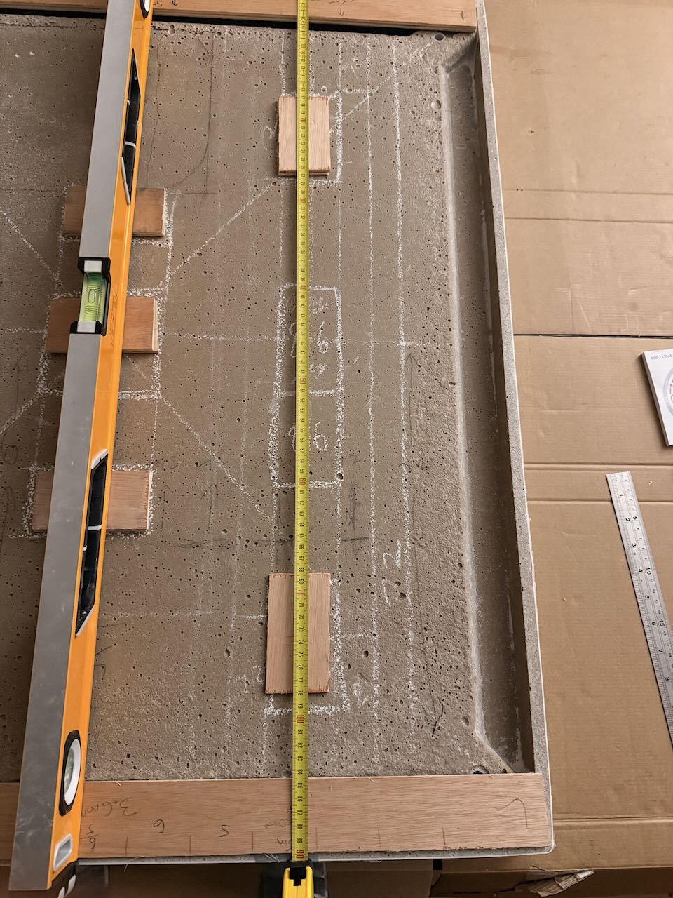

The question I have is as the underside of the tray is uneven relative to its sides which are level (as you saw with my chalk).... by up to approx 9mm.
So if you look at the photo im thinking of sectioning off the hole and creating other sections using 5mm ply (screwed) which I will also apply SBR too. Within those sections (4?) im thinking to put 10mm depth mortar (with added sbr which helps with flexibility) then lay the tray on top + and level = allowing any excess mortar to spread onto the ply sectioning. Once mortar is dry it will be supporting the majority of the tray where people will stand.
The thicker wood left and right will be supporting the tray directly. So its everything in between supported by mortar. Equiv to legs if the shower was raised.
Make sense? Am I missing anything?

.... I will fill the squares (made from plasterboard fabric tape ) with mortar between 5-10mm high and as I place the shower tray into position these will settle and upon drying will support footfall in those areas. The left and right plywood (treated) will be supporting the tray directly - so those are the fixed levels. The mortar is to provide support in those areas as it's raised slightly.

From a process perspective then no, that's about covered everything.
I just wouldn't be using mortar and I certainly wouldn't be using legs either, just as a reflection to the analogy
What would you use instead of mortar? flexible tile adhesive? I can use that... probably easier to work with right out of tub.
yes - if you are going to use a cementitious adhesive to take up the offset in depths then I would use that if anything. It is a bit of a nightmare though that the tray centre is so far off of level, it really shouldn't be like that.
I chose mortar because it was mentioned here and there, but I'll use ready mixed flexible tile adhesive in those spots - easier for me. I'll adjust them in to slightly smaller equally spread areas.
Ive said this before - but fyi, Ive raised it 9mm on left and 3.6mm on right because the wood floor isn't level + I want the existing tiled left side to be close to the tray so after sliding the tray under I can just silicone. But the tray bottom is also not level hence this need to support different levels in the centre. The previous fitting also had wood on the left side and they put some expanding foam to support :confused:
Using tile adhesive means I dont need layer of SBR 1:1. I can just put blobs straight into squares. But don't even need squares really - just trying to get a roughly even spread without covering the whole area.
