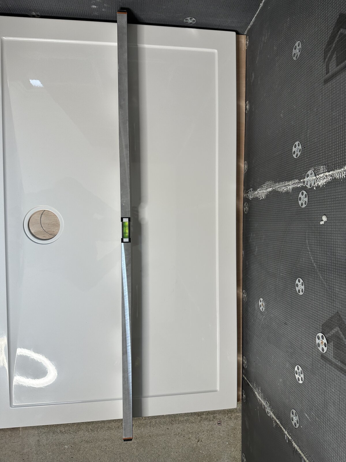

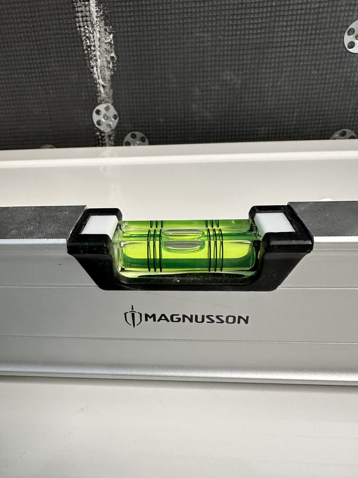

I’ve recently purchased a shower tray, and I noticed that the middle is slightly raised when I check it with a spirit level. Are the edges of a shower tray supposed to be completely flat, or is this normal? Should I be concerned about this affecting installation or water drainage?

Sides should be level and inside fall to the drain point ,
I’ve checked the sides and it’s not level - though I’m sure this is the floor rather than the tray so planning on padding it on one side with adhesive when I lay it down.

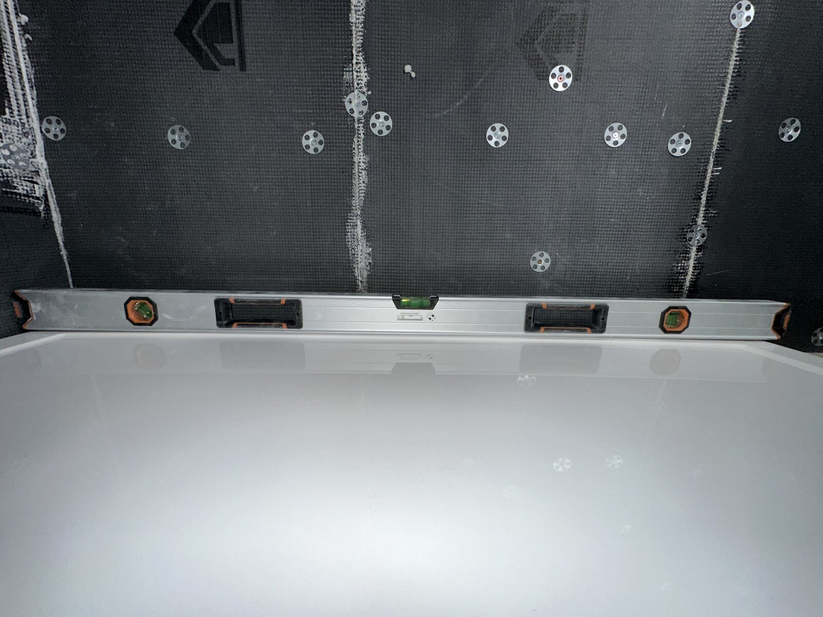

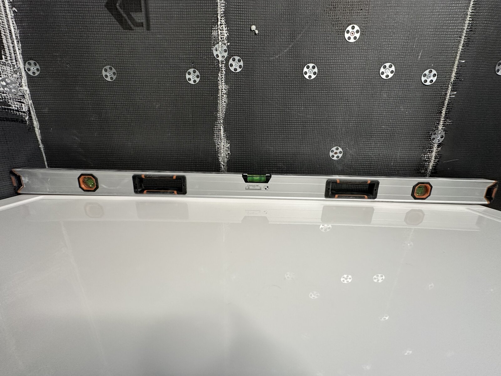

Was just unsure about the middle edges being raised.

The sides of a shower tray should not be bowed, higher or lower in the middle than at the sides, that's a poor moulding and something I would not accept.
I agree - I’ll be speaking to the company I bought this from.
