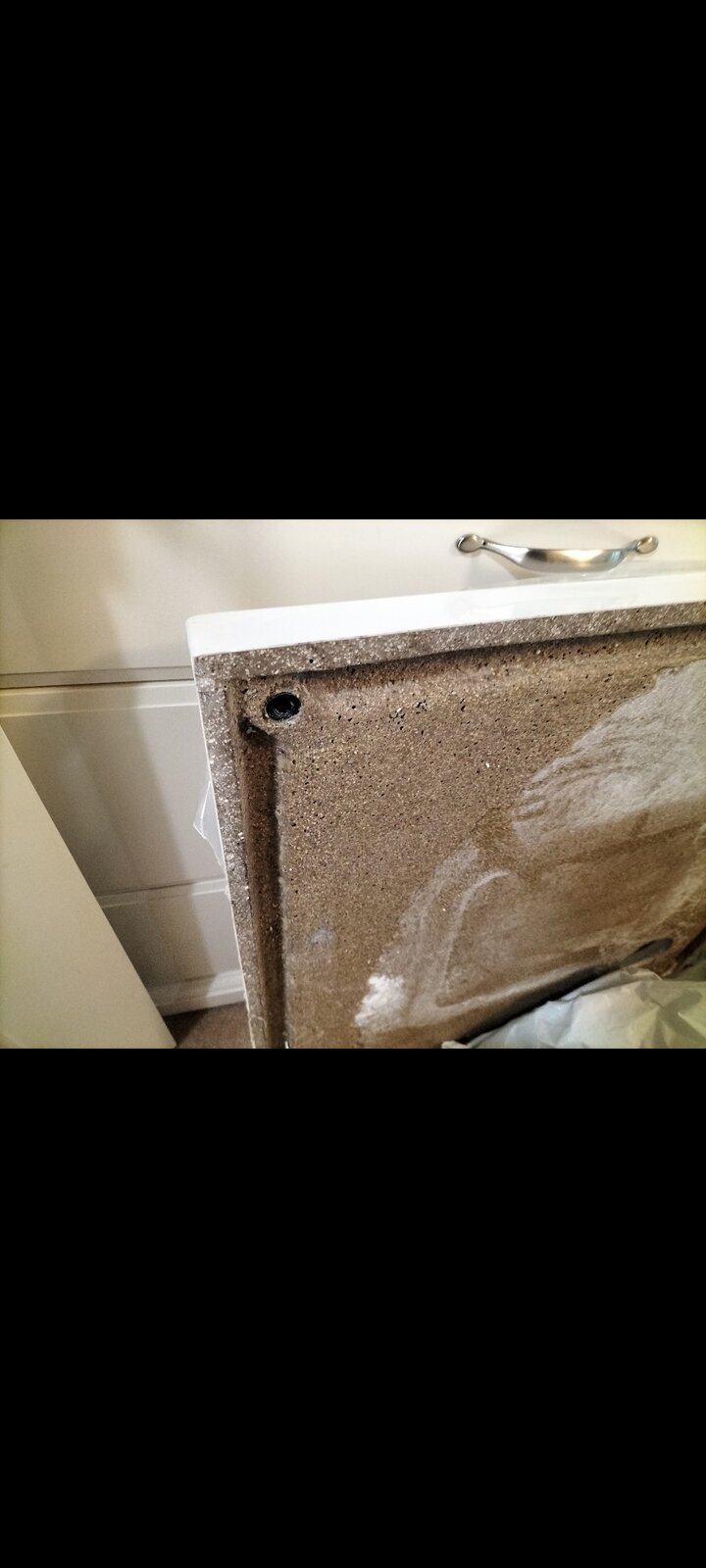

Can you put them on a plythn and sand and cement if they have holes in for threaded bar like this

Not an issue ... stone resin with a nice flat base ... I wouldn't even use sand and cement. A good strong base then a good strong adhesive would work fine.
Some only use S&C, some use a flexi tile adhesive, I've used a good strong silicone adhesive when suitable without issue - depends on the warranty too and if that's to be maintained.

Not an issue as the hole for the threaded bolts doesn't effect the soundness of the tray..
