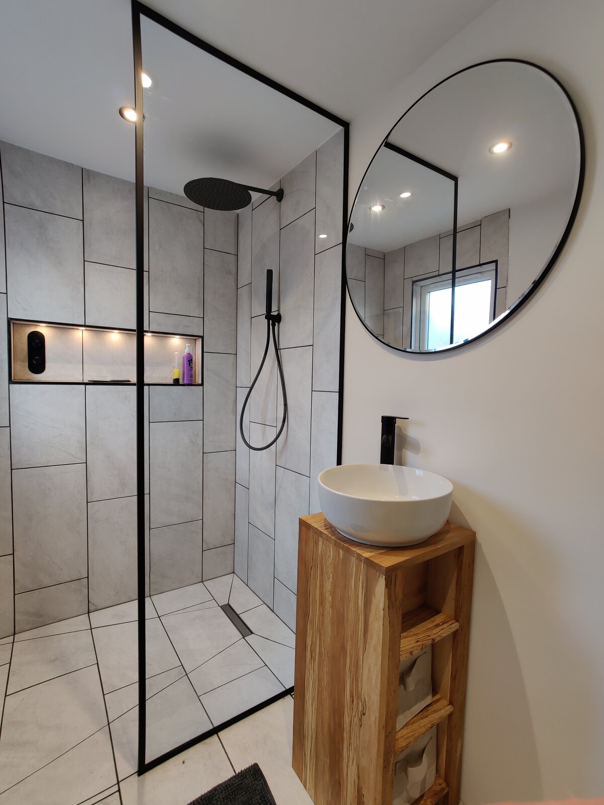

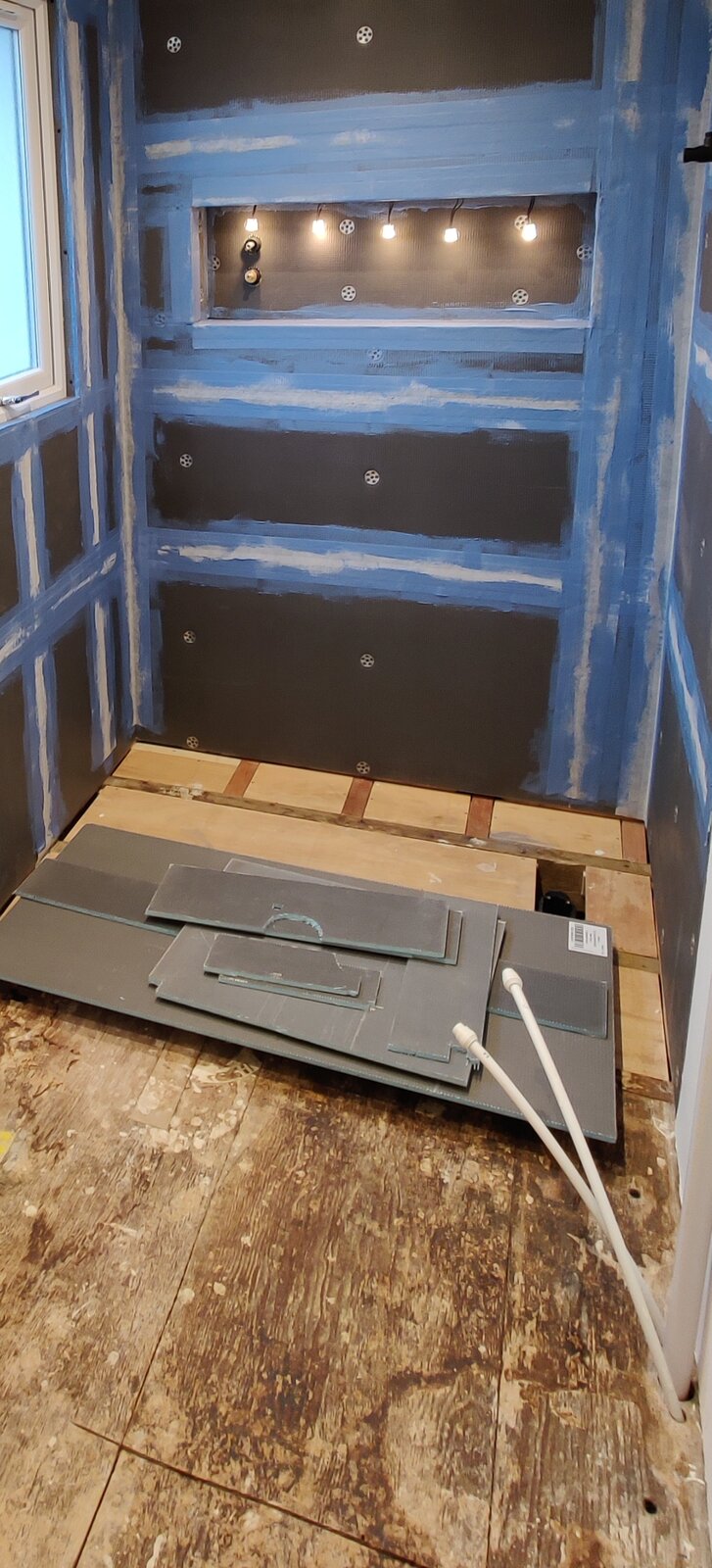

Can recommend the Abacus preformed ones, though they're pricey and you end up with buckets of the blue tanking stuff. Put two in ours now, about to do a third, I've used their panels for the walls too and it fastens dead easy. Tiling over the former is tricky if you've got bigger stuff, just need to make sure the tray is really level before you tile because there's only a few degrees in it. Downstairs shower room (pic) only 1360 wide, but the other plus is you can cut them to size, so this is a 1400 trimmed. Cuts really easy with a multitool.

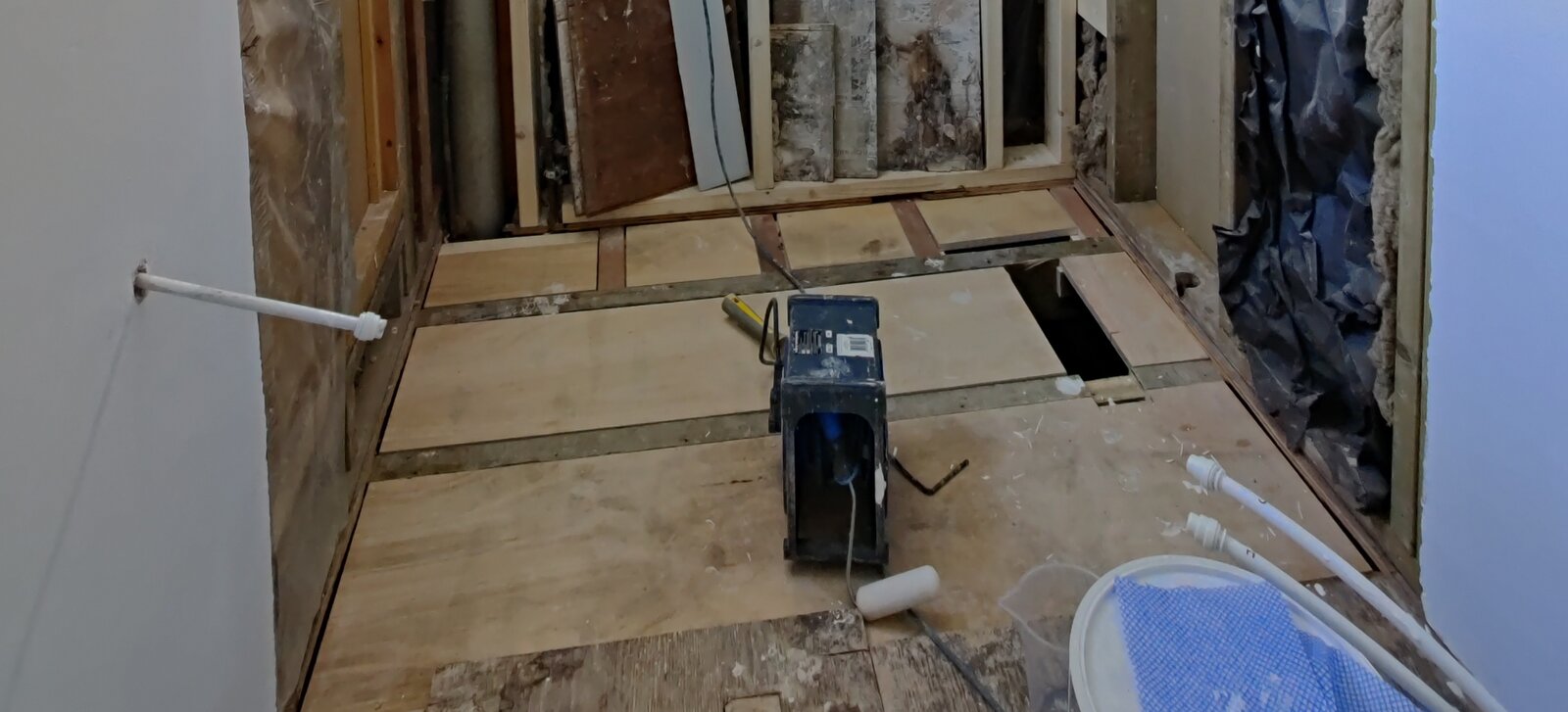

Am i right in thinking to give the level access "wet room" finish the tray former sits flush on the joists (with ply infills between the joists). You then ply 22mm around the former where not adjoining walls. De-bonding layer on top of the ply then brings the floor level with the tray former ready for tiles?
Do you need the wall panels or can it abut tile backer board? 1 of the walls it will join is a plastered wall so i will just tank that but the end wall is a new stud partition so i need some form of board on that.
Some systems specify a rabbit in the shower tray for the wall boards to sit in and create a mechanical joint, some just allow butt joints with a dedicated tape and sealer, others both.
Take time to get the boards flat, level and square and it will making tiling much easier.

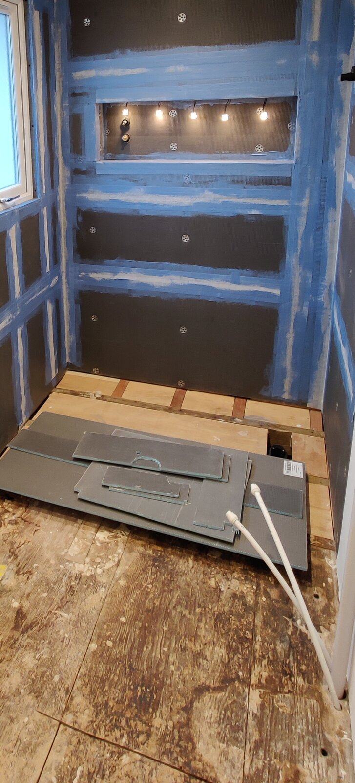

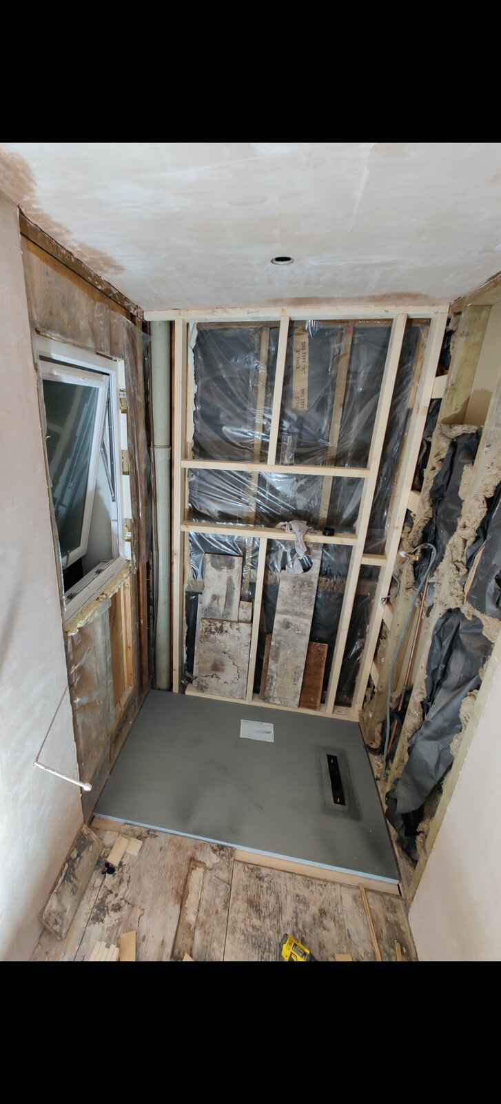

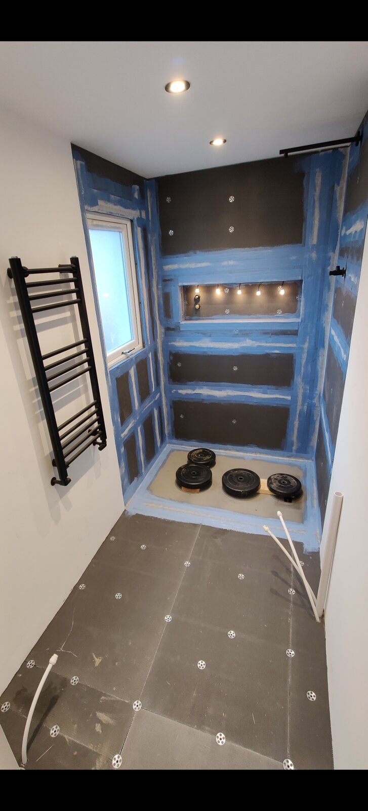

That's exactly it - I'll attach a few build pics. We've got the Abacus boards on the walls downstairs but the former with abacus on the floor (walk in shower) and then hardi on the walls upstairs.

Perfect thanks. Good to know i can use the tray former with ply and normal tile backer board and it doesn't need to all be from the same system.
I think my mind is now made up
In the above, we have 18mm ply on the floor, I think the former was 30mm deep, so 18 ply + 12 abacus board on the floor meant a level floor.
Spot on. Do you board the walls then push the former against or board down onto the tray? Is one method better than the other?
is the one to watch. Did it the same way and have had no problems.
