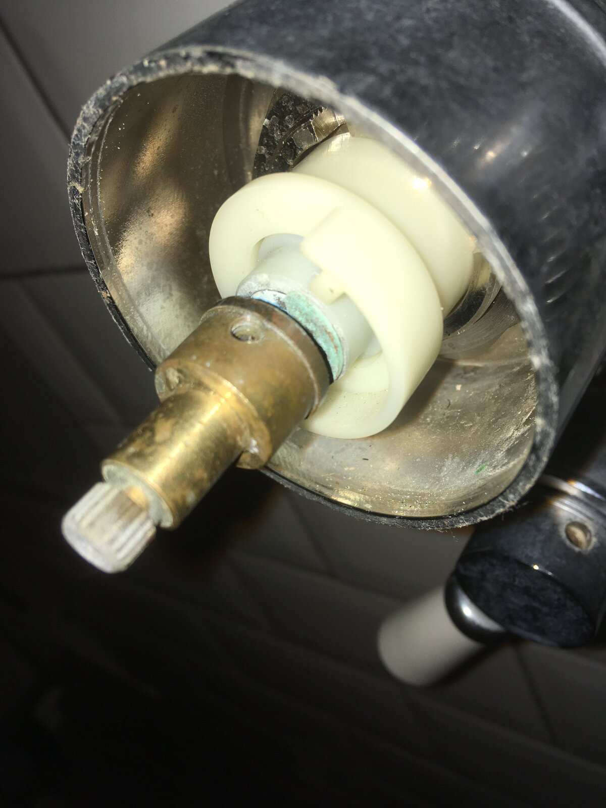

Hi there!
I hope u can help! The hot water in my shower keeps cutting out going not and cold. All other taps on the house are fine. I was advised to clean the mixer cartridge/ valves in the shower mixer. I have taken off the first few bits but I can not remove the bit in the picture, the copper part. There is a small screw on the top I have removed but it moves forward but then it sticks. I don’t want to pull it to hard. Any idea how to get it off?
I really appreciate your help!
Try a kettle of boiling water and/or limescale remover on it all.
Everything on that spindle needs to be removed (including the chrome shroud) and this will reveal the outer circumference of the thermo cartridge, it will be brass with "flats" on it that require a spanner/wrench to undo (anticlockwise) till it can be removed.
You're fighting limescale thread sealant here and sometimes, it's such a battle that the thermo comes out in bits, which is why a standby replacement should be to hand.

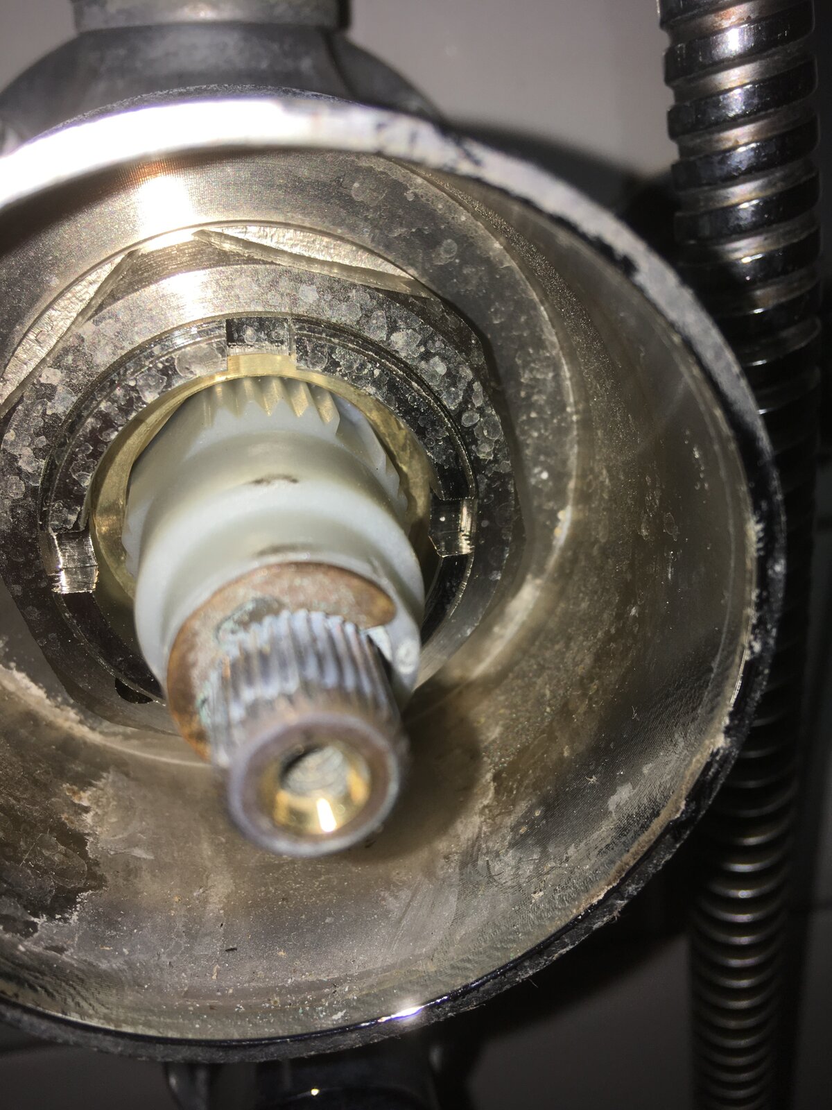

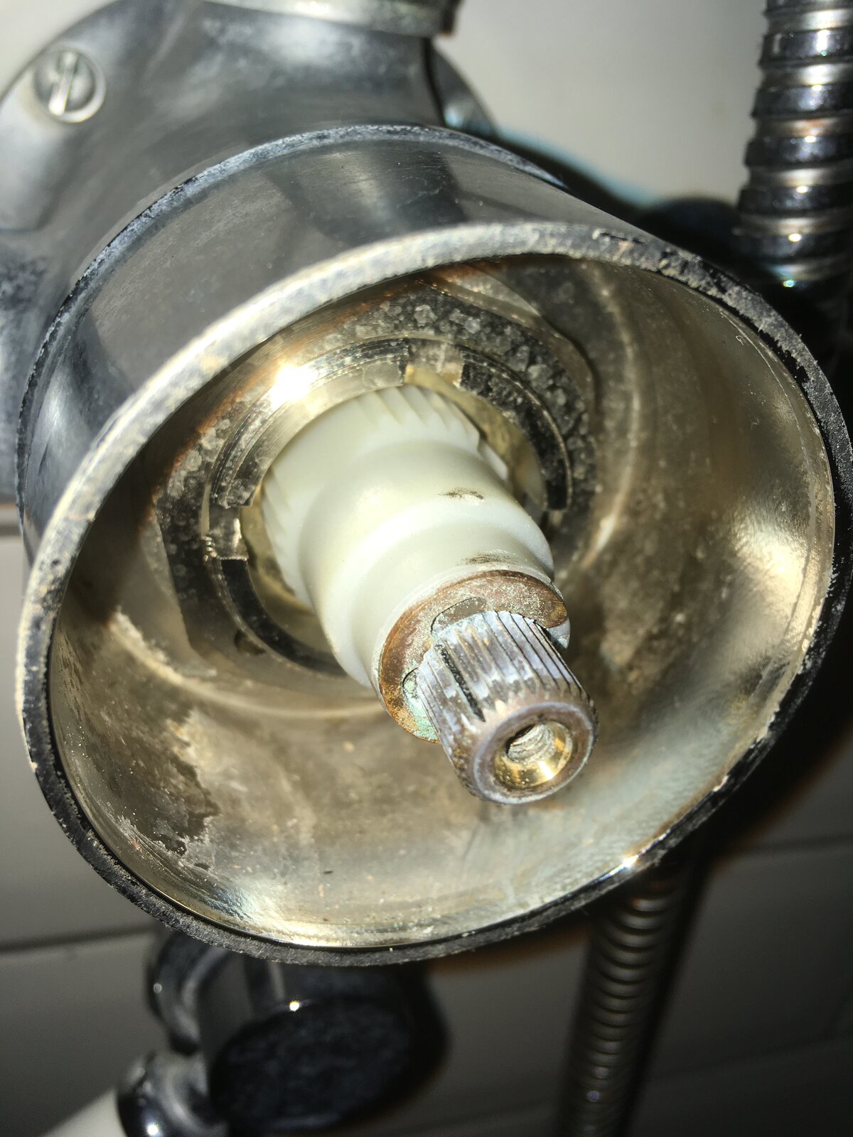

Thanks for the advice! I have got it out! I now need to get what looks like the cartridge. It’s in a plastic case and the manual says I need to pull it out but it’s not moving and hard to get a grip on. It doesn’t look like you need to unscrew or use a spanner as there is no room for you to get one in..... any more advise please! I have attached a photo

Looks like that shroud still needs to come off. Then it's elbow power... Did you get descaler on it? Doesn't look like it!
Hi
I got the first metal piece off from the first picture. But for this bit the manual says it’s all one piece so needs to come out together... I can’t get any descaler for a few days and it seems it’s may be a case of elbow grease! It’s frustrating as it looks like another piece should come of first but there is no way to get it off!

Soak it in citric acid, which is just lemon juice, or even lemon juice itself. You can get citric acid as a powder from the chemists, to dissolve in water. It dissolve the limescale quickly, which is causing your disassembly problems.
