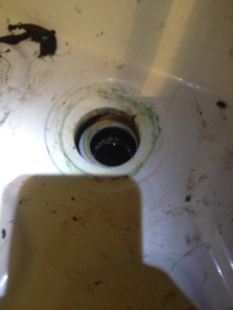

My shower base upstairs has started leaking into the kitchen downstairs. It's part of a 'en-suite' so not our main bathroom so not a major panic but I would like to get it fixed if possible.
To test which part of the shower was leaking I 'circled' the plug with kitchen roll and poured water directly into the plug hole and it leaks. Therefore I know that the leak is somewhere along the waste pipe. It is leaking down behind the wall and under the skirting and coming out on the kitchen floor.
The position of the leak seems to indicate that it is leaking nearer the plug rather than towards the end of the waste pipe.
Here are some pics of the shower base:
I just wondered (probably hoping against hope!) if there was a way of potentially sorting this issue without removing tiles and getting underneath the shower base?
I'm not a plumber by any stretch but I'm a competent DIY'er and so just wanted some advice on how the guys / gals in the trade (or with more experience) would go about this job?

Pull off the grid in the centre of the waste outlet.
You will now see four indents on the perimeter of the outlet.
Unscrew the centre and remove using these slots, check the rubber
washer under the base of the tray, you will probably find that water is getting
past this.
Clean up the washer or replace if it is perished, make sure all is clean under the
rim and between the trap flange and the underside of the tray.
Reassemble and make sure all is watertight.
This SHOULD cure your problem. (if no cure the proceed to take down
the ceiling below)

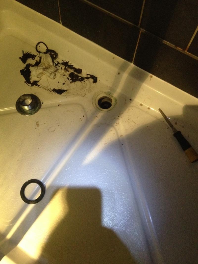

I followed your advice and I'm thinking that you're right.

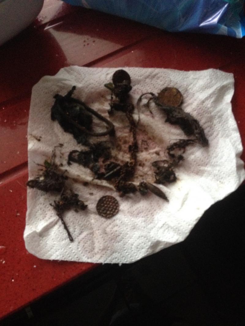

I pulled the waste bit off and found a load of crap in the bottom of the bend.
I managed to get most of that out with the careful use of two forks from the cutlery draw (best not to mention that bit to the wife).

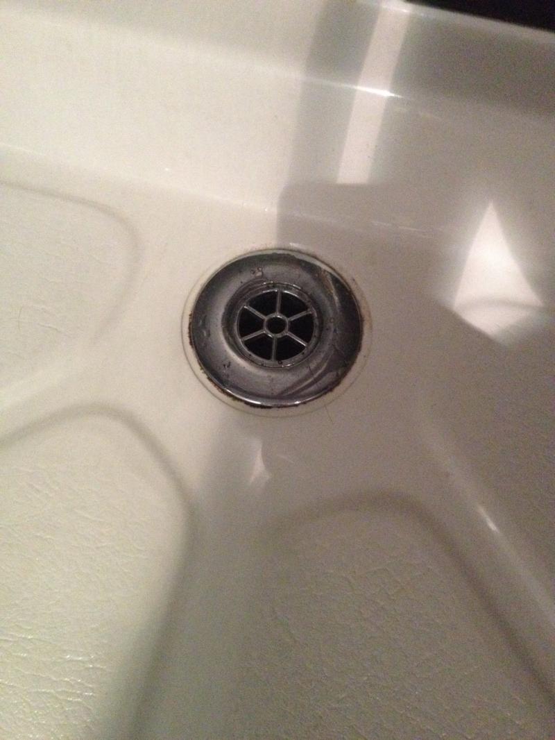

I've cleaned the washer and everything I could get my hands on and put everything back. Just need to 'plunger' the standing water from the pipe (must be other things blocking it) and then hopefully it will be sorted.
Here's a few pics to hopefully help someone else in this situation (and to refresh my brain when it happens again in a years time).
Here's a selection of the trinkets I pulled out of the bend. My daughter and her fella were staying with us recently and used that room. She must have been feeding the bloody thing!
A massive thank you once again to Gasop and all the posters who chimed in with brilliant advice.
