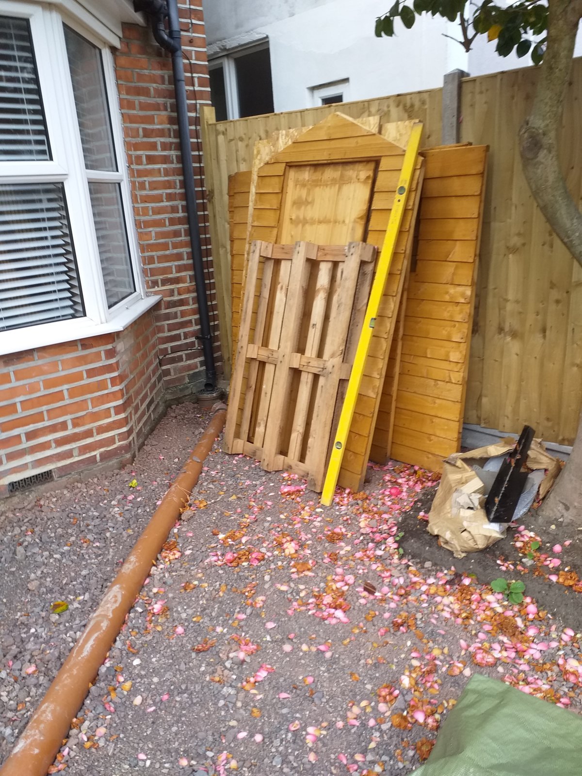

A mate has asked me to put a shed up with him.
1/ I heard shuttering is best for sheds if you are serious. How easy is it to make shuttering for 6 feet by 8 feet one? Worth it?
Or just put an inch of dry sand/cement mix on soil then hammer slabs down?
Or wakerplate hardcore down then cement in slabs on top. But I heard dot and dab after a fee years makes the slabs rock.
What's the best way?

Would I need a cement mixer or just mix it on wood or in Barrow? Just lay it on the soil
a mixer can be hired, will be a lot quicker and less effort, and likely a better mix.
For an 8x6 shed I wouldn't bother with cement at all. A bit of mot wacked down, layer of sand to level, then slabs. It'll outlast the shed and the materials will be easy to remove/recycle at some later date if required.
If the shed has a strong floor, you don't need the slabs, just set it on concrete blocks or wooden bearers (like old sleepers). Ideally sat on some form of damp proofing ie slate or plastic dpc.

The shed is in the pics and it's going in the corner in the picture. There's already those pebbles all over garden as you can see. We thought we'd wacketplatte the corner area then lay wet cement down and then slabs on top. He's got those plastic grate things as well (in pix) sound ok?
