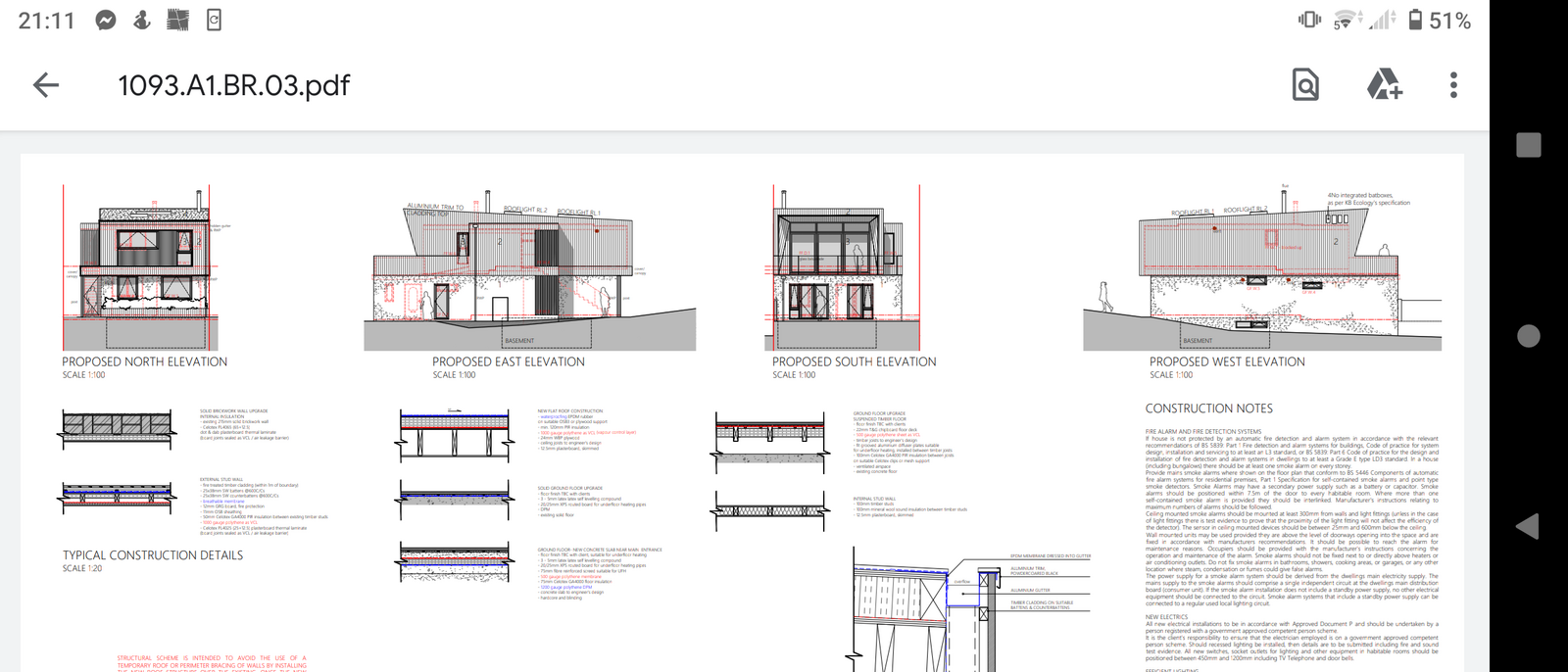

I am labour only, I have yet to ask what fixings they are supplying. I'll show you the drawings shortly. It's quite complicated, it's a big finish with larch and it has to be bang on, I can give that finish because I am anal, but it comes with a price, hold on....
I'm looking at charging £3.5 to £4k to clad this building as per drawings. It isn't really that straight forward.

Who's fixing the support battens? What are the corner and reveal details?
What are the opening head flashing, cill flashing, top and bottom vent products?
The spec for cuts or full lengths?
Treating the reverse of the cladding and end grain? Are knots acceptable?
All rhetorical, but will affect the fitting time.

sounds like you are thinking of 3 or 4 weeks work?
you might be a bit light on time, it’s all off scaffold + as Woody says its all in the detailing.
if it’s got to be covered open housewrap and battened - thats a good weeks work just there.
it’s vertical, so will need counter battening.
I guarantee client / architect won’t have though about all the detailing.
are windows in before or after - are you doing reveals etc?

I am literally just putting the cladding on, but I am not dismissive of the work involved in putting the cladding on, I am very very anal.
The Builders are doing the OSB, then GRG, then Vapour, the double baton of 38x50mm batons all ready for my arrival "if I get it".
I doubt the windows will be in though, yes will need reveals, trims etc, I know it is very involved which is why I am discussing it with the learned people of here.
It helps to talk things through, I'm thinking three weeks start to finish.
