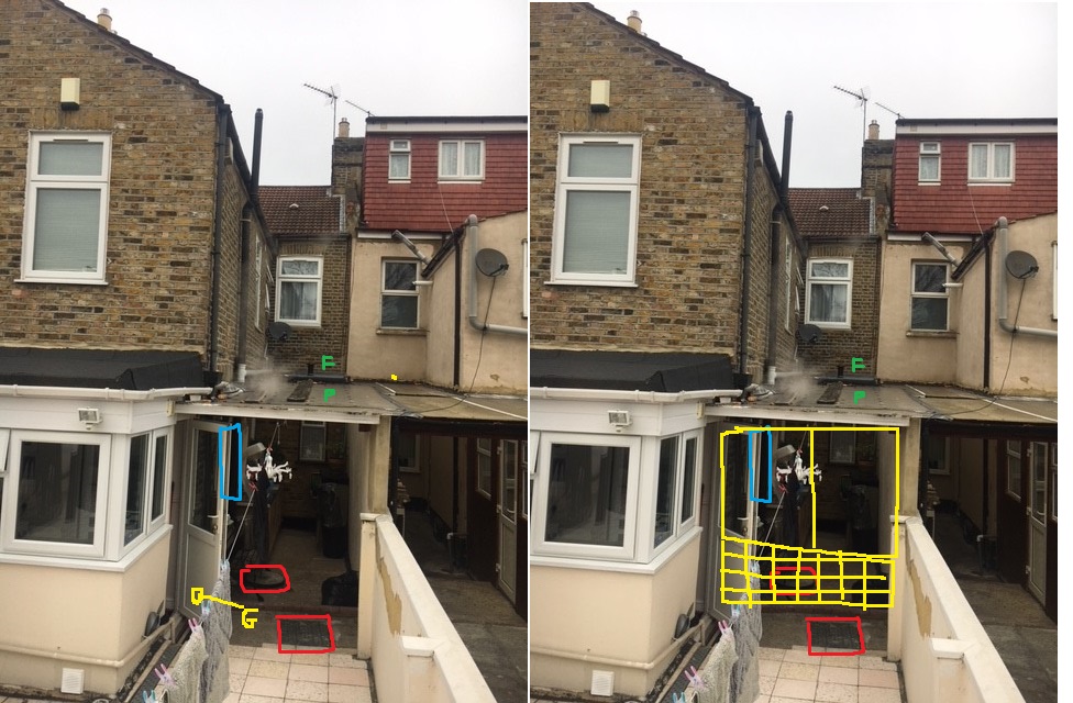

i wanted some advice as im keen to do a side extension......
PIC ON LEFT:
F = felt flat roof - its a shower room at the back of the through lounge
P = plastic roof set on long timber lengths pinned across and down
Blue shape = my kitchen window / which i want to turn into an open door to enter the proposed side extension
G = Open drain (just behind the door thats open. so you cant actually see it. but all water goes into there. and theres a little drain guard there.
Red shapes the rectangle one and circular = man holes.
i dont even fully know what these do lol but the lids do open.
but they are there and always have been
PIC ON RIGHT:
see yellow drawing for what i want
basically want to have 2 windows just behind the door and bricks at the bottom.....
all in line with the open drain i.e. so the garden door can still open.
can i still do a side extension based on this layout?
i basically want this to be a utility area but accessible inside from inside the house - instead of having to come out the garden door
so basically you can walk in through the current blue window which can hopefully become a door. it will be for laundry dryer etc
im thinking a felt flat roof across the "new" side extension...at the moment its part felt roof (shower room) and mostly plastic sheet roof as you can see.
a sky window or 2 would be great to let some light in too.
the squared man hole will stay outside.....its the circular one im worried about as that would be inside the proposed side extension....so i may have to use vinyl instead of tiled up floor perhaps
current conservatory is small so just want to do this little side extension.
i dont want to join it up to current house i.e. put a steel beam etc.
i just want to see if its possible to do a separate side extension....that can be accessible through the current window.....
please let me know if you need any further information!
appreciate your advice to know if this is feasible

It appears feasible, the drainage can probably be modified. You might have to upgrade/rebuild the existing party wall/fence and work out the junction between your new flat roof and the party wall/boundary. Look up "side return" extensions for ideas and inspiration.

Probably permitted development so no planning application needed but check to be sure.
Circular manhole covers became more common in the 80's when plastic drainage took over so could well be a later addition. Lift the covers and run water in sinks, shower, toilet etc. (one at a time) and see where it comes out.

If it joins up to that extension on the left, it would need planning permission.

Lift them up and look in them. Could be one for rain water, one for turds. Could be two just for access to different runs on the drain.
