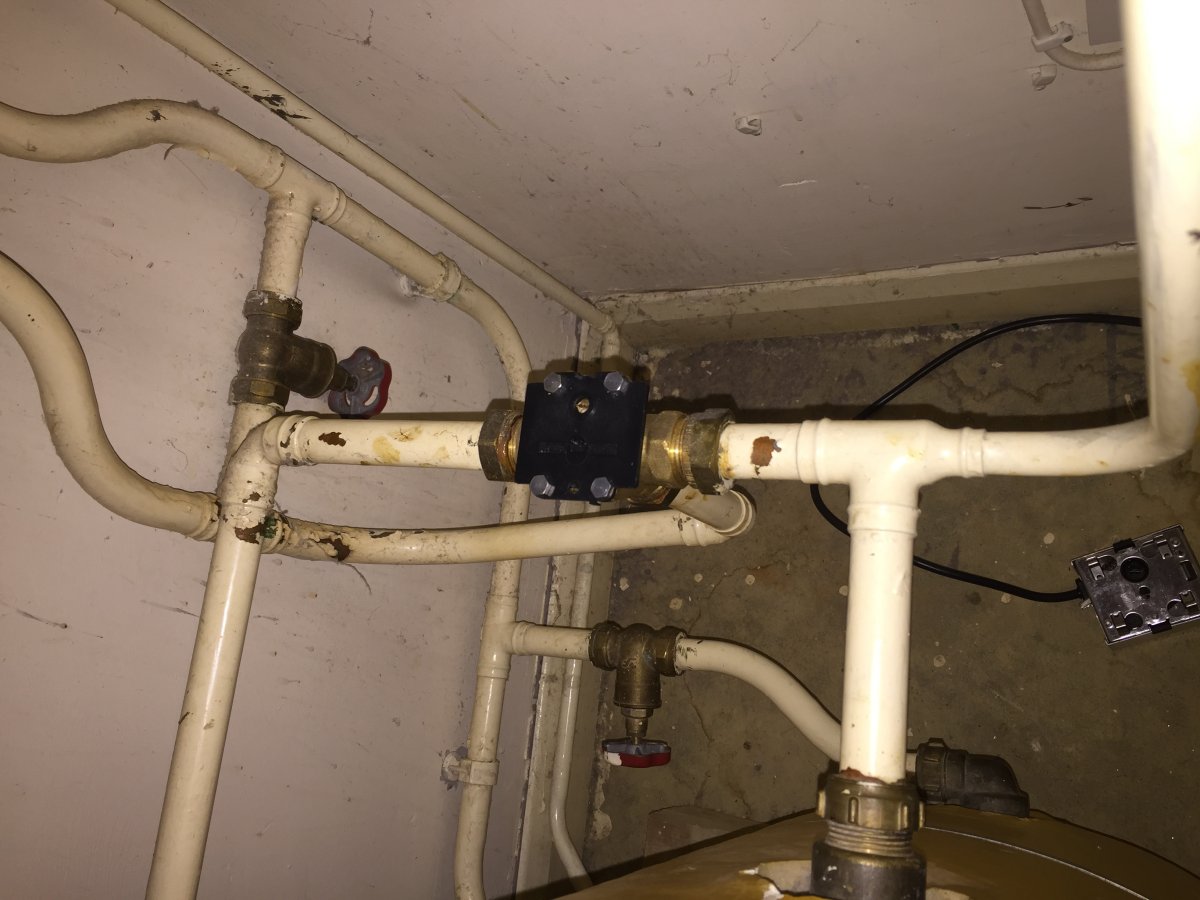

Of course it couldn't have happened in the summer...
No hot water, traced to no hot going into the cylinder heat exchanger.
I suspected that it is being caused a faulty / seized 3-port valve so popped the actuator off and tried to move the spindle by hand which it didn't.
So I tried again with a pair of pliers which was a mistake as even though I wasn't particularly rough, the spindle simply split and the top came off.
The actuator seems to still be working fine (selecting hot water on/off causes it to move approximately 30 degrees).
I have found a replacement body online https://www.heatingcontrolsonline.co.uk/siemens-22mm-3-port-valve-body-only-p-336.html.
Is it necessary to remove the whole valve, or can I just take the 4 bolts on the top out and replace the spindle? Is it necessary to drain the system down?
You'll need to drain down, I'd be inclined to replaced the whole thing, splitting it could cause it to leak. Don't forget to top up the inhibitor once refilled and tested.
Thanks for the fast response.
I've got a bottle of X100 ready and will probably take the opportunity to flush the system a couple of times first. I've also got a bottle of X200 that I have been meaning to try for some time - so may give that a go as well. It was going to be a job for the Spring!
