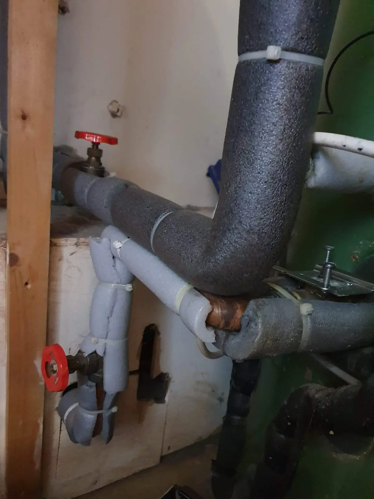

There it is, the valve actuator mounting plate is middle right, both gate valves on the left, out of shot at the top is an Auto Air Valve, also out of shot is piping to the other coil which is for the Thermal Solar heating (long since switched off!)
Normally, when a solar system is decommissioned, the two coils might then be combined (either in parallel or series), the two red gate valves might be the flow&return from the solar coil, so still not sure what is or isnt combined, if the motorized valve is the HW zone valve then the only way that this could work is that only the solar (bottom) coil is now being used, the hot water enters (where the AAV is) via the top gate valve and exits via the bottom one and then the M.valve, still a bit confusing because with two coils then there are 4 connections whether utilised or not, can you clarify this?.
The Solar Thermal has been switched off for about 8 years now, just that, switched off, no other attempts have been made to decommission it, the solar collector is still connected to the tank via it's own separate coil.
The hot water has been OK up until yesterday.
The Boiler Coil is as you see it and it's various valves etc in the picture.
There are 4 coil connections, flow & return for the solar, these are at the bottom. And flow & return for the boiler about 1/3 up.
Plus of course, at the top, cold water input and hot water output.
Are these the two gate valves you are referring to and is the M.valve about 1/2 way between the two and to the right with actuator removed and seems to be on the same pipe as the bottom gate valve??. OR is the water only passing through one of these gate valves and the actuator is somewhere else? or can you just draw it out on a bit of paper showing AAV etc.
Or is it M.valve, gate valve, Coil, gate valve then up to the AAV. If try and get air/water from the AAV thhere is normally a cap on top, also close/open the two gate valves fully, 3 to 5 full turns each to ensure fully open

Gate valve (bottom left)
To Motorised Valve (actuator mounting plate visible middle right)
into coil
out of coil
to T joint (up to AAV, flow towards gate valve)
Gate Valve (middle left)
All assuming that the flow does go GV MV COIL (AAV) GV, I don't know for sure ;)
OK thanks, its clear now, if no compression fittings anywhere then shut the two gate valves and you may be able to slacken/remove the mounting plate with valve and inspect it if it seems OK, flush the coil from both sides to prove clear, if compression fittings at the valves then you can remove and flush both ways to prove valve clear maybe. If you had HW yesterday then definitely points to ball/shoe problem.
