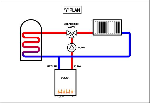

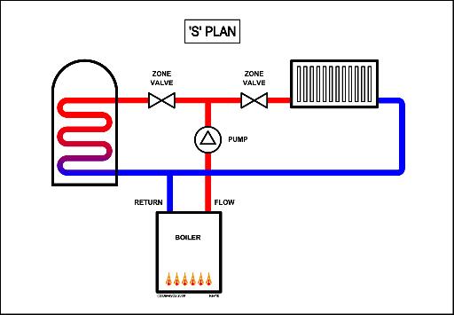

Based on the age you give for the system. I would expect it to have totally separate control of heating and hot water. The telling factor is the presence of motorised valves. Either one 'Mid-Position Valve' like this....
Or two separate 'Zone Valves' like this....
