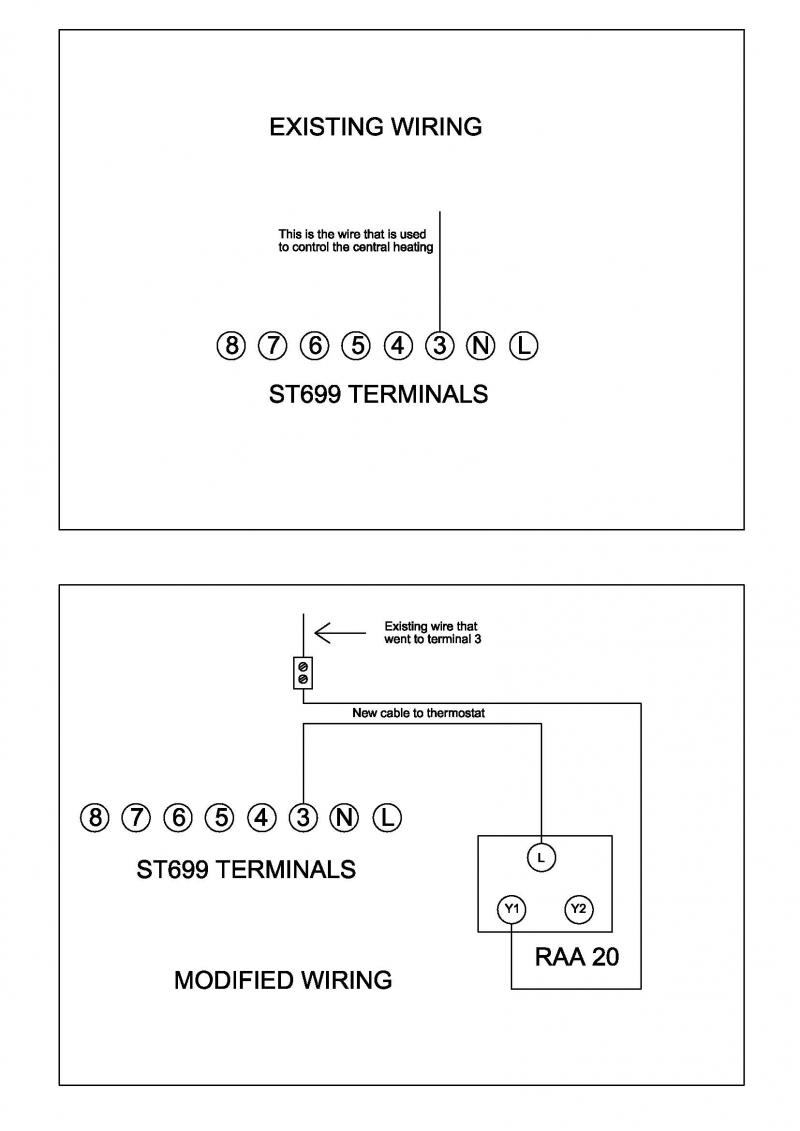

I can see the wire going to the programmer but can not see where the other wire going the writing is not clear, I do appreciate if you could send it again to see if is more clearer.
If you want a full diagram of the Y plan you can find one by clicking here. But you shouldn't need it. To add a new room thermostat, like I said earlier, you only need to move one wire. The others stay as they are.
Please note that the thermostat terminal markings on the Y plan diagram linked above, do not correspond to the model that you have. Use L and Y1 as per my diagram. You do not need the neutral either.
Yes it does, because you are only using two wires (L and Y1) The other terminal is there so the thermostat can be used with a cooling system. but you would still only use two of them.
