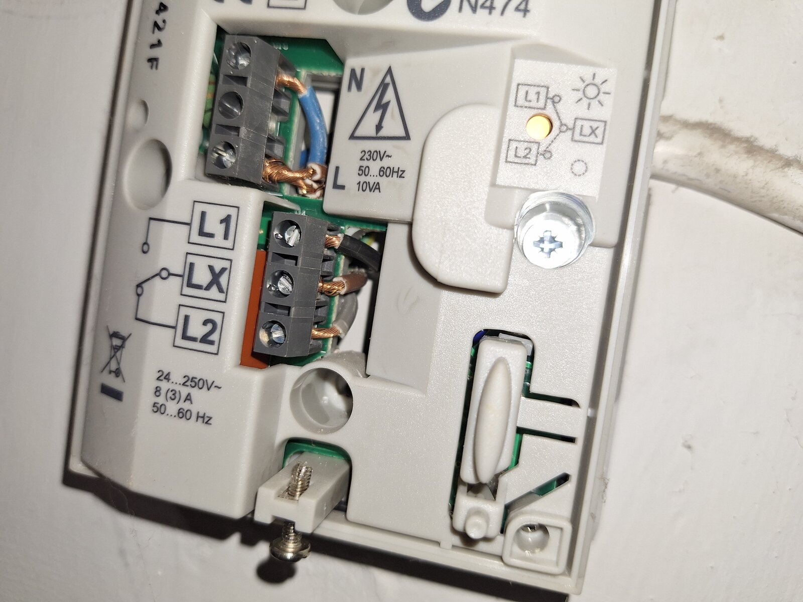

Hi I am currently fitting a hive v3 thermostat but replacing a siemens rcr10 can any one help with wiring the only issue i will have is that the siemens has a wire on l2 and help would be grateful so it has wires in L N L1 LX AND L2 see pic
It's unusual to have the wire on L2. But not a problem with the Hive receiver.
L to L
N to N
LX to 1
L2 to 2
L1 to 3
This is assuming that it is a single channel Hive that you have got.

Looks like the L is joined to Lx, so would possibly need a link on Hive? @richardbirkett what Hive do you have and what boiler?
