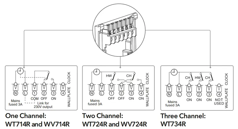

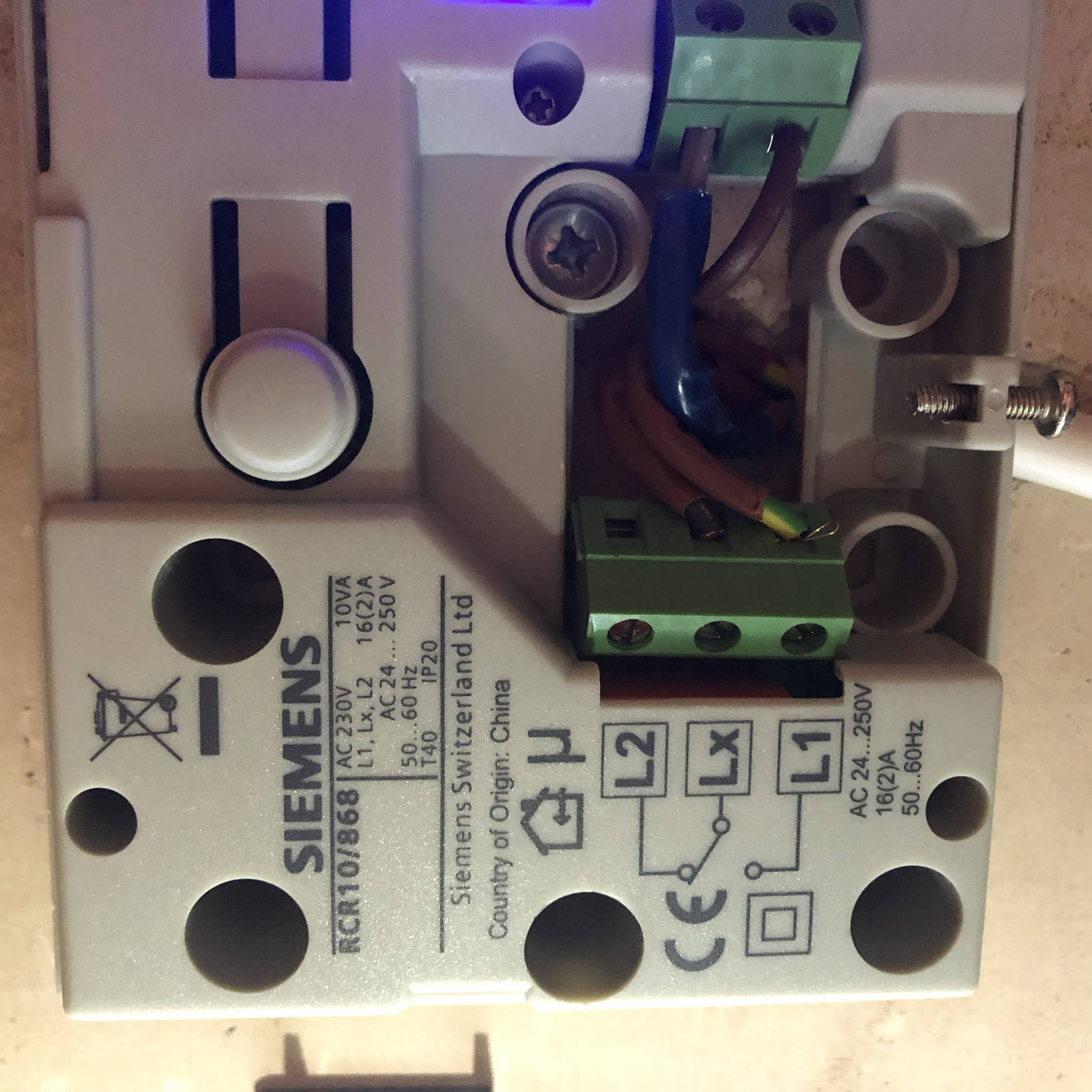

Hi all, Ive recently had a new boiler and timer and controls installed by NEST. All they had to fit is danfoss (FP720) with siemens (REV24RF-RCR10/868) which replaced my 2 channel wiser wireless with an app. I get the wiring to swap my wiser, fine. My question is about the siemans RCR10/868 wiring.
N to N on wiser - L to L on wiser fine
L1 to Heating ON on wiser, fine. LX to ?, theres no common on my wiser
So would it go to HW ON?

Hi, so on my wiser 3 is CH 4 is HW
L1 to Heating ON, on wiser, fine. LX to ?, theres no common on my wiser
Yep as per @jeff the gasman the common is built into the Wiser. I would swap the wires though as they’ve used the green and yellow as a live which is bad practice.
Hi thanks for your help. Just so i get this correct. I need to replace the 4 core wire to 3 core without green/yellow. L to L and N to N and
L1 to C Heating on. nothing to HW (cylinder) as its not a combi?

No need to replace 4 core cable, just terminate the green/yellow in a connector block, and use the other for heating on. Everything else is correct.
