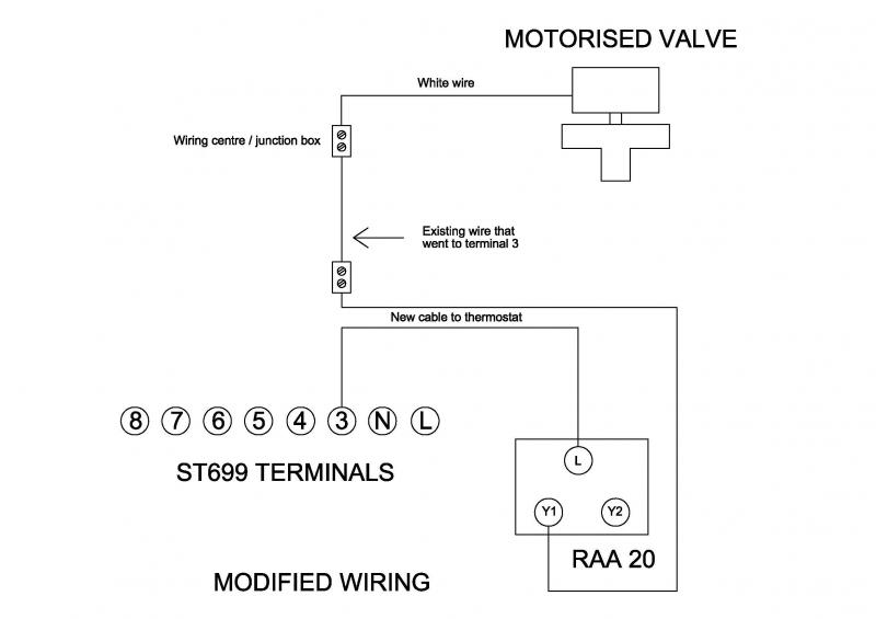

amki1 said:
I can see the wire going to the programmer but can not see where the other wire going the writing is not clear, I do appreciate if you could send it again to see if is more clearer.
As requested here's a drawing showing where it goes, I'm not sure how it will help you though.
If you want a full diagram of the Y plan you can find one by clicking here. But you shouldn't need it. To add a new room thermostat, like I said earlier, you only need to move one wire. The others stay as they are.
Please note that the thermostat terminal markings on the Y plan diagram linked above, do not correspond to the model that you have. Use L and Y1 as per my diagram. You do not need the neutral either.
Hi Stem,
I have connected the roomstat. Although it says two wire roomstat. But it has L , Y1 and Y2! So it doesn't ma,ke sense.

Hi Stem,
I have connected the L to no 3 on the programmer and Y1to the white wire on motorised valve but doesn't work!
Please help!
Although it says two wire roomstat. But it has L , Y1 and Y2! So it doesn't make sense.
Yes it does, because you are only using two wires (L and Y1) The other terminal is there so the thermostat can be used with a cooling system. but you would still only use two of them.

Disconnect the wires from the thermostat and put the wire back to terminal 3 as it was before and tell us what happens. Does it work then?
