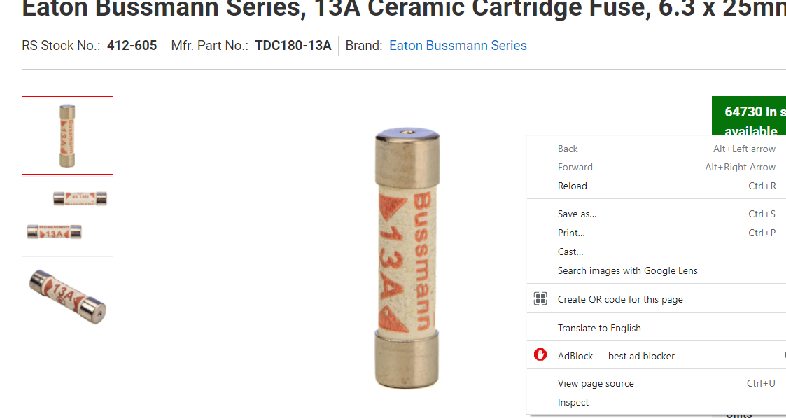

That's what I (and probably nearly everyone else) would have said, but are things like these 'for real', I wonder (no mention of BS1362 that I can see)? ...

I'm sure there are plenty of non-standard fuses that would physically fit in a BS1363 plug. I'm also pretty sure that no sane reputable manufacturer would even consider fitting such a thing,
Indeed - like the 15A and 20A ones :)

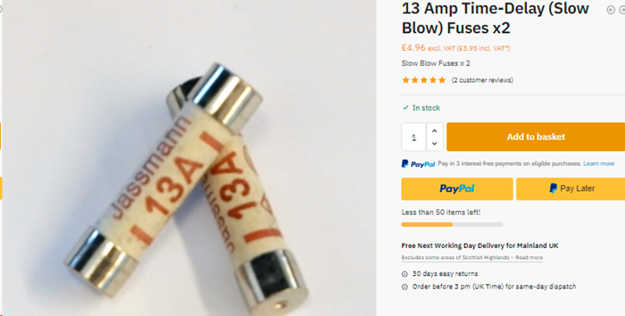

I would hope that is probably true. However, it's perhaps a pity that the Standard does not (well, I presume not!) include slow-blow fuses, since that would sometimes avoid the need to use a fuse of 'otherwise unnecessarily high' rating in situations such as you mentioned (when there are very brief 'inrush' currents).

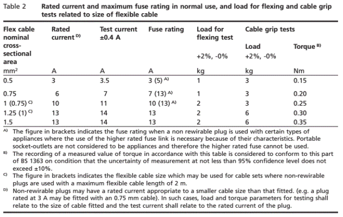

BS1363 implies (though doesn't explicitly state) that a 13A fuse is acceptable for any flex of 0.75mm² or larger....
I'm not sure what you mean by "doesn't explicitly state". Agreed, it does not apply "for any flex of 0.75mm² or larger". However, per Note (c) of the table below, BS1363-1 appears to indicate that 0.75mm² or 1.0mm² flex is allowed with a 13A fuse if it is part of a "cable set with a non-rewirable plug", provided that the cable is no greater than 2m in length....
Kind Regards, John
Either I missed the "normal use" bit in the title of that table and thought it was only for tests, or it changed between editions.
Fair enough. That comes from the 2016 version, which I think is still "current".
