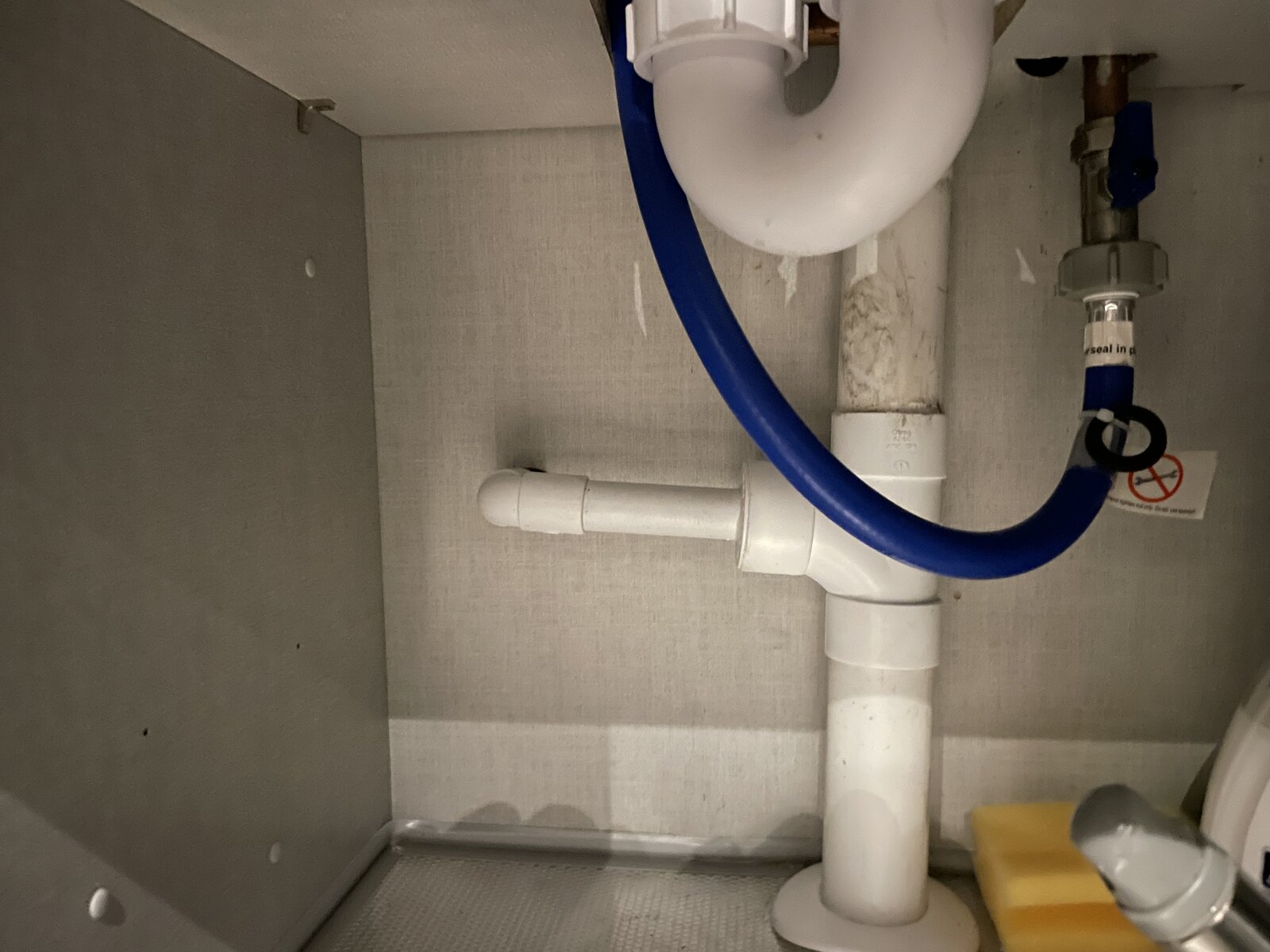

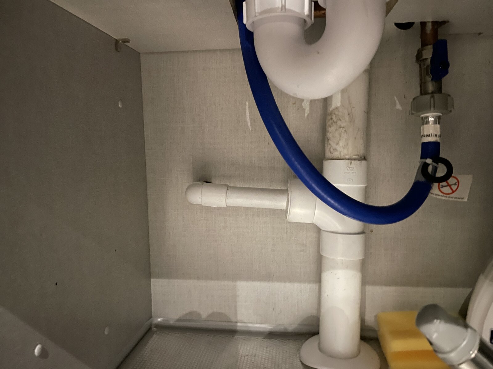

Hi,
When I drain the sink in my kitchen I can hear the boiler bubbling, it's the condensate trap pulling water down the overflow pipe into the drain which goes into the same drain as the sink.
Is this normal?
But it’s after the sink drain trap so gases from the drain can come back up then?
Pic attached

You need to show the rest of the pipes. Where they come from, where they go to, how they are connected

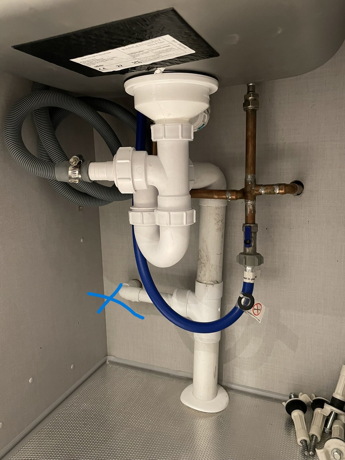

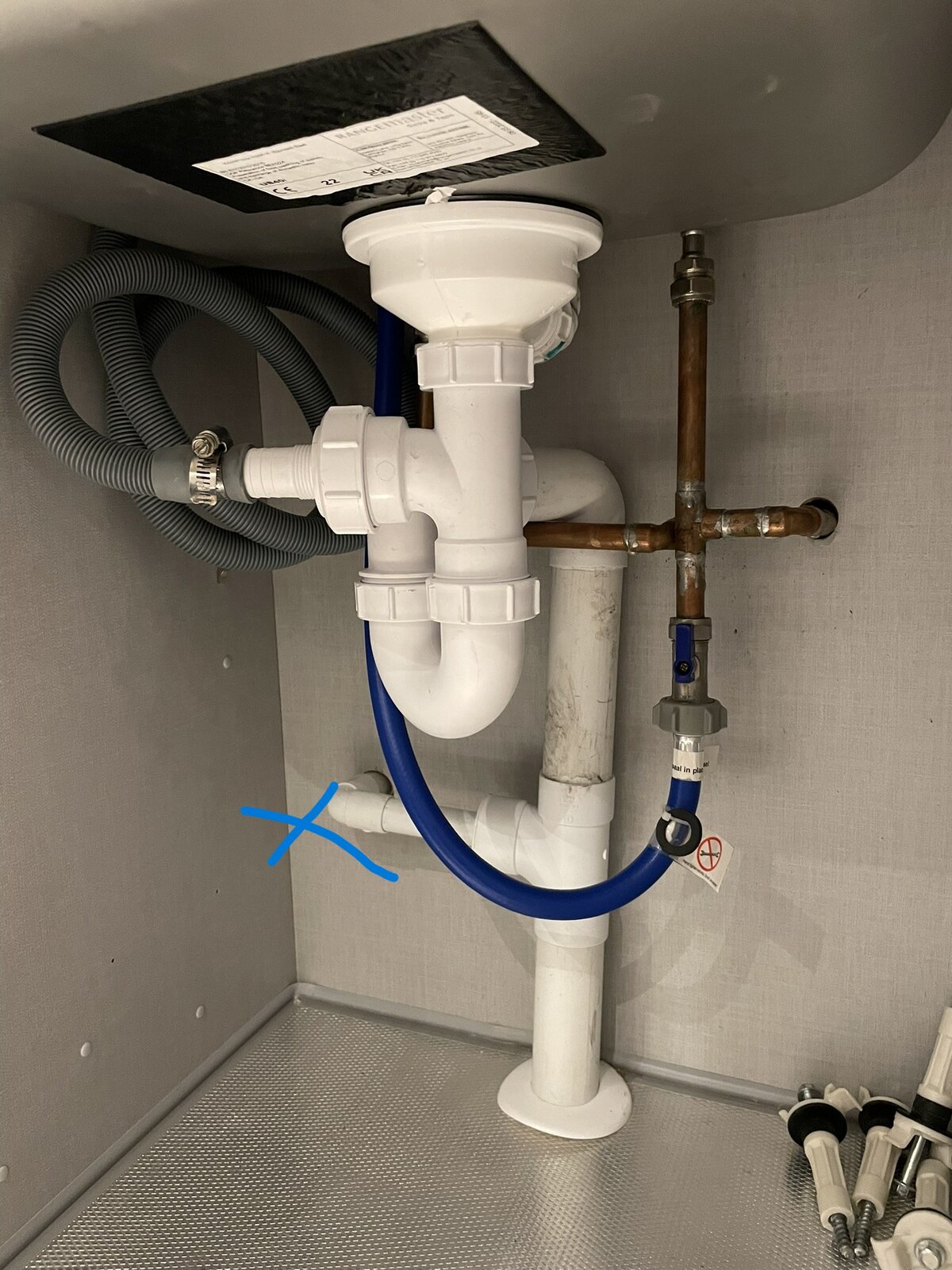

The one coming from the top to bottom is the trap for the sink into the drain. Before the trap it has a washing machine connected and a double sink.
The one coming from the left os the boiler condensate overflow
That condensate 3/4" overflow pipe into the tee is bad practice. Better to have it inch and a half pipe, less chance of it blocking. If it blocks the boiler condensate will back up and shut the boiler down. Alteration needed.

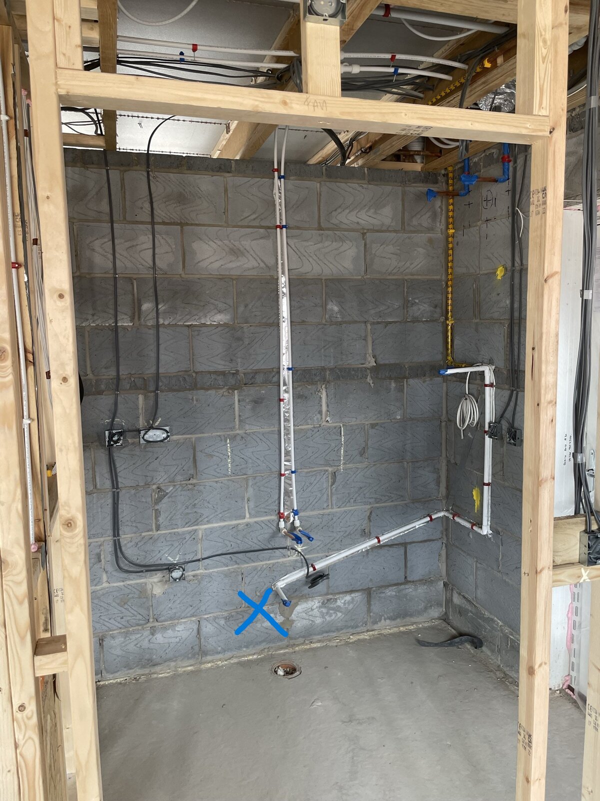

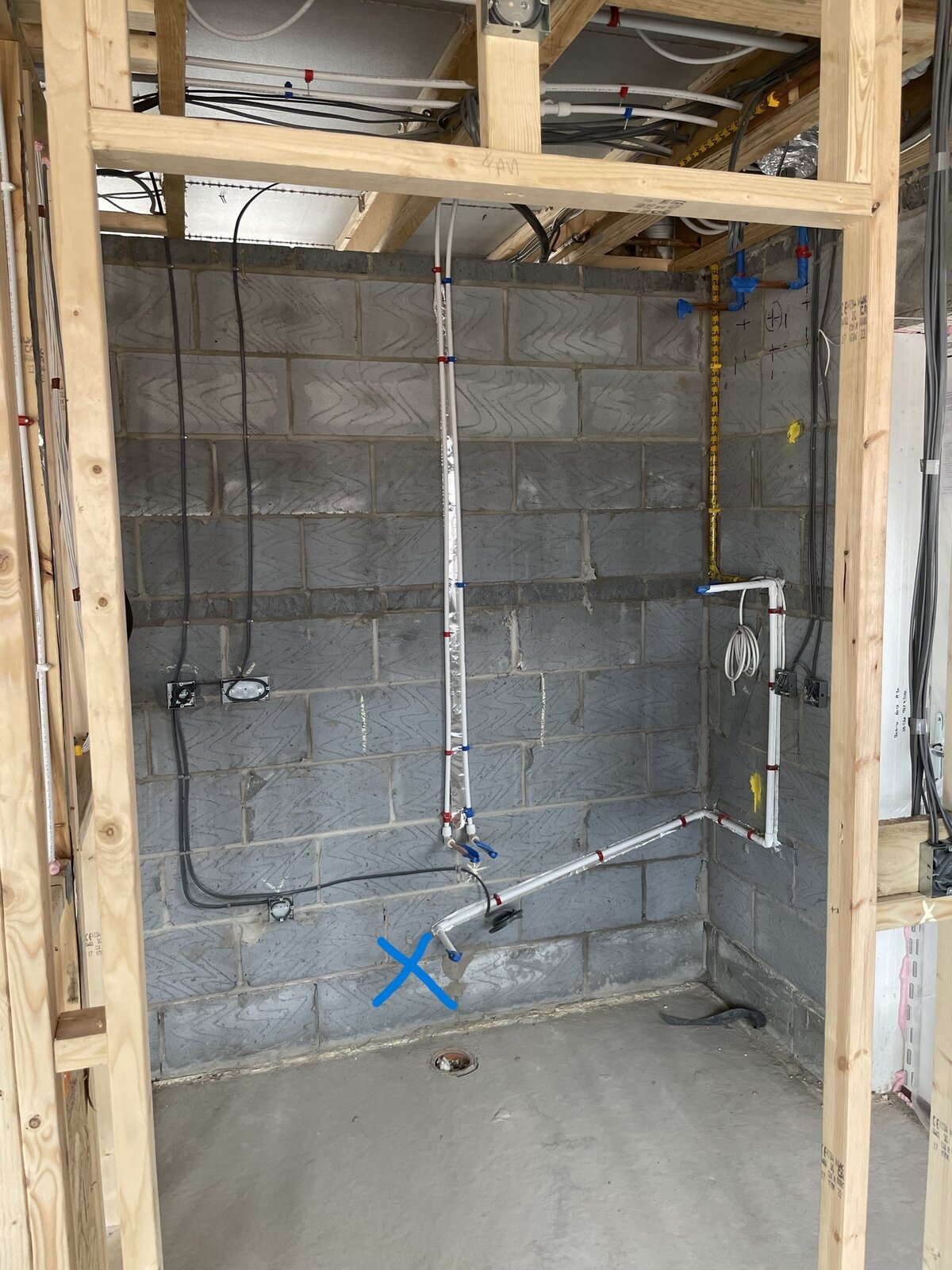

Pictures attached. Obviously the boiler condensate trap pipe is behind plasterboard now

Replace the top 90d bend with a tee and fit a durgo.
While your at it, sort that hose out for the dishwasher or washing machine. The appliance will die prematurely.

Actually found a u bend with a valve built in - this will save having to pull out all the glued sections which go into the waste
Thanks for heads up about waste pipe!
