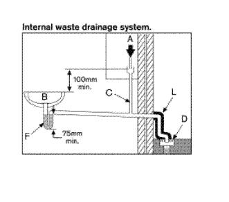

Hi All,
Can hear air/gurgling noises from condense trap on w/bosch junior 28i, when I empty the kitchen sink! Water drains away quite quickly and then I hear the noise from the boiler.
The condense drains in to the same pipe run as the kitchen sink, along a 3m run to the soil pipe.
1) Is this dangerous? - as it seems to be sucking in air via the boiler!
2) Would fitting an air admitance valve solve the problem? does this have to be fitted above the level of the sink?
The kitchen and boiler were installed just 3-years ago, the sink has an anti-vac bottle trap, could it just be a blockage in the pipe?
Many thanks
Pete

Hi JohnD,
No photos to hand, but did this diagram. Hope this helps?
The condensate pipe joins straight to the 40mm waste pipe via a T-piece adaptop. The washing machine hose connects to a T-piece adaptor just below the sink,there's nothing else connected to the rest of the pipe.

In the diagram there is no trap shown in the condensate pipe
If the condensate pipe went into the sink waste upstream of the sink trap, then it would be open to the air in the kitchen.

I see your pic now. I still see no trap in the condensate.
There must be no direct openings to the indoors air in the pipe that has the condensate connection to the boiler.
Although that is technically correct as flue gases can come out if the boiler trap is empty, many of the installations I see do have an air connection and that is useful to balance the boiler trap and avoid other drains "pulling" on the boiler trap.

If it is exactly as in the picture, it should be fine. From your description, it sounds as if siphoning sometimes empties the condensate trap. Not the end of the world, the main thing is that the seal in the basin trap keeps its integrity and no direct openings to the air.

An air inlet solves the siphoning and related noise problem, but some manufacturers insist on having the condensate run sealed from indoors air (I seem to remember WB do), where others like Viessmann allow an air inlet.
Personally, I don't see the problem of an airinlet, but if the M.I. state it has to be sealed, then that is what you have to do.

The trap in the boiler has/can have 2 functions.
Waterseal that prevents poc getting into the indoors air.
Siphon/collection system that avoids slowly dripping of condensate and making the pipe less prone to freezing up.
If the boiler trap is empty for whatever reason, AND the condensate pipe is open to indoors air, there is a risk of poc getting in the room. Apparently some manufacturers are confident that the design of the boiler is such that the risk is negligible, others aren't.
The only true answer is in the M.I. of the particular boiler as they take precedence over everything else.

The setup is fine, as in M.I, and safe so long as the water in the sink trap is not sucked out also. The bottle trap is fine but is likely to get blocked and is a pain to clean.
