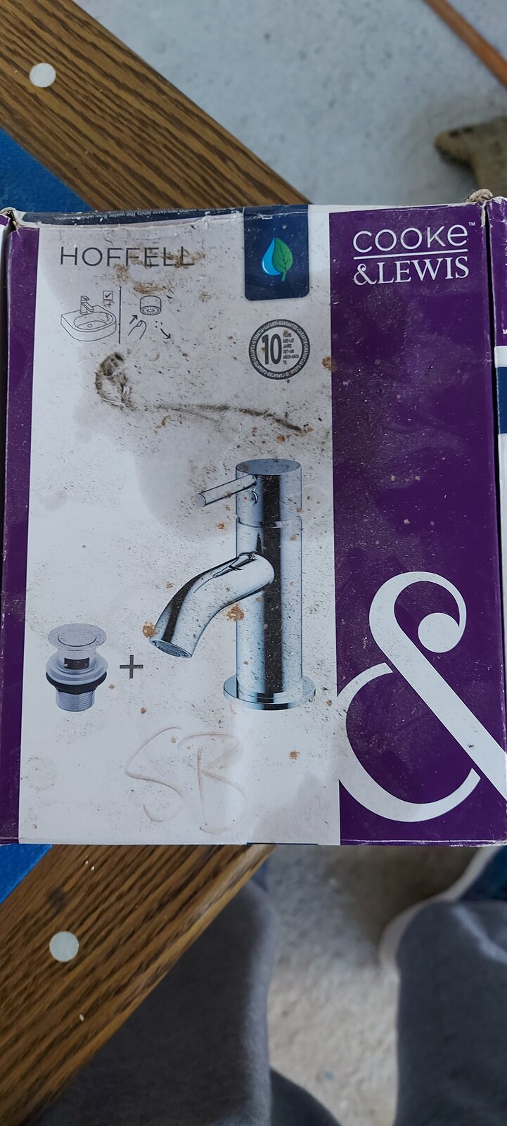

Hi
I have the tap on a sink in a toilet but the water flow has really slowed to nearly no flow at all.
I have taken the cartridge out and its seems fine but the water trickles from the tap.
Can the tap be the problem or could it be the pipes? I have copper pipes hot/cold running down wall with flexi tail pipes into the tap.
Any advice would be appreciated.
