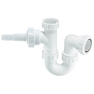

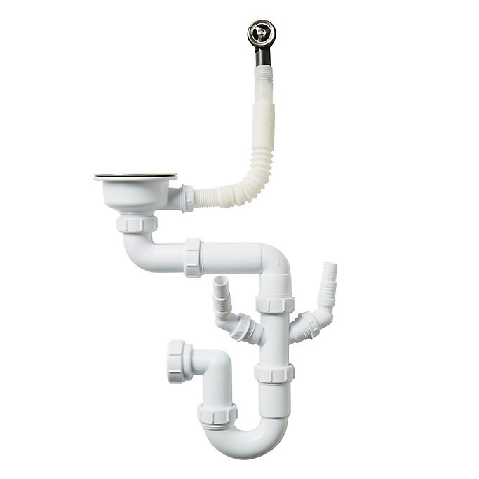

right you will have to excuse me because am a woman and used to being on the top end of the sink not the bottom, my question I need a waste trap the one I want is sold out at B&q, I saw a similar one at screwfix, are these pretty much universal fitting, I asked the man in the shop but he said just check before I buy ??? first pic is the one I wanted the second is the one Im thinking of getting ..what do I need to check to make sure it fits...

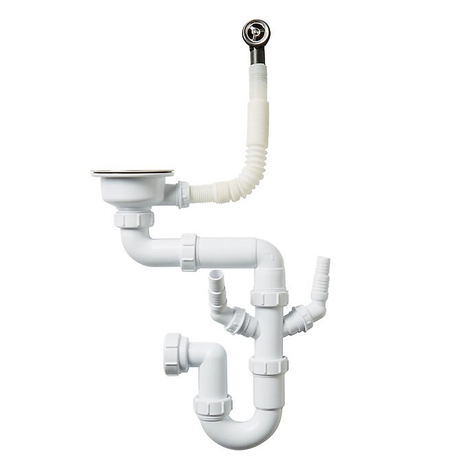

am not doing it, new sink and pluming, the new sink I have recommended the 1st pic but b&q have none, so I went to screwfix and he suggested pic 2, me not having a clue about anything like this is wondering if the waste traps underneath are universal how do I find out which is for what I have looked on the sink and it doesn't say, does one fit all? any clue would be good... thank you
I have new kitchen cupboards, worktops, sink etc the man who is fitting it is expecting to come and fit it with all the stuff I need here ready for him to do the work, I cannot expect him to fit sink with no fittings underneath, or that don't fit, so need to know in advance. The sink is a black Cooke and Lewis Christianna if anyone know what sink trap waste fits I would be grateful...(y)

What you are looking for from B&Q is 'Pack A' which is a sink waste, appliance trap, and a P trap.
The one you are looking at from Screwfix is just the appliance trap and P trap, you will still need the sink waste.
For the sink waste you need to make sure that the diameter of the plug hole matches. [Example]
Do you have any appliances that need to be connected to the waste (washing machine/dishwasher)?
If you have one appliance, then the one from Screwfix will work. This one if you have two.
If you don't have any appliances then just a P trap will work.
To be honest you might be able to reuse your old traps, and just get a new sink waste.
wow, this is so clear, I thought I could do this I had to make sure ! I have a washing machine so just require one trap, and an separate sink waste will be needed... I just wanted to make sure the traps had the same diameters.... thanks so much (y)
Whereabouts in the UK are you? Looking at availability in the Midlands/Home counties area, most stores seem to have the 'Pack A' in stock.
If you cant get a 'Pack A', then you'll need a 'Basket waste' I'd think for that sink, such as https://www.screwfix.com/p/stainless-steel-strainer-waste-1-bowl-90mm/9411k (Check diameter of hole in sink to make sure this one fits.)
All domestic sink wastes should be 40mm outlet, so then add a trap to suit, e.g. https://www.screwfix.com/p/floplast-sink-washing-machine-trap-white-40mm/12794 and you should be ok. Your installer will then connect the waste pipe up from the trap to the drain. (I wouldn't try reusing the old trap, the seals go brittle over time and it's likely to leak.)
