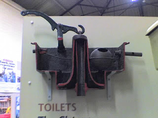

Whilst at my mum's house recently, the WC seemed to be rather slow operating and short of water during the flushing cycle.
Before I strip it to see what can be replaced. Can anyone give some pointers as to which bits will need replacing.
I think as it is part of a bathroom suite. Replacing the WC is not an option at this moment!

Yes the cistern is full. However, when the lever is flushed, water spouts up the thru the hole where rod passes thru into the chamber which starts the action of flushing.
When I say it is slow! I mean the action of the water entering the pan and exiting. I don't mean filling the cistern.

I suspect it is a 'dual' flush WC. It does have the big 'bomb shape part in the cistern.
a big bomb shape? like a bell?

I don`t think it`s a syphonic trap WC - I think OP means the flush syphon in a WC :confused: Dual flush... Bomb :confused:
The WC is low flush and has a 'bomb bell' bit that does the flushing.
It does not look like any of the flushing things you buy at Plumb World etc.
Problem is OP, that your terms are confusing to us tradesmen :oops: . There is a bell in that cutaway cistern - and a device that fits inside- hidden away in a Syphonic Outlet WC is called a bomb. Any chance of a picture :?: The Flush Syphon in the cistern could be plastic or even ceramic... then again Dual flush with water squirting up could mean you`re only getting a half flush because a small plug has dropped out

From what I remember it is a bulbos shaped porcelain flushing thing, which appears to have a number of brass screws holding it together at the bottum.
PS.
Nothing like the photo in the link. The WC is very modern porcelain looking, and is Low flush, Close Coupled with 4 brass screws holding the cistern to the pot. I estmate it to be 40-50 yrs old??

Right .. a Ceramic syphon for the flush.. that could have a new diaphragm made up for it . :idea: Now the pan it`self may be a syphonic outlet ..do you recall if it has a shallow bowl with a small outlet -that, when working seems to "draw" the water etc. away :?: If it`s like that, rather than a conventional big-ish outlet -you have an old syphonic pan too :idea: Your guess @ it`s age is about right too ;)
Nige,
The pan is fairly shallow with a small outlet. The waste is sucked out, followed by a water fill.
