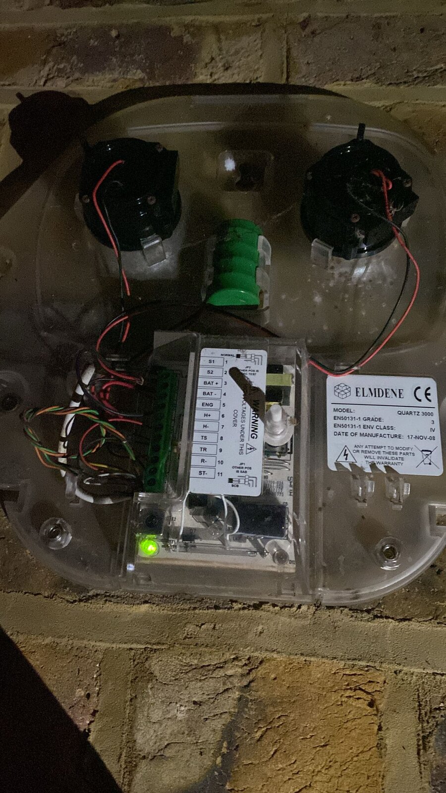

It would appear that the battery of our outdoor siren alarm has died and needs replacing. I’ve opened it up and attached a picture.
Will this be a suitable replacement for it ?
This one also says recharchable, is mine not ?

Take the current battery out and it should have the details printed on it.
But looks about right.
Not familiar with elmdene units, so don’t know the recommended power or capacity of the top of my head or its dimension for it to fit units holder.
Note looks like screw in battery terminals and link to battery on amazon is pre terminated battery , so would require cutting off and stripping potentially if it’s the right power, capacity and dimensions.

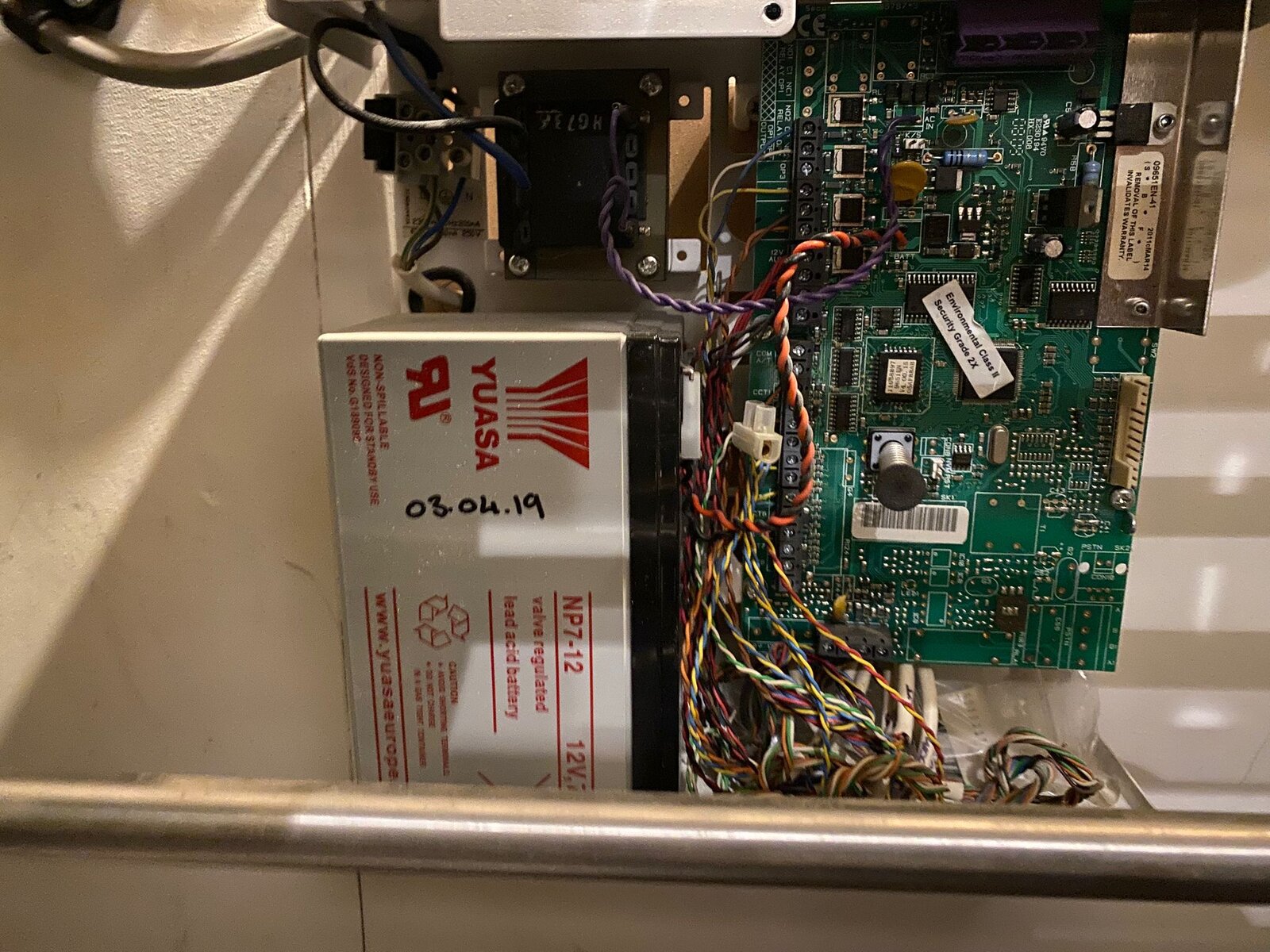

It does, as when you switch mains off alarm still works, I believe it is to prevent it being disabled by cutting power off. I’ve attached a picture, to the left is the battery I’m replacing, which has died.

Yes, and that’s the main battery which has died but I think it charges the siren outside as well
But you don’t really know do you ? It’s done it’s job after power fail….sounded and cut off , it won’t do anything untill it’s re-powered … I don’t think there is anything wrong with it
I am lost.
If the mains is off an panel is working then the back up battery is working.
If you have mains on and disconnect the battery is the alarm panel still functioning?

Main battery died for sure, I had an alert about it being low in the controller on the wall but the new one hasn’t arrived it time yet.
When this battery dies or taken out the siren outside goes off as it thinks someone is tempering with the alarm inside.
This is an old siren from 2009 so not complying with latest regulations to stop after 15-20 minutes. It went off until its own battery died as well.
My question: Once the main battery arrives and revives the system, will it also charge / revive the siren battery or do I need to have that replaced as well. I guess I can wait and see when it arrives by testing it
That’s a elmdene quartz 3000. It does have a cut off timer , that’s what’s probably stopped it ringing not a flat bellbox battery , the 9651 would have come up with a battery fault but that does not relate to the bellbox battery …
