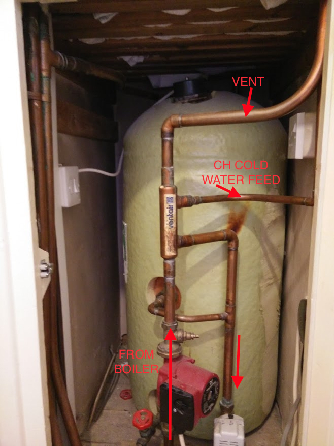

Hi,
Really appreciate any help.
Have open vented CH/HW system. Always been very noisy, lost of gurgling sounds in and around pump / ventair air vent and around the boiler. Sounds like air being sent round somewhere and the sound of running water (gurgling) also sometimes at some rads.
Heating works great however, rads piping hot and never need bleeding, despite the air sounds and gurgling.
Have a suspicion that pump/ ventair might not be correctly sited, see attached photo.
Any help really appreciated!
