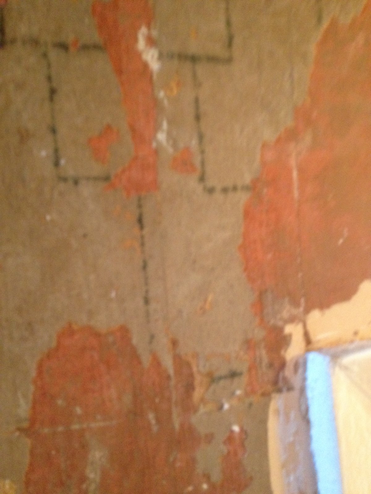

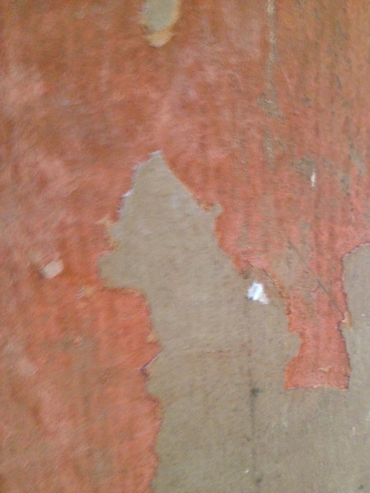

Hi I am about to skim a hallway and landing but there's some difficult paper stook to the wall that is realy har to get off can anyone help with a easy way to get it off or if I can just skim over it. I have tried to get steamer on it with no joy. Thanks

So basically if I can't get it off will this show after plastered ? Thanks
Yep I thought so lol. It's a nightmare to get off and there's hell load of it.

If it’s that hard, take a grinder/sds chisel and cut the patches. You’re plastering anyway...

Yeh il give that a go I got a new scraper yesterday and that got a nice bit of it off but still half the stairs and top landing with it on but yeh I'm going to try this tomorrow cheers.
