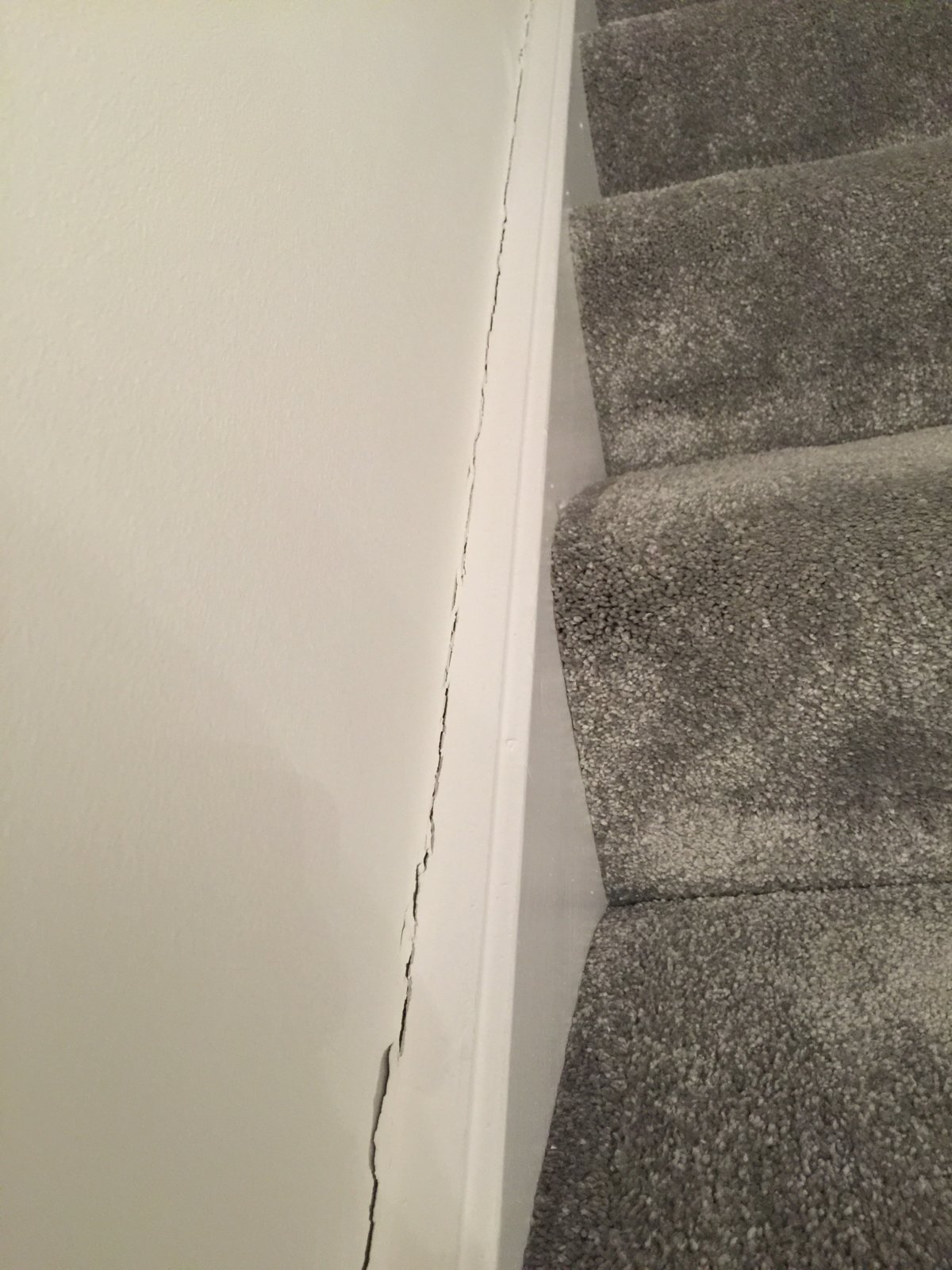

I'm about to start painting and have noticed some cracks between the skirting and the wall where the house has dried out over the last 18 months (new build). In the worst spots should I just scrap away the blistered paint and loose caulk and refil and for the areas where there are just cracks just refill? Basic I know but advice would be appreciated along with details on the right caulk to use.

My preferred caulk is Everbuild 125. They used it sell it at Toolstation for about 90p but dropped it favour of another Everbuild caulk which is more expensive and inferior.
Cracking where the stair strings meet the wall is common. I would use a MS polymer rather than caulk though. The MS polymer remains as flexible as silicone. Caulk may end up cracking again.
A MS polymer will cost between 5 and 11 quid. Look for SikaFlex, CT1, Stixall, Everbuild Puraflex 40, etc.
MS polymers will accept water based paints without any issue. If you were to, for example, apply an oil based paint first (without a WB paint first), it would take months to dry.
