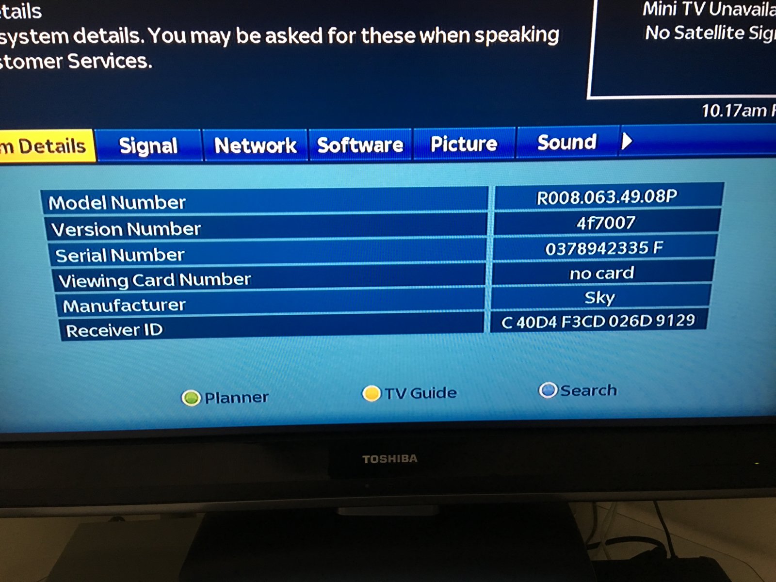

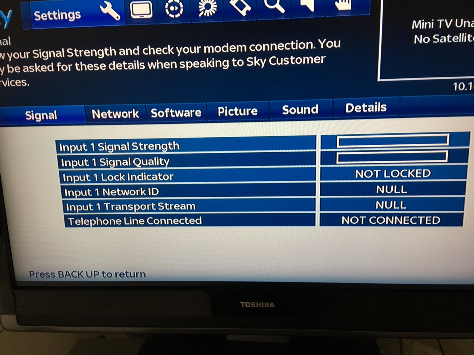

Hi
I’ve just gone into the signal strength menu but the top 2 indicators arnt very helpful. Does the fact that they are empty bars mean poor signal? Or full signal? I was hoping for some sort of %. I’m attaching photos. Thanks
0B1B64C9-2554-4D61-8FAA-245DE3478BEF.jpeg 7F4E3687-4F9B-4677-A5FE-B711C75FF311.jpeg
You have no signal to box, either cabling loose,faulty or dish has moved [in which case no one connected will have a signal]. you appear to have only one cable connected.
The signal quality is the same whether you pay for it or not. You need to contact the other tenants, and see how they are doing. IF, they are using sky, and have a good signal, then it's a cabling or LNB issue, and if they've got no signal, then it's a dish or LNB problem.
Of course, sods law says they may not be using sky, but hopefully one of them will let you take your sky box in, and connect it to their TV to check out their signal.
And have you checked that there are no lose connections at the back of your sky box.
foxhole and Doggit are correct. You have signal set for only one input, and the signal quality is the same whether watching from paid Sky subscription or Sky Free-to-View for those channels that are available under both systems.

Let's do the basics first.
1) Have you checked the connection lead plug ends from the wall socket and at the back of the box?
2) Have you got one or two outlets at the wall marked up as SAT?
3a) Did you bring your Sky box from a different house and that had a two-cable-connection?
3b) Did anyone set-up the Sky box in the flat for you, or did you just plug it in?
Okay, here's some likely cause for signal loss in just one flat but not others
  • You're the only person in the whole building using Sky, and there's some problem with dish or distribution gear but no one else watches via Sky so they're not affected - Probability 1/100 - very low unless there are only two or three other tenants in the building and they rarely watch TV
  • The plug ends for the satellite fly lead(s) are poorly fitted or have worked loose over time - they move with vacuuming or the curtains brushing past - Probability 90/100 - very high
  • Sky in your building works on a single feed only, but your box is still set up in dual feed mode, and now the box has thrown a hissy fit - Probability 1/100 - very low Your box won't just stop working in a situation like this. You'd notice a few failed recordings even though it appears you have signal
If I were there troubleshooting then the first thing to do is make sure that plug ends are still fitted right.
I have seen it where a single thick cable was changed to thin twin, but the bodger doing the job used a bigger diameter plug end on a thin cable. It didn't take long for the cable to work loose. Other possiblity with plug ends is the braid was cut right back so it's not making a connection with the outer shield of the plug - it's a broken electrical connection again (very low voltage so perfectly safe).
Where the cable hasn't been prepared properly then it's possible for it to come out off the plug just far enough that to a causual glance it still looks okay, but on closer inspection the plug end is only barely on to the cable end.
