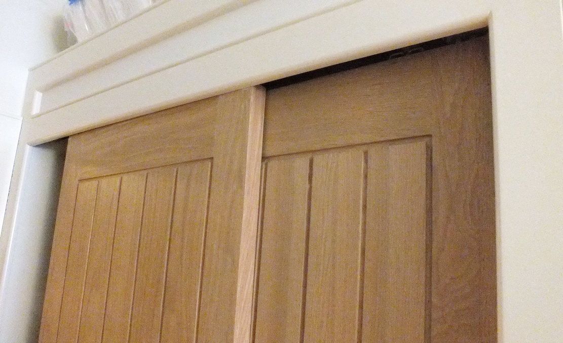

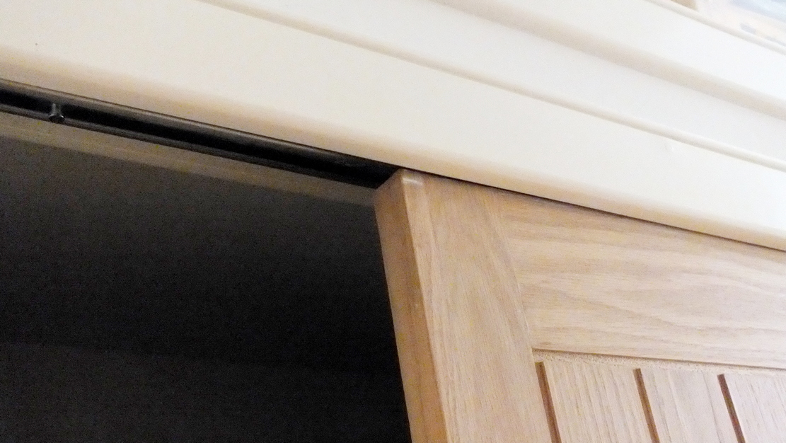

Hi all
the other day I went to open one my wardrobe doors only to be greeted with a refusal. Took a while to get it to slide back but since then it's been a real PITA! I've no idea what's gone wrong but if you look at the picture I think you'll see that one end has dropped, well, judging by the rub mark at the at the top of the door. Is this something I can attended to or do I need to get someone in?
Cheers
Char
PS...these doors are solid and heavy!

I'm not an expert on wardrobe doors but it appears to have lost one of its runners. The screw that is hanging down from the channel should be attached to the top of the door to take the weight and help it slide smoothly.
My doors only have guides on the top hedge of the door, with rollers taking the actual weight fixed to the bottom of the door. The rollers are adjustable for height - might your adjustment have slipped?
Looks like a henderson type runner.
You should be able to remove bottom retaining blocks and lift the doors up,and out of the track.

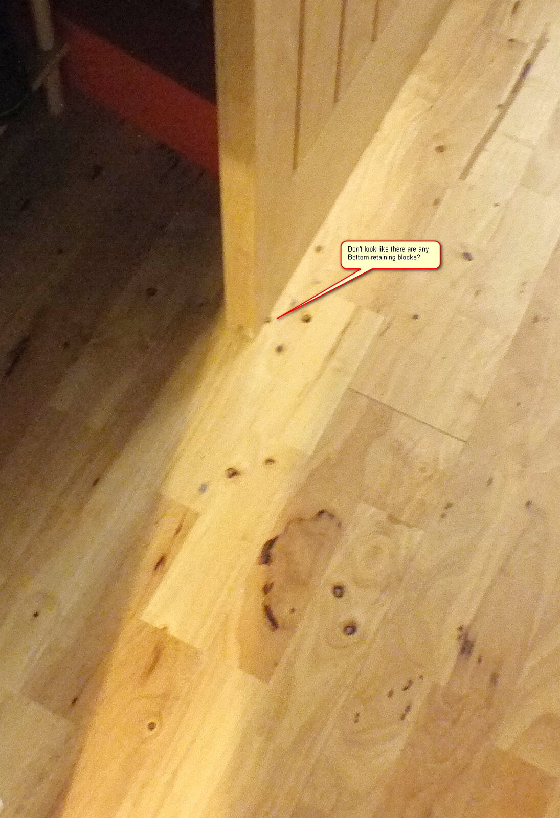

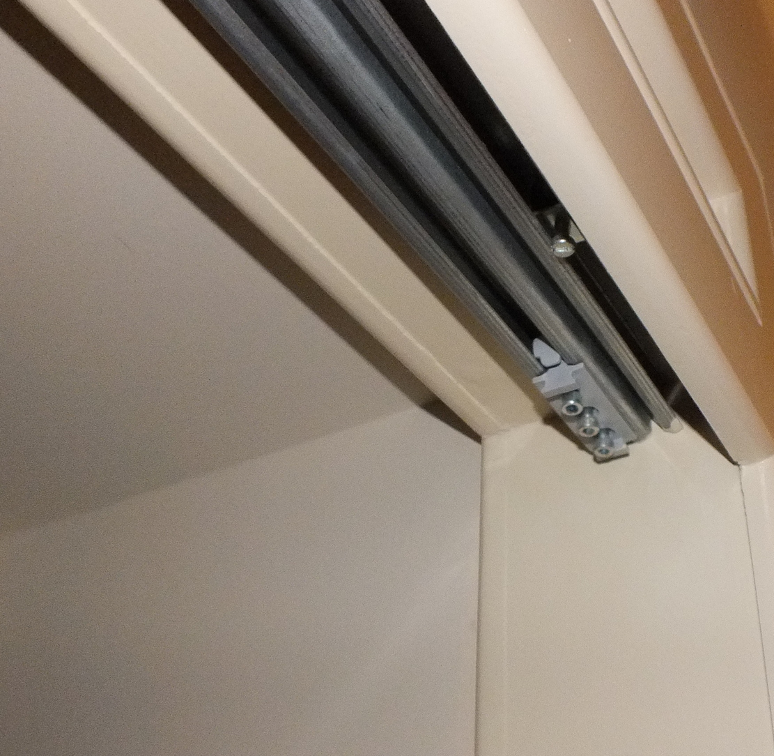

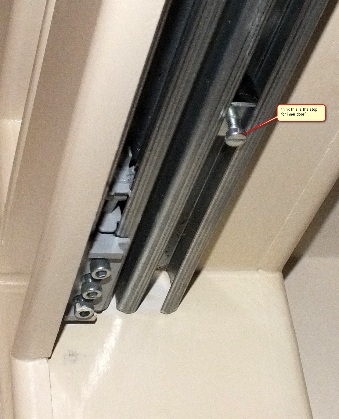

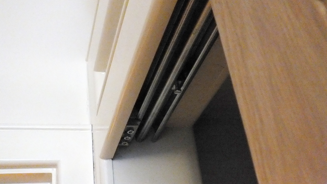

Hi all, thanks for the replies. Took a few more pics the other day as still not able to remove or work out how to fix door.
Cheers
Char.
