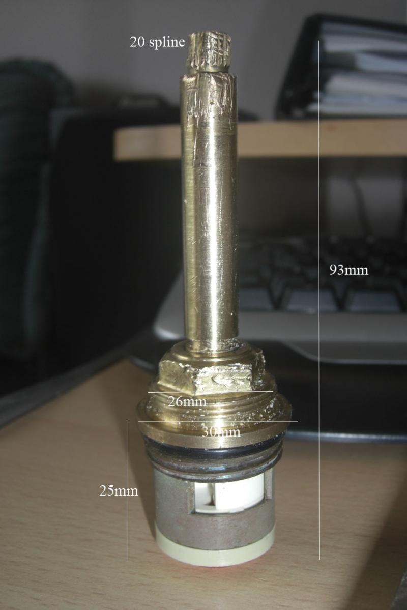

Cold water tank in loft, thats all, no other tanks. Combi boiler providing hot water to radiators, taps & shower. I can hear a drip coming from behind the (standalone) shower so take off the covers to the valve and yes, there's a drip. OK, turn off the main water valve - still water coming through the cold taps.....(Is this because the cold taps are fed from the water tank in the roof?) and the shower valve is still dripping. Take off the valve and a portion of the valve has worn away but on replacing the rubber o-ring inside, it still drips....this is getting annoying now, cue argument with wife, quick shout at the kids...back to it. Except I'm stuck - is it plumber time? Will another shower valve stop the drip?

As for the shower valve, a leak on the body of the shower should have been fixed with a new seal - always providing it was seated properly and not damaged. If the new seal has no improvement I would suspect some corrosion somewhere around the seal and so time to replace the valve body.
Just replacing the cartridge may not solve the problem - If the leak was where the spindle exits the valve then yes, otherwise no. I would suggest you refit to find exactly where the water leaks from. Toilet paper is a good indicator of any part that is wet. Just wipe a suspect area with a clean and dry piece and any dampness will show on the paper.
Edit: twice for grammar/spelling and this - please get some decent tools as the metalwork you have is chewed up something awful :wink:
You'll maybe find what you are looking for at Lunns.net or the showerdoc
Both excellent firms with quick delivery.
