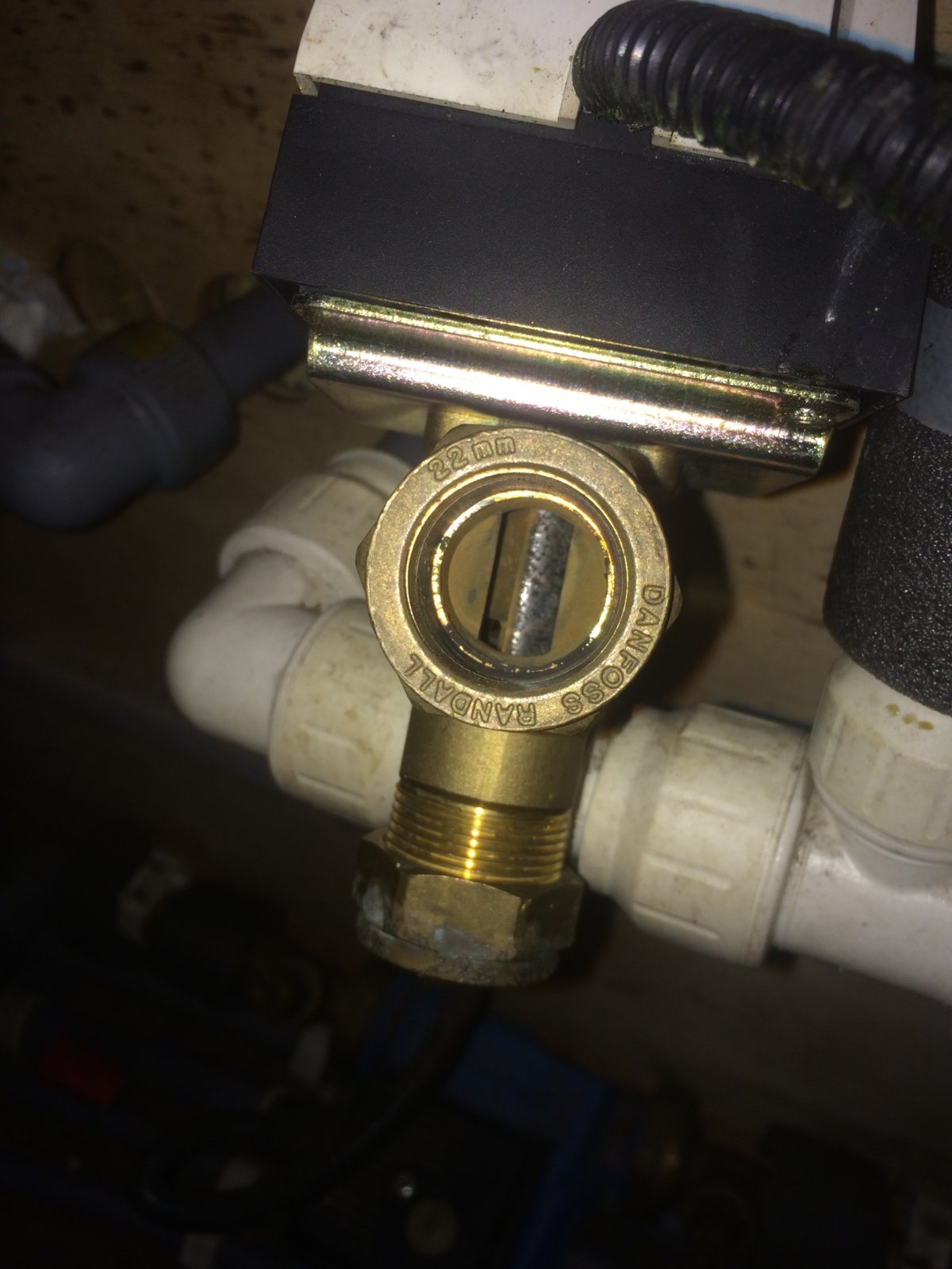

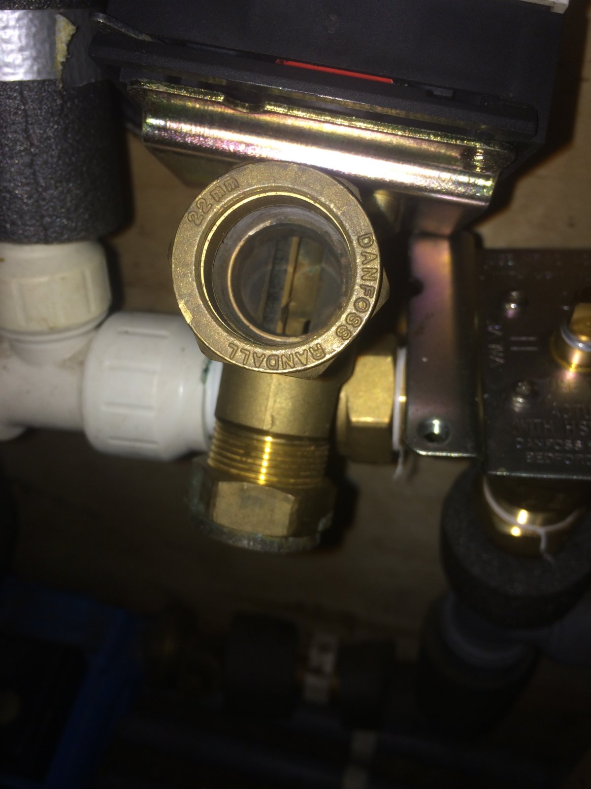

Take the actuator off and see if you can operate the spindle easily.
Then, with the pipes cool, turn on the heating, turn the spindle to HW and see if heating pipes warm up, if they do, then valve is goosed.
If the spindle is stiff, then replace valve.
The end lever is not a reliable indication of how far the valve is open. This is because it is not attached to the spindle. This is demonstrated by the lever being 'loose' in the slot when the valve is open to heating.; The lever is only there so the valve can be be opened manually, e.g when draining or refilling the system.

I replaced the valve for a new one a couple of weeks ago thinking it was the 'ball' in the valve that had worn out. Turned out it was a valve with solid metal cylinder thing that rotates ( can't describe it very well) The point being it did not appear worn out but had a new one (same design) so put new one on anyway. So pretty sure it's not the valve (at work so can't try the above experiment but will later just to check). Incorrectly balanced system sounds more likely but don't know how I could correct that?

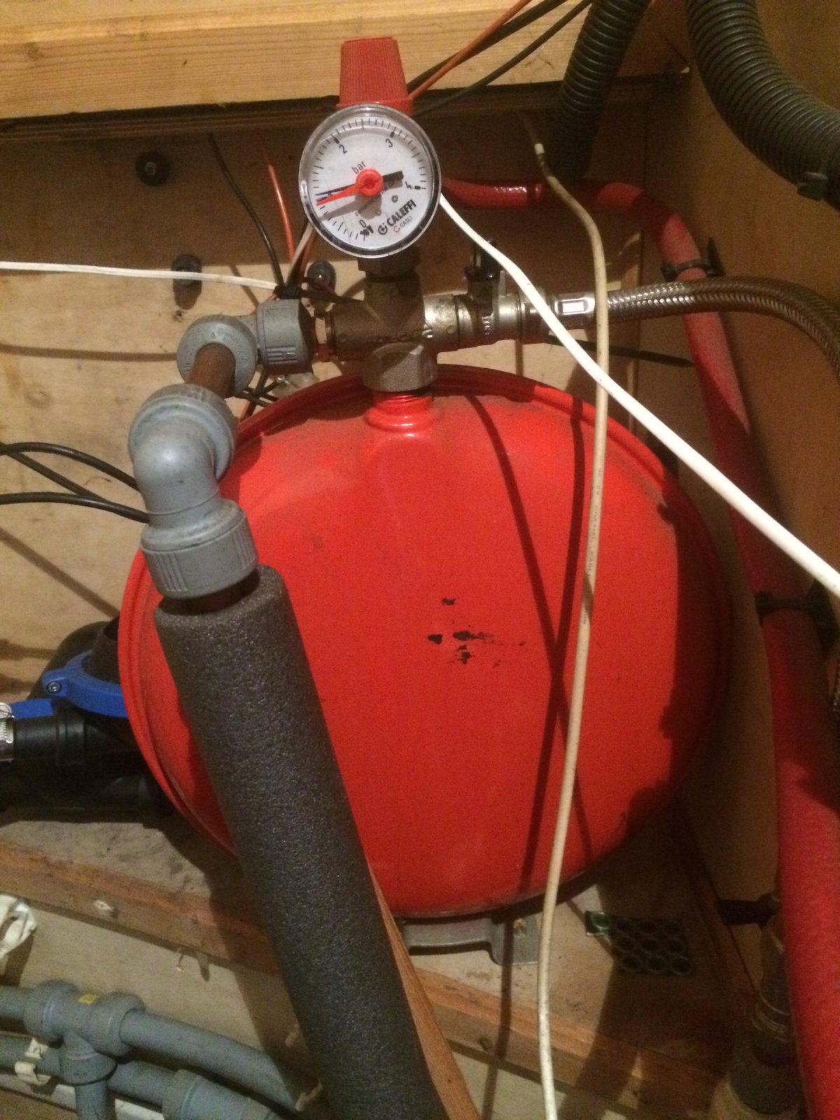

Do you mean an unvented hot water cylinder? I only ask because when I had my system converted to unvented, they removed the three port valve and replaced it with two twin ports as they said I shouldn’t have a three port valve with an unvented cylinder.
You can have a three port valve with an Unvented cylinder , but regulations state that you have to also have a two port as a safety mechanism, that would close in the event of the cylinder getting too hot, and remove the heat source

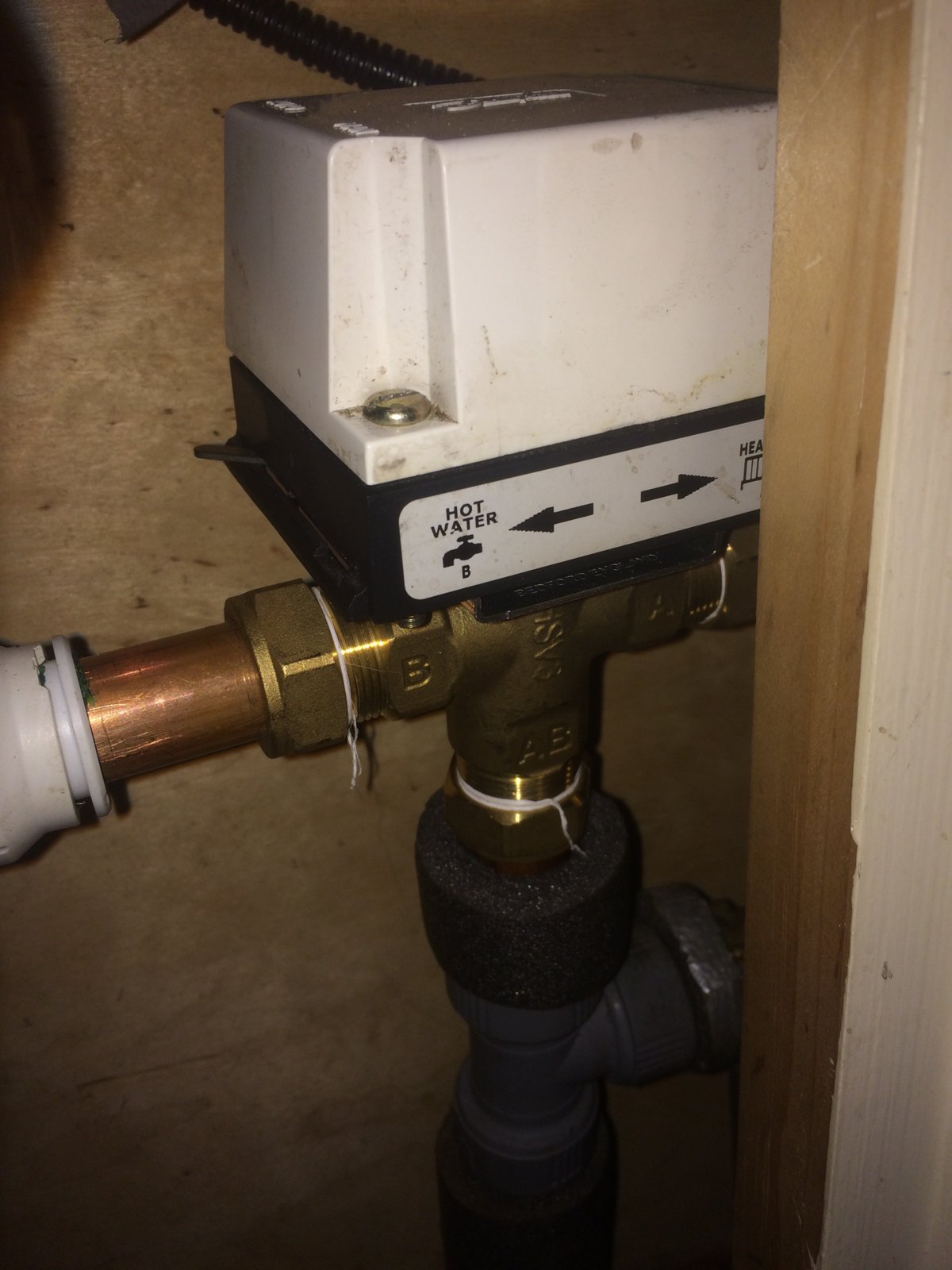

It's unvented with a 3 port but it's on a boat so regulation kind of goes out the window. Will use the old valve I took off to match up against the movement of the new valve spindle to see how open the valve on each port is in each different position, and a general play around tomorrow. Thanks for all your input.
An unvented cylinder on a boat ? please post some pics
Hi all. couple of pics - system on boat: water in tank goes into pressurised system via pressure switch keeping it up to 3bar which is water to taps. There is another valve to the heating system with an expansion tank at 1 bar, hence the unvented hot water tank (no pic as it was ****ing down so didn't go out to the engine bay)spent the morning testing system. Anyway, I put the motorised actuator on the old valve so I could see what was happening to the valve as it wasn't hooked up to any pipework. On the mid position the valve opened both sides - picture of both ends - so it seems motor/valve doing what it should. Can only think there must be a build up of sludge as with both valves open the path of least resistance definitely heavily favours the radiators. Would a weak pump have any effect? I only ask as a couple of years ago the pump (now 14 years old) made a whiny sound. I bought another pump thinking it was giving up but noise went away so never fitted it - it does run really hot. Not sure how hot it should get as it's running hot water through it but if I open my palm and cup it in my hand I can only hold it for a second as it's to hot beyond that?
