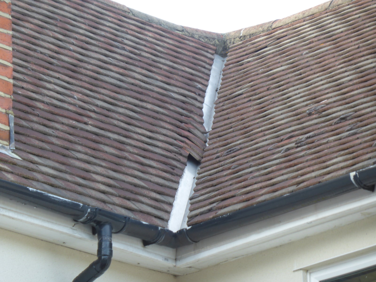

Hi,
I have a few flat concrete tiles which have slipped out of position due I presume to the nails rusting away. As you cannot re-nail these tiles back in place due to overlying tiles, I believe the standard fix is glue them back in position. Can anybody advise me of the best adhesive to use.

glue is a shoddy fix, post a picture as there is only one concrete product that i can think of that relies only on nails
Hi,
I've uploaded a pic of the slipped files for your info. These are the tiles without nibs to hold them in place.
Any help gratefully received with regards to a repair.

Can anyone identify this type of tile, are they clay or concrete and will they have nibs on the back to hold them in place??
Concrete, looks like they have slipped off one nib and slewed round..you can try lifting them back onto the battens.
Many thanks for your response. Maybe a blob of gripfill or something will prevent them from rotating towards the valley in future?
Just expanded the pic and can see clearly they have slipped off the batten..looks like about 7.
Try reseating them , see how they sit and how tight they are to get in.
Take them all out and you should be able to get a nail in them all barring the last one...gripfill that.

OP,
You've got concrete plain tiles, and each tile has two nibs.
The tiles should be double nailed at all roof edges.
Small cut tiles edging the valley are typically holed to give two fixing holes - the cut tiles are screwed not nailed.
Tile and a Half tiles are available and work well when cuts are required - but they are often not used because of a little more expense per tile and a half.
You are probably best using valley tile clips - Danelaw SS Valley Tile Clips are available but expensive, however there are other brands or you can customise your own clips from simple plated brackets. Always screw them on.
FWIW: the tiles are disturbed, kicked up, to the upper right side of the valley.
Slip them out and the tile next to them.
By taking the tile alongside out will enable better fixing options especially on the last cut one..
working from the bottom slipped cut fix them back by nail or screw.. 30 mins job once you have access
