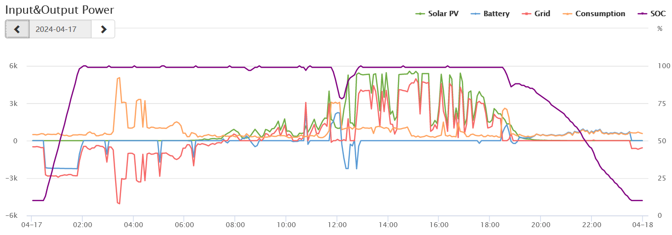

So much for estimated bills, we pay a fixed monthly charge exactly the same as before the smart meter, it has allowed a change in tariff, so get cheap rate over night, but without the solar software we would not have a clue as to what we are using. 1713438440488.png The solar shows exactly what we have used, and on the day I have today used 5.8 kWh, imported 7.1 kWh, (difference is what has gone into battery) fed in 3 kWh, and solar produced 5.4 kWh but as far as cost, since tariff should change at 8 am, I can only guess that my bill today is 7.1 x 8.95 + 59.14 so £1.23 so far today, likely will run out of battery before end of day, so will be more than that, so some figure x 31.31p for the higher rate, but looking back I get 1713439277219.pngso totals for each day, but no way to see what used before and after 8 am. Hovering mouse pointer over the day only gives totals, however that is far more than the smart meter tells me.
But my IHD shows £1.68 used, that is very different to the £1.23, no idea why. It also shows used 5.05 kWh which works out at 24.36p per kWh so some thing up the creak.
