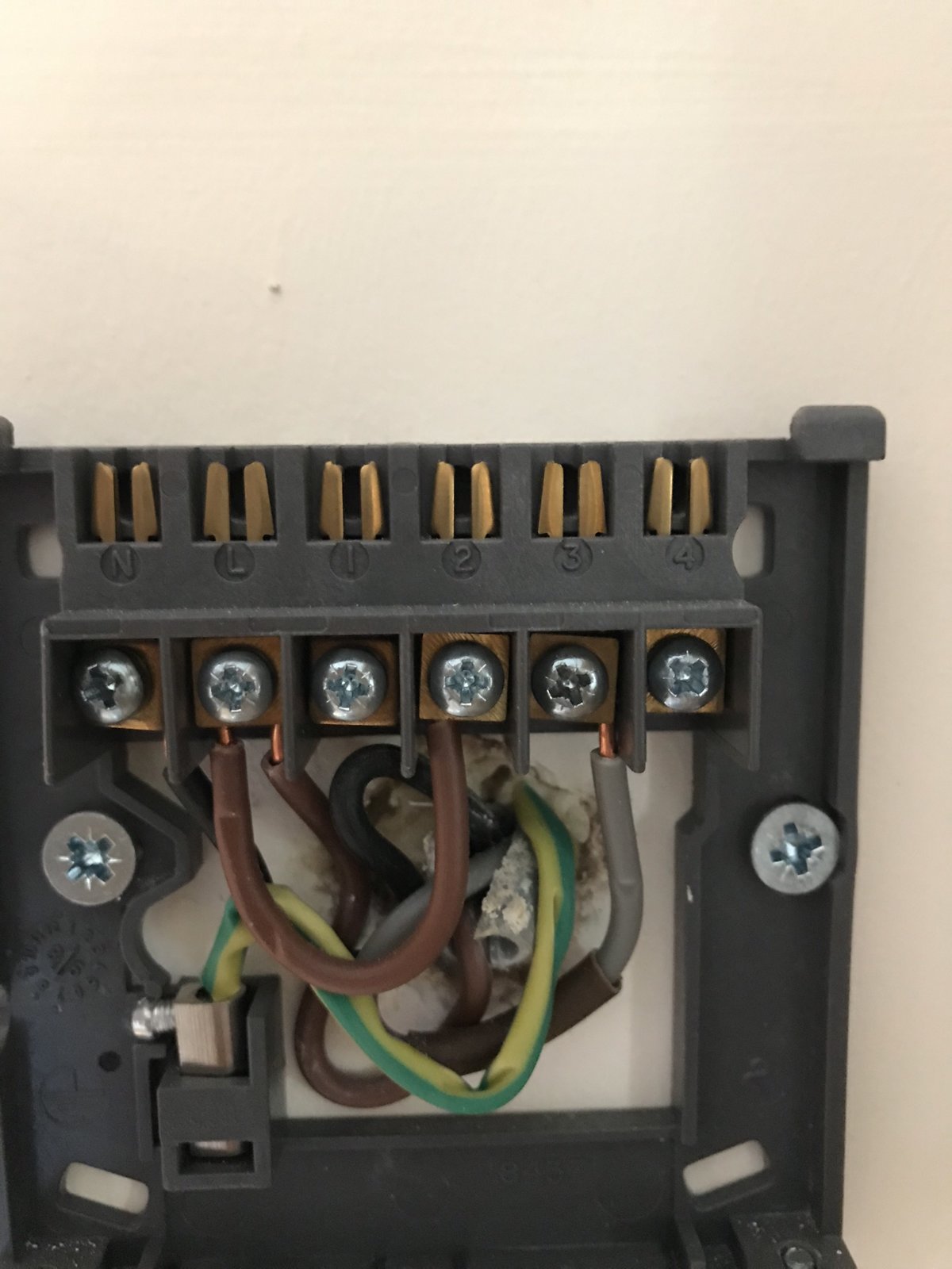

want to remove Danfoss RMT230 and switch to using smart thermostat.
Any idea what the 2 and 3 pins connections do. See photo.
Using smart device as per instructions on left. It’s a zemismart room thermostat that works with Alexa operating wet underfloor heating servo valve.
How the heck does it wire up??

Thanks for quick response.
I sent the photo from the actual installation.
I’ll double check the product number when I get in.
It shows L and N as you say is simple but it then has a jumper wire from live terminal to pin 2 and the grey wire to pin 3.
Pins 1 and 4 not used.

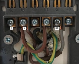

That's more like it. In that case its terminals are as below:
From the above you can now work out what each of the existing wires does.
The Black wire in RET230VF N = Neutral
The Brown wire in 230VF L = Live
The Grey wire with brown sleeve in 230VF 3 = NC (Normally closed)
So you can now identify their equivalent connections at the new thermostat.
The link presently between L and C (Common) is present because the RET230VF has 'voltage free contacts' that can be used to switch any voltage. Not all thermostats have this provision and are only suitable for 230V so don't have a common terminal as they already have a link to 230v made internally.

Looks right to me. From your photo of the backplate and the wiring diagram for your existing thermostat the wires are currently identified as being connected as follows:
The Black wire = Neutral
The Brown wire = Live
The Grey wire with brown sleeve = NC
The same connections at the new thermostat would be:
It's slightly unusual to use NC (most systems use NO) to control the heating but that's how it is now, so you will be swapping like for like.

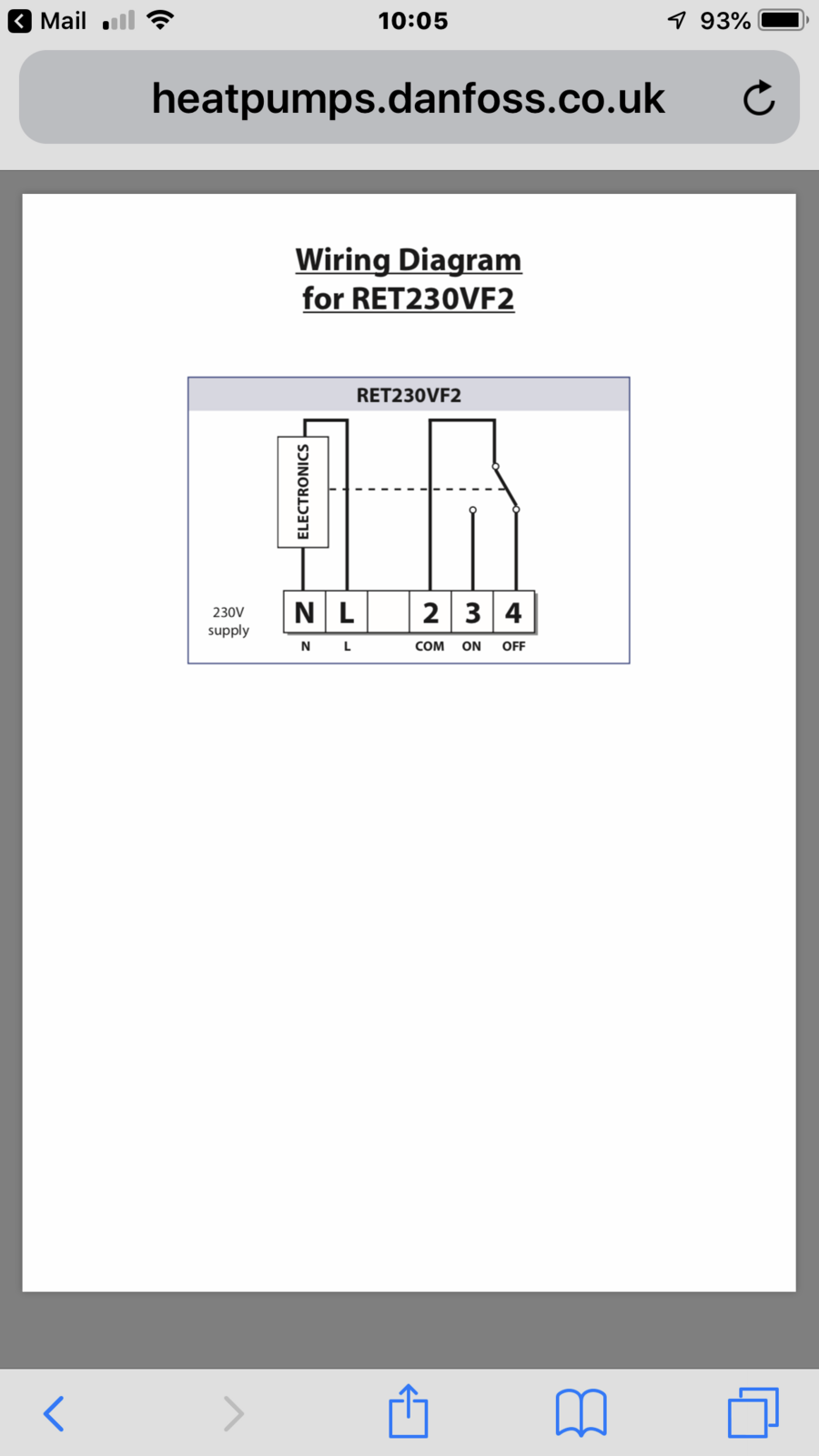

Just about to connect up but did a double- take on the origional. Isn’t pin 3 for NO ( normally open) as you suggest modern systems are. If so it’s pin 6 on new one not 5.
Are you looking at different pictures to me? If you look at your photo below, the grey wire is presently in terminal 3, which you can also see underneath is definitely NC according to the manufacturers diagram for the RET230VF.
You can also see that terminal 4 which is NO is not connected to anything. So if your heating system is working as it should be now, and you haven't said that it isn't, then you shouldn't change anything. You are just swapping the wires over from one thermostat to another thermostat like for like.
If is unusual, but if it were connected the wrong way around for your heating system's configuration, it would presently be working in reverse. Meaning that the heating would be 'on' when it really should be 'off' and vice versa.
I was viewing this.i guess if it’s wrong way round it shouldn’t cause any issues. Just not work correct and I could change round later.
But the circuit diagram I sent you for the device just shows that it’s connected at present to pin 3 ( in thumbnail that is NO)
