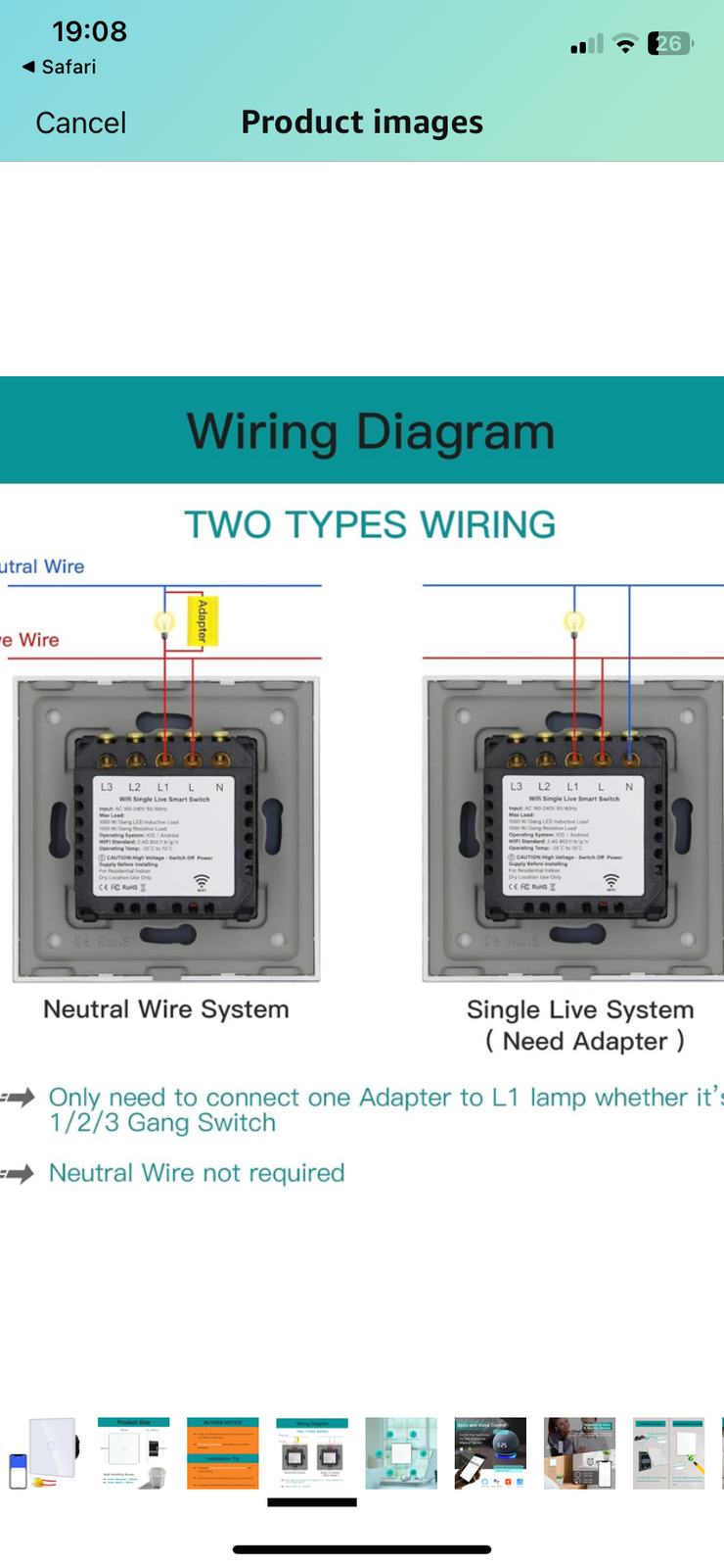

Hi I’m installing a new column radiator in kitchen to replace a 600*500 rad. However it’s going to block the main light switch, 2 way lighting (other switch near side door, never used) I’m thinking do away with the 2 way lighting and relocate the main switch on the opposite side of the wall it’s on. Mrs wants a Alexa smart switch, looked in switch and only a live and switched live and earth. Seen this bared smart switch and just need advice on wiring the adapter. Is it a simple case of connecting it to the switched live cable and then into L1 and perm live into L

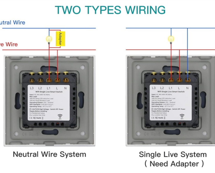

No. It is connected between the switched live (from L1) and the neutral at the light - as in the diagram.

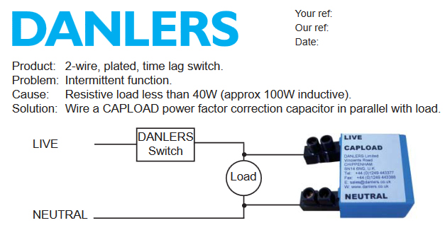

1730333885991.png I would say some one has got the labels the wrong way around. Some switches can use the current through the bulbs to power them, but much depends on the design of the bulb, it can cause them to stay on dim, or flash, when off, and can also cause a shimmer when switched on.
I have with the Energenie switches found some bulbs will work A1 with no capacitor load-capacitor.jpg others even with the capacitor they have a shimmer when switched on, and only way to find out is try it.

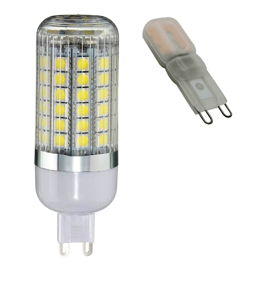

This is why I changed to type with battery to power them. Living room, dinning room, my bedroom, wife's bedroom and office all had Energenie light switches. And only my wife's room with 5 x G9 bulbs to start with caused a problem, swapping bulbs G9-comp.jpg the large one instead of small one cured the problem after many other attempts, however as time went one, one by one the switches turned into flasher units, and now only 2 of the original 5 still working.
Thanks, so I just connect it to the live + neutral at first downright, would I then need 1 of the adapters for each following down light or just the first
I know that, only need to know if 1 adapter on first dowlighter or on all
