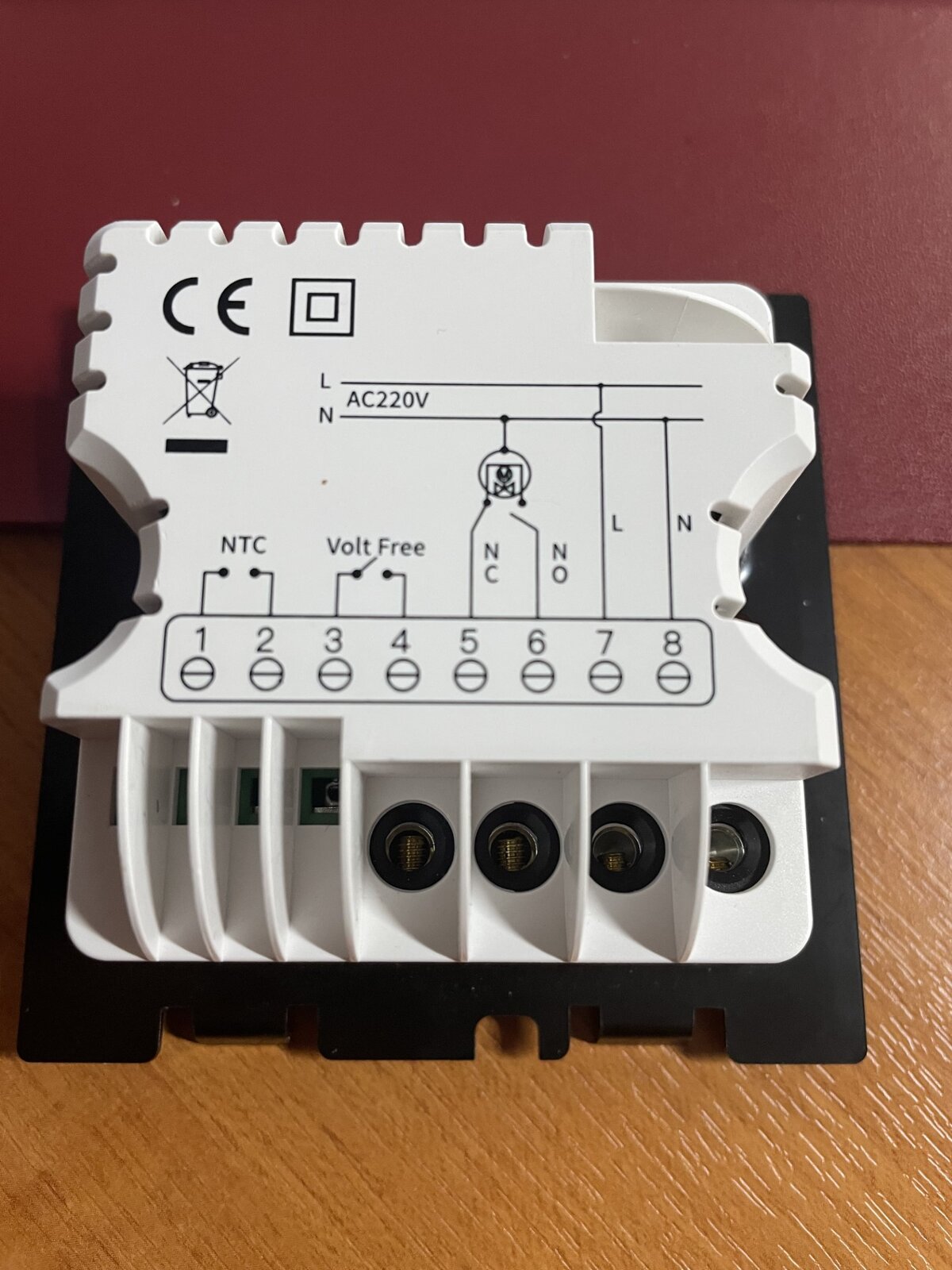

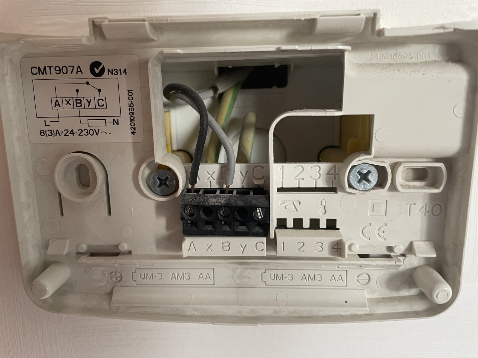

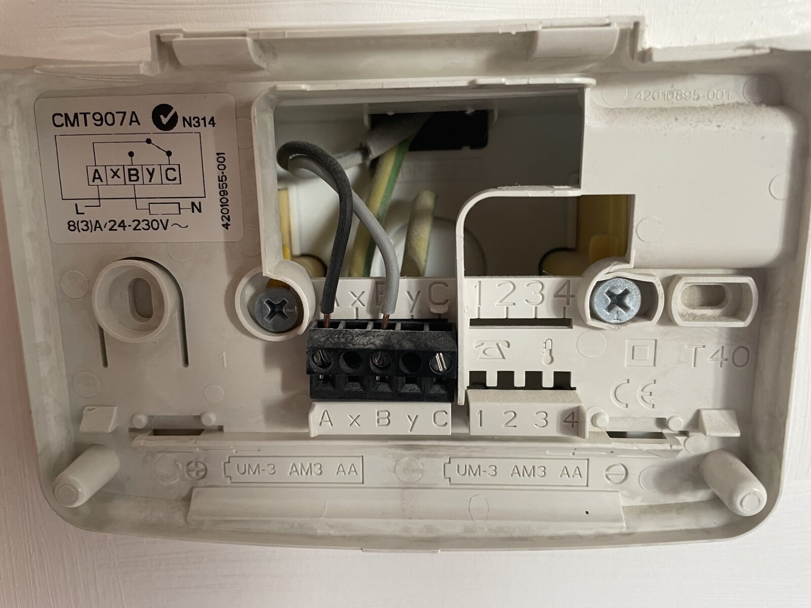

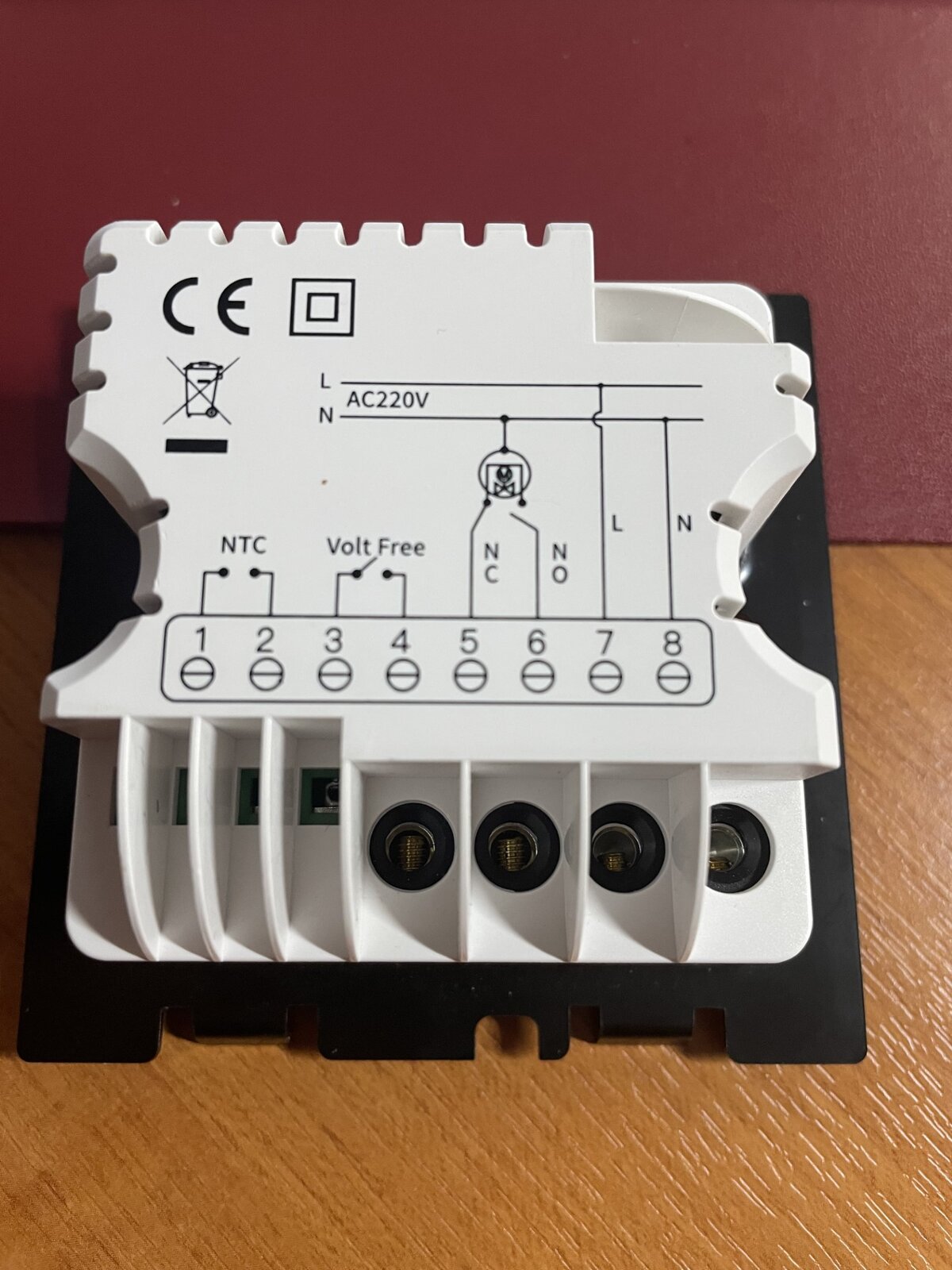

A year or so on from my last question I'm fitting a similar thermostat to my upstairs heating system.
I thought it would be the same wiring as the downstairs but there are only two wires this time! Live & Neutral.
So the one removed was a Honeywell CM907 - has batteries to run the clock etc. so I'm thinking that's the difference - the new one is mains powered.
New one is an AWOW TH113
Thanks!

I agree completely with the above, but one last chance - it's unusual to find a cable with just black and grey cores - is there an extra brown core that has been cut off and hidden, in that cable?
Some repurposing of wires would also be required at the wiring centre, it would be much simpler to go with a battery operated stat...
Thanks to all - I thought that was going to be the case. Hopefully I can return the new one.
I wanted to control both areas on one app so will need to change the downstairs one to whatever works for the upstairs arrangement. I'll have a look at the Nest E as suggested.

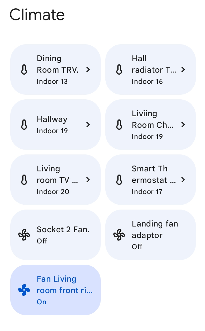

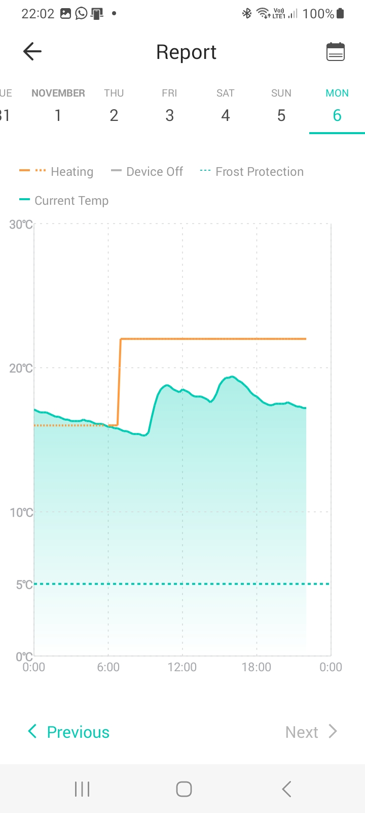

Google Nest Mini's allow control of multi items a little like Alexia and the app which goes with it google home allows many items to all be controlled with one app, 1699307402474.pngas to geofencing I have not found it works too well, it may be they are not all the same, Nest only allows home and away temperatures you can't set distance, my TRV heads from Energenie also have geofencing, but not really tried to use it. Can't find it with TP-Link (Kasa) however when I looked to see realised it does things I had not realised, the timing I knew about 1699308723833.png but the report 1699308796746.jpeg i did not realise was there. The TRV does not link to the wall thermostat so it can only get the room to temperature if the wall thermostat is causing the boiler to run.
