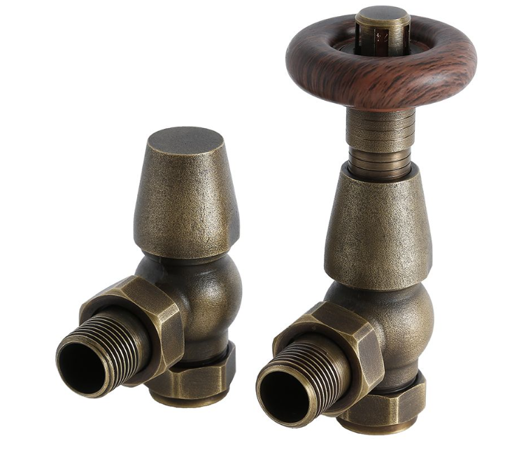

Anyone know of an adaptor that would allow a smart TRVS to fit on one of these? I know the smart ones come with some adaptors but the supplier (Best Heating) says they're not compatible. They're Milano Windsor traditional TRV. Thanks
Standard TRV is normally something like this
there are many ways to grip the body, so the head can push the pin, but not seen any with a wheel that can be turned.
Looking at the diagram, hard to see how they work. I had always assumed they were just taps.
Ah okay, that's a shame. Plenty of them around so there'll be a market for them!
