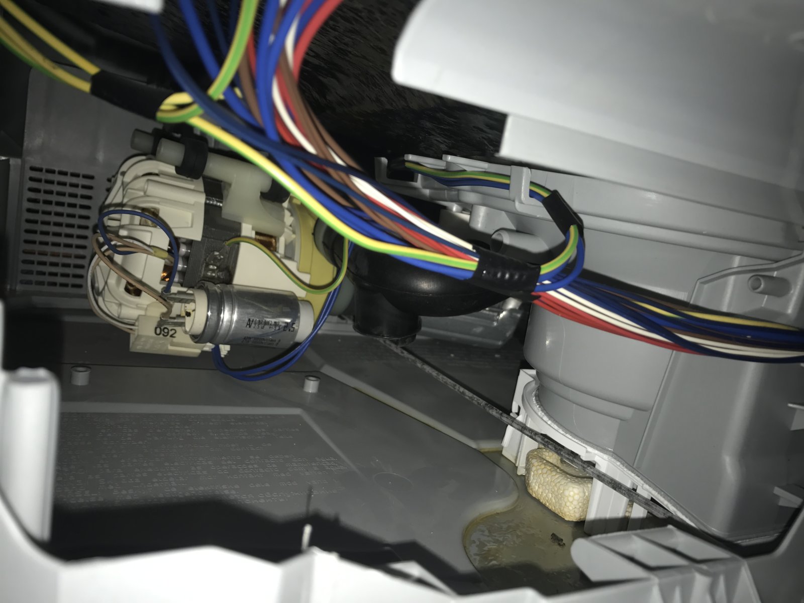

When you say 'relay', do you mean the little styrofoam float? I've tried tapping it and it moved up by about a couple of millimeters. But doesn't make a difference. Or did you mean something else?
I have attached a photo. Please let me know if that helps?
that float is what operates the drain function microswitch, do you hear a click when you raise the float? and a click when you lower it?
the relay would be located on the mainboard, 240v voltages present so be careful.
the float does not look like it is centred under the white 'pan', is there a lever attached to the float, usually a blue, black or white lever (stick), pointing upwards.
the lever could be wedged between the float and the microswitch.
careful, the floats do easily break up especially if they have become brittle
sometimes there is not a lever but the float itself that makes contact directly with the microswitch
this would not have been caused by the power cut but worth checking first especially whilst your there
