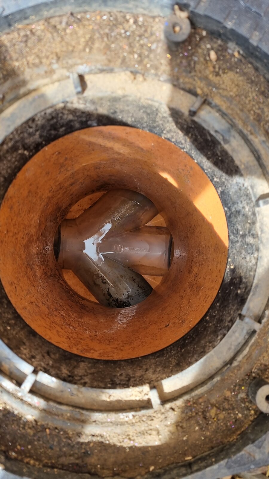

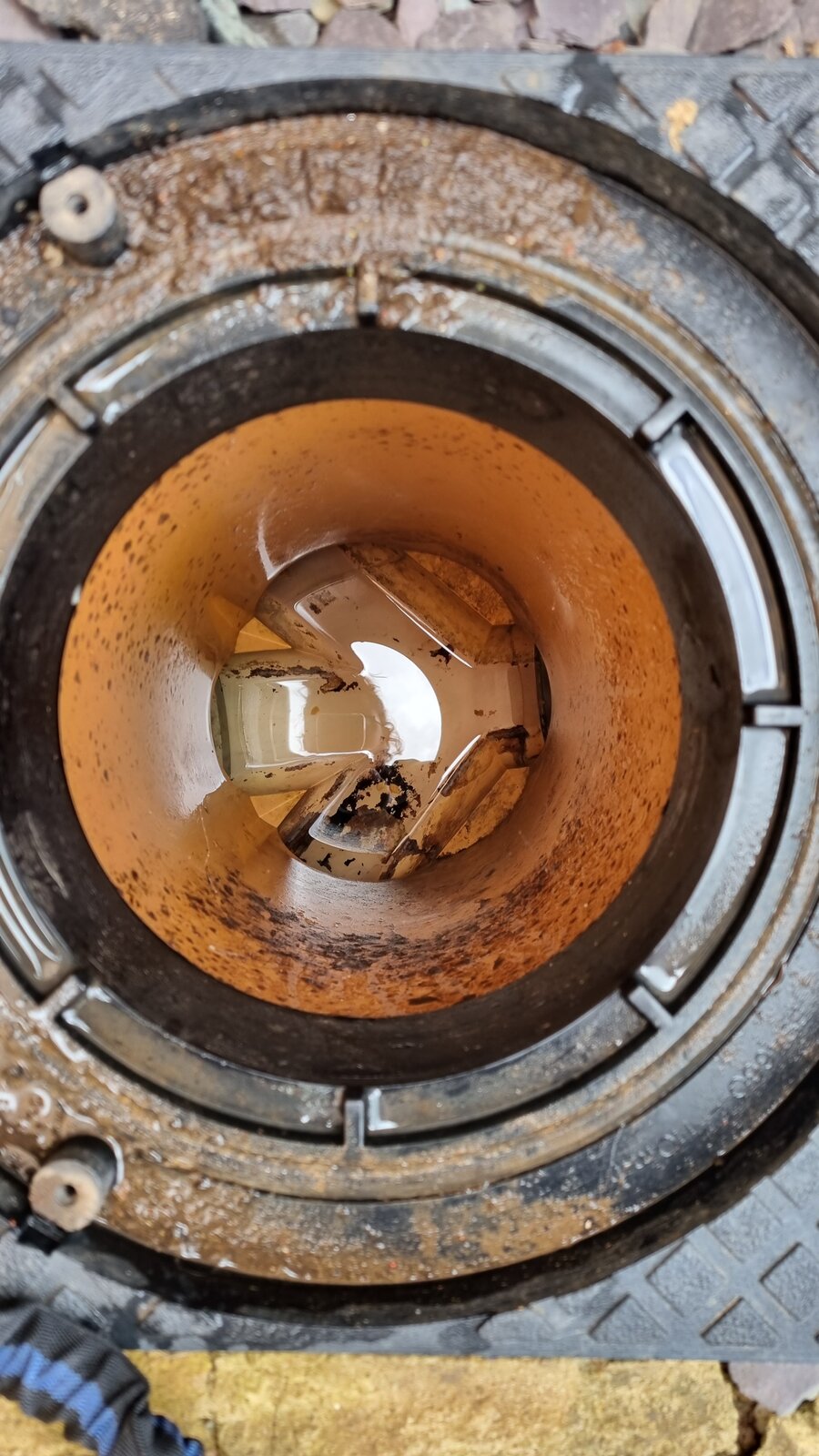

Can anyone help? We live in a town house on a development built around 2005 ish? We are renting and are having problems with waste not leaving the inspection chamber. I've developed an intimate relationship with the inspection chambers! When we flush any of the toilets it comes through fine so presume no blockage in the house. What happens though is the waste doesn't then go down to the main pipes. It gets pushed back into the other inlet pipes and then just sits there. They are three way chambers. The downstairs toilet one is particularly bad as it pushes it back up the pipe that is the sink waste. The waste then sits there and the smell comes through the plug of the sink. I think the problem is the angle of the pipes in the inspection chamber is too flat so waste doesn't get sent away by gravity! As you can tell I've spent a long time looking down the drains! I have to push it through with a hose about every two days. Our landlord doesn't seem to know what needs to be done (or I suspect it will be expensive) although they admit there have been mysterious smell issues for the past couple of years. Has anyone got any suggestions or advice as it is really unpleasant and costing a fortune in water. Thanks :)

Blockage, partial blockage, backfall or combination of these. Are you able to post photo of inspection chamber(s) with fault? If you’re getting smells through the basin waste, then I suspect the trap is being lost. Also since you’re renting, and your landlord has no clue, then they need to employ a decent drainage company.
There are two pictures attached - they are clear at the moment as I have flushed them through - it's a grim sight beforehand!

Photo file ending 417 is:
Top - comes from downstairs toilet
Middle - comes from downstairs sink
Bottom - comes from ensuite on 2nd floor
Solid waste from Top and Bottom goes into chamber and then most of it flows straight into middle inlet and sits there until flushed away hence the smell coming through the sink plughole.
Photo file ending 429 is:
Top - comes from 1st floor toilet, sink and bath
Middle - comes from kitchen sink, dishwasher, washing machine
Bottom - I have no idea what comes out of here - cannot locate anything
Solid waste from top mostly gets stuck in opening of bottom

Bottom picture ( sorry, can’t open your pdf’s)......
You can see two swept inlets and one entering from the left.
I’d have the right outlet jetted ( there could be another chamber further on) to ensure all is flowing well there.

Unfortunately there’s not much to go on from photo’s, but thanks anyway. Could be the inspection chamber has been fitted the wrong way round, or backfall. If you’re getting stuff stuck from one outlet to another, it might be entering too quickly, or still could be a partial blockage.
