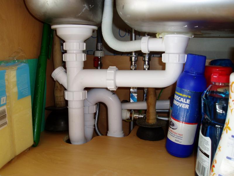

Ok guys an update to where we are now. We think we have linked the problems to a smell in the water from the cold tap which in turn is exaggerated by the dishwasher drying cycle (as this is cold fill). Dishwasher was stripped down and cleaned, waste pipes (that i could dismantle) removed cleaned and put back, all leads to washing machine and dishwasher replaced, vast amounts of sink and plughole cleaners used plus dishwasher cleaners probably used everything on market........so the other day i took a sample of water from my outside tap which has a hose attached to it, took sample from hose end...it had a funny smell to it not quite what we experiencing but definately a weird smell. The tap is directly outside where the sink is situated so i turned the water off that leads to the outside tap, this is situated under the sink....and....it has ..we hope gone and where we used to get the smell coming up from the sink that seems to have also disappeared, could this have been the source of our problems? Or is that highly unlikely? It seems strange that the smell has improved since doing this..any thoughts??? :confused:
it should not happen... but could dirty water be coming up the hosepipe?
take the hose off
the outside tap should have a non-return valve on it
have you got a shower pump or anything sucking on the cold water pipe?
I'm sure that it does not have a non return valve on it as it has the same as the dishwasher and washing machine which either allows it to be turned on or isolated (turned off) using a screwdriver. we have a power shower located on the second floor but thats all!!!
We have disconnected hose pipe and isolated the water from there under the sink.
That i'm not sure about, this is a new built home and the power shower was already in when we moved. i will try to find out, could that cause problems? By the way JohnD thanks for your help so far its much appreciated.
