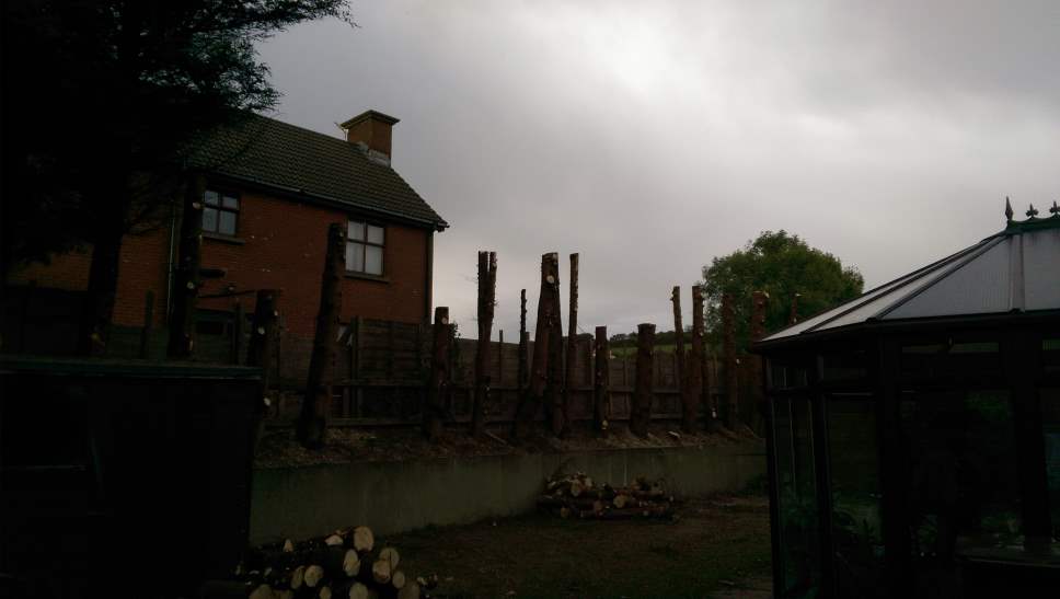

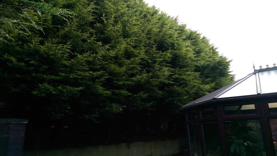

Here's a before and after of the Leylandiis in the back garden...
