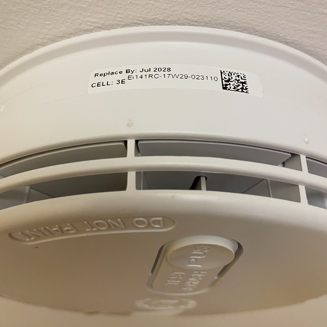

My AICO smoke alarms all have a 10year opertational life with a replacement dated sticker on them (some sellers sell old or even out of date ones!! hence suggest go to a reputable seller). So I change those every 10years (and I damage them to ensure no-one takes off the stickers and puts them on ebay).
My battery CO alarms (so far) have all had a 5 year opertational life with a replacement dated sticker on them. So I change those every 5years.
