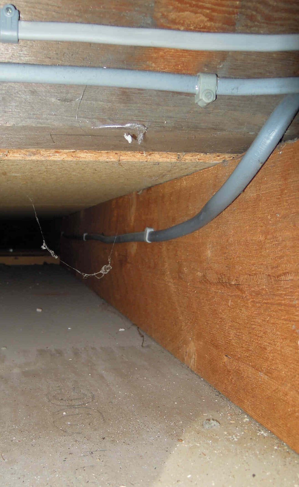

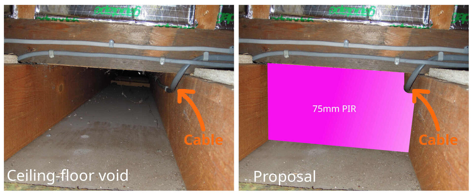

This is a photo of the ceiling-floor void that I will be plugging with PIR insulation. In some of these sections there are cables running down the joists. Some are 1.5mm for light fittings, some are 2.5mm for the ring and on one section there is 6mm for the cooker circuit. I will be cutting a hole on the side of the insulation so the cables are able to dissipate heat, but how large should the holes be? The PIR is 75mm thick.
Could I put flexible split conduit over the cables and then make a hole in the side of the insulation that fits around the conduit? If this is a good idea what diameter should the conduit be?
Look up “cable installation reference methods” and find some diagrams.
What you have currently is “method C”, “clipped direct”. When you add the insulation it will become one of the “10X” methods. Which one depends on what the cable is in contact with and the amount of insulation. The combination of the installation method and the cable size determines the current-carrying capacity.
Generally, lighting circuits - protected with a 6A MCB and any cable size - can be installed using any of the methods and have sufficient capacity.
Socket ring circuits in 2.5mm can only be installed with methods 100 and 102.
What rating MCB does your 6mm cooker circuit have?
They dissipate heat by conduction into the wood that they are clipped to. No need for any specific hole size.
I don’t think you want to do that; it’s reducing the contact between the cable and the wood. I believe it is “method A”, though that may depend on the thickness of the insulation.

It's tricky interpreting those methods in relation to this application. My understanding is that the gap between the cable and the PIR is not relevant although it shouldn't touch, but the cables need to remain clipped to the joist.
Because of the way the 6mm cable is bent as it routes under the floor towards the kitchen, the cable has no clip at the point where I want to place the insulation. Is this okay, as the cable isn't flat enough against the timber to clip at that point.

30A fuse with 6mm cable can be installed by methods 100 and 102 only if you have a cartridge fuse, not a rewirable fuse.
Yes they should remain clipped.
Probably OK as long as it isn’t surrounded by insulation.
Is it considered surrounded in this instance if the PIR is not touching it?

So as noted, you cannot insulate near the cooker cable.
Okay. So, with a new consumer unit and RCBO the insulation would just need a gap large enough for the cable to pass?
