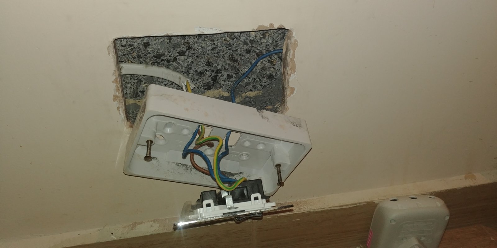

Does the neutral return to the lighting circuit? I recently had exactly this, but in my case the neutral was borrowed from the socket ring!
Do you know why?
What is the blue in the cable connected to - or why did they not just connect all to the socket circuit?

In my situation live and earth came from a light switch further up the wall, the wires ran under the floor to a 13a socket wire powering some led lights. The neutral from the 13a socket didnt have a neutral available in the light switch so instead someone wired it to the nearest available neutral wire which in this case can be seen as a random extra blue wire in the photo.
