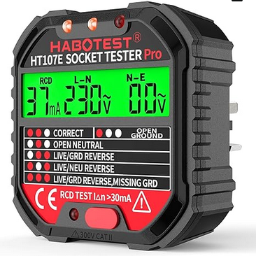

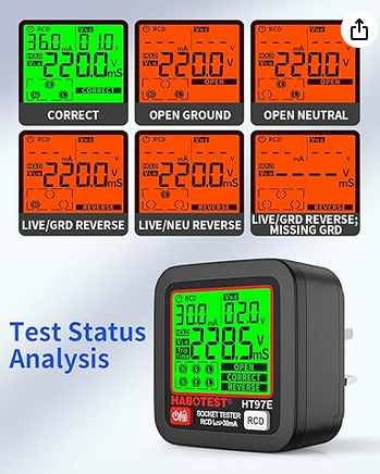

This one 1745718935621.pngis £14, as is this one 1745719077953.pngand one has to ask why are the others so expensive? Could not find instructions but this
seems to show what it does, and one wonders what is the catch?
