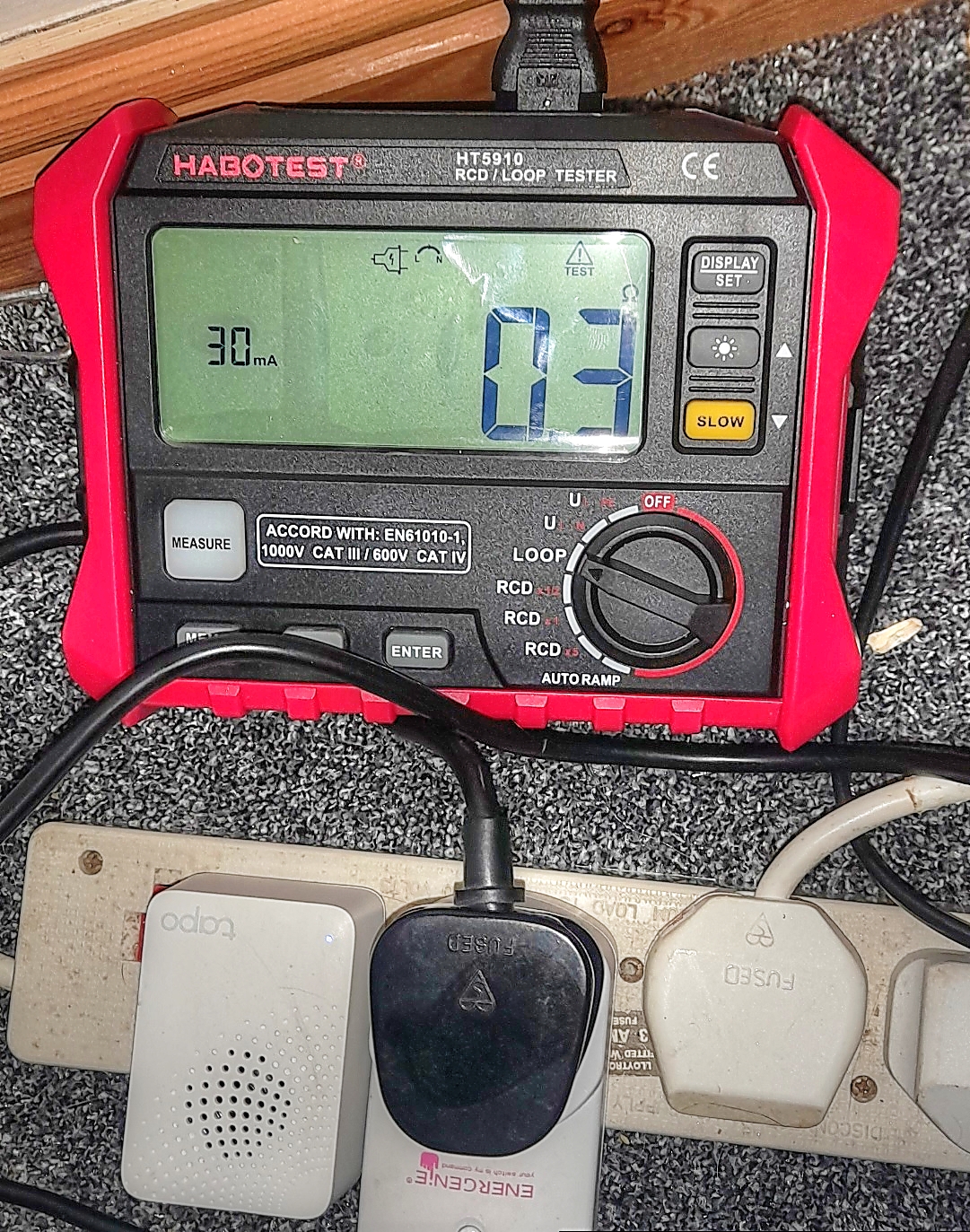

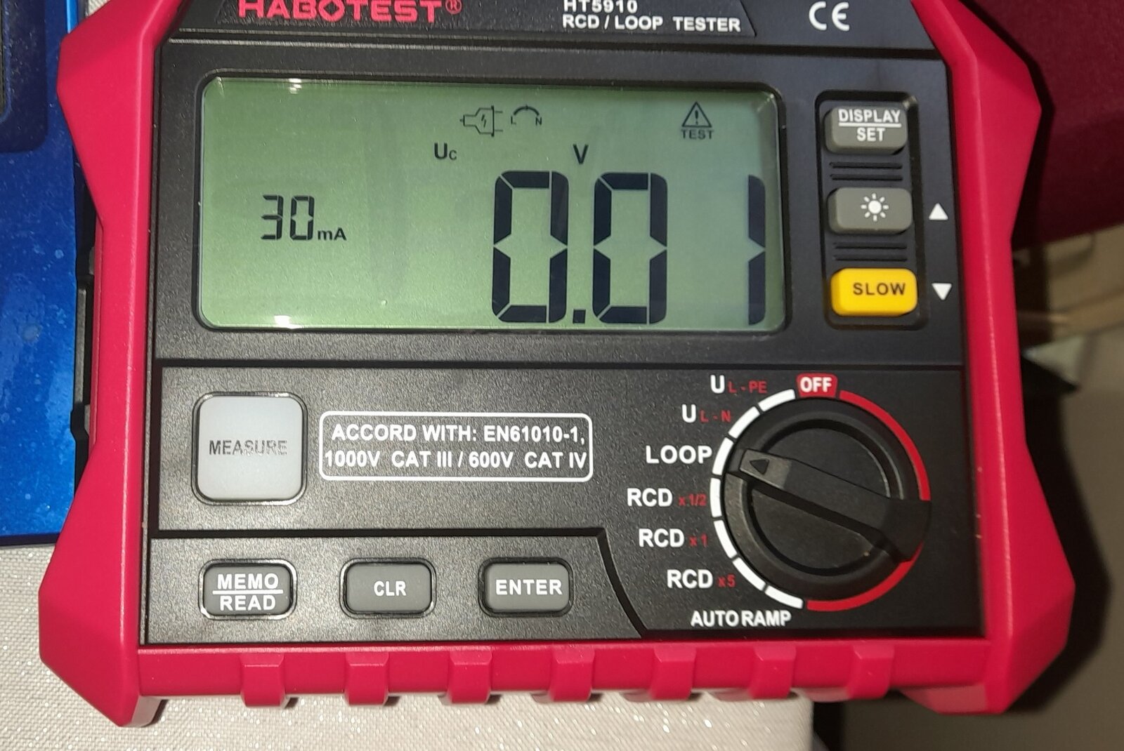

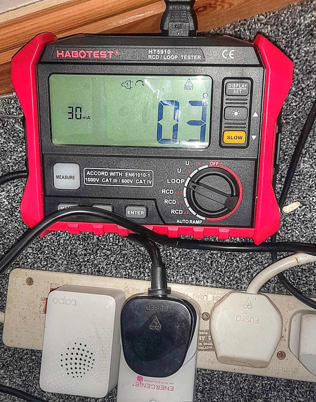

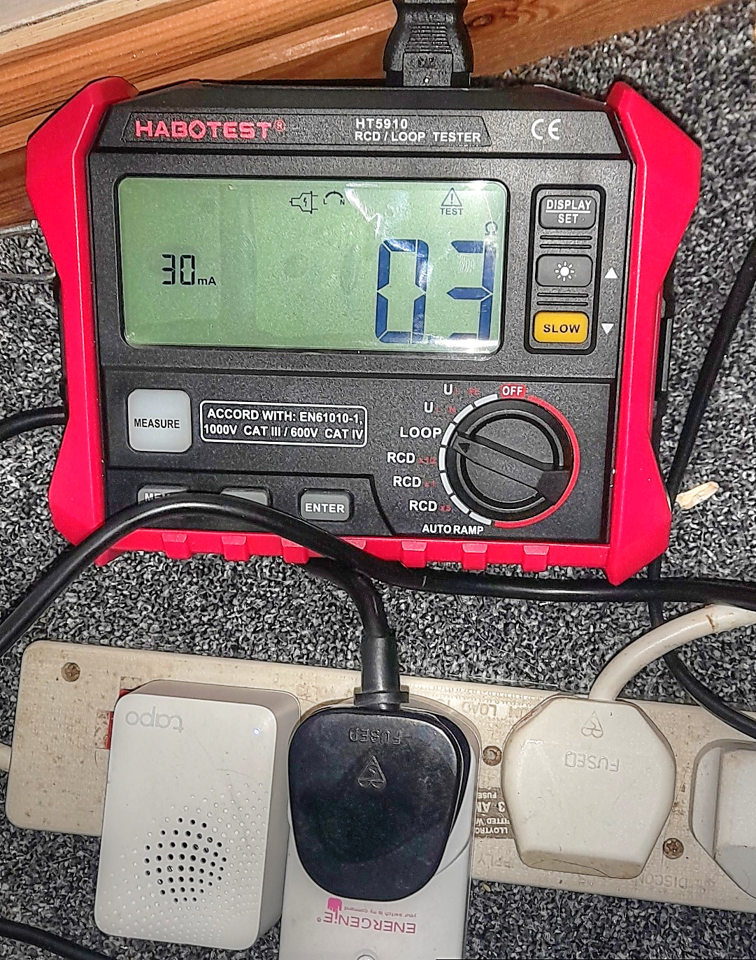

Without loop test 1751018394561.pngare they worth it? Do they give a false sense of security, and for the full-blown tester, ELI-on meter.jpgcan the DIY person work out what they are looking at? As to be frank, I have failed to work out what the 0.01 refers to, press a button Loop-test.jpg and yes loop impedance shows, although only one decimal place, and the RCD test is spot on, but what was wrong with plugging in a standard lamp?
