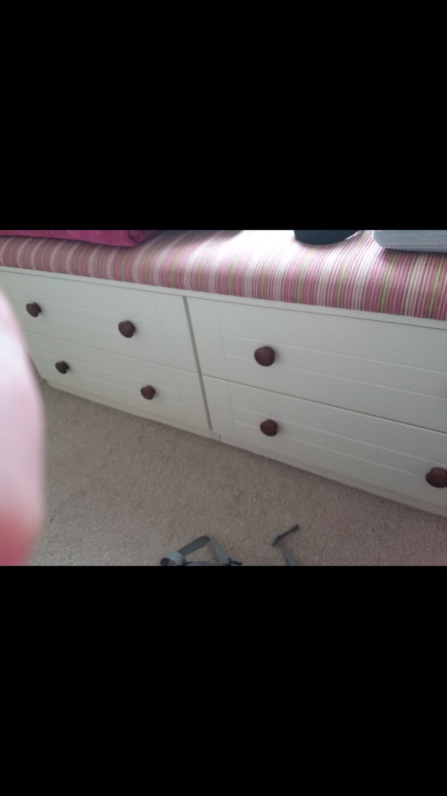

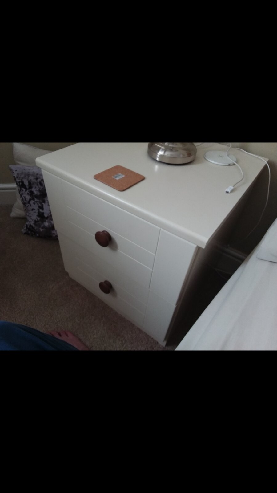

My "soft-close" bedside cabinets close too quickly and with a loud bang. Rubber pads don't help.
I cannot see the manufacturer's name nor any way to get to the mechanism. These are solidly built cabinets.
I don't know how to fix this.

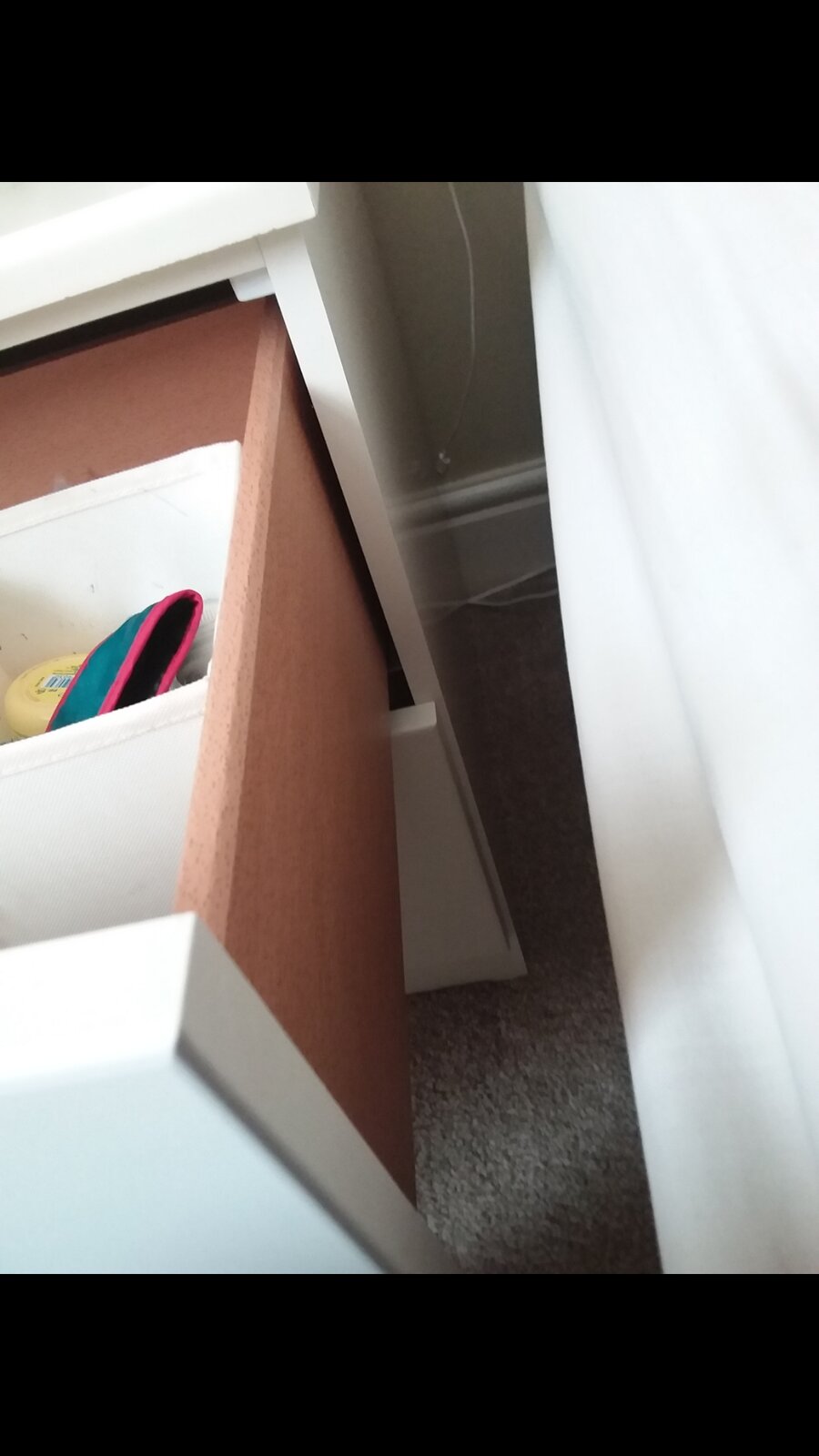

Thank you. Looking from underneath the drawer, I see the metal runners. the draersth u.
ER....update.. Thank you very much for the inspiration. I was able to remove the drawer to find the runner mechanism. Taking photographs then using Google Photos and its Lens App, the existing runners were identified as 400mm Undermount / concealed Soft Close runners. They seem to be sold under several name including DTC, Infinity, Fusaier and Blum. Prices vary between £80 a pair (can than be correct, but prices do seem crazy at present?) and £16 a pair.
As I'd need 14 pairs of runners, I'll test a pair of new runners first to check for sizes and force of closing. Some seem to be adjustable so that might work.
As an alternative to replacing all runners, I'll also test the cheaper plunger-buffer suggestion per your link. That may not work as space is tight and they'd need to be very strong to cope with the closing power of the existing "soft close" runners.
Freddiemercurystwin, I've moved here 2 months ago and these free-standing cabinets were left. They are very solid. All the 14 drawers have operated the same (fast) way. If a drawer was closing while one's hand was there, it could probably result in a nasty bruise. Thanks again.
