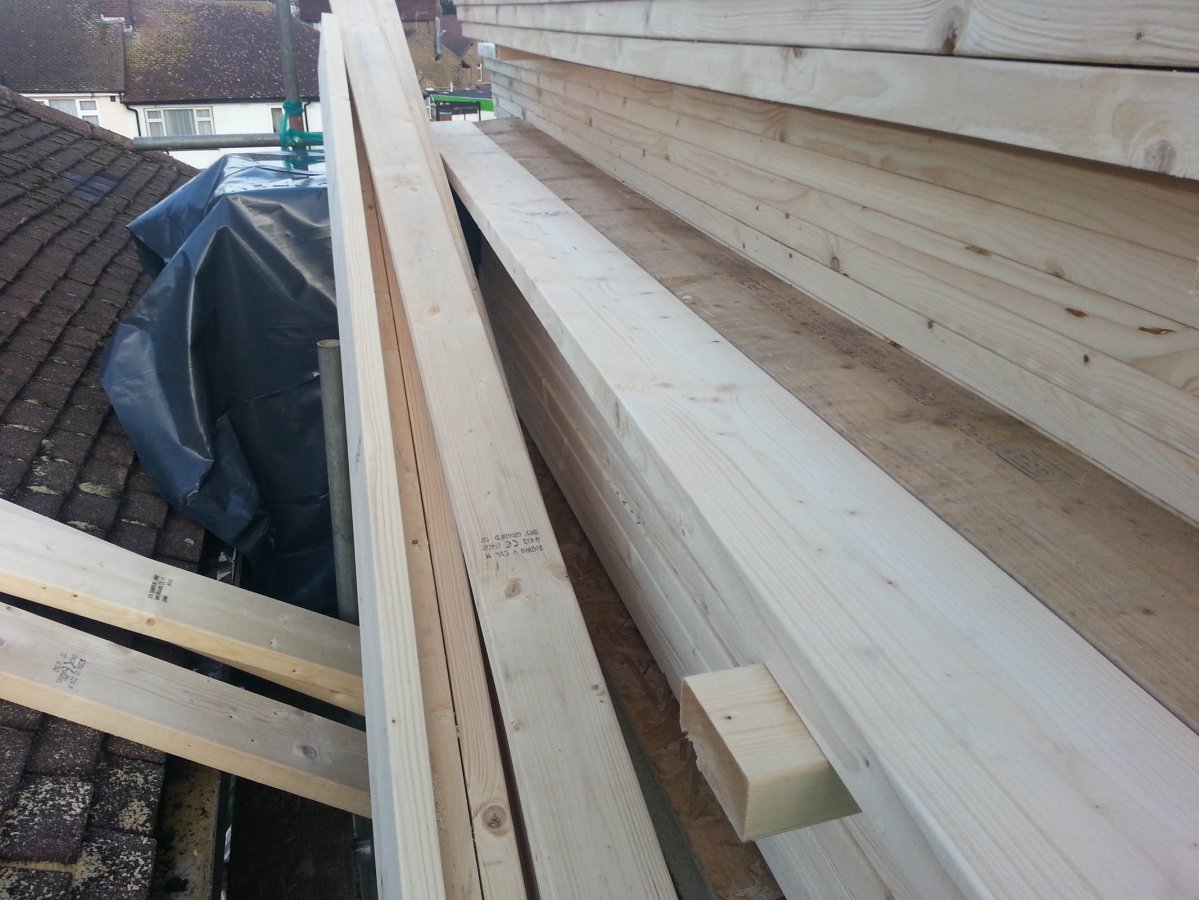

Hi all,

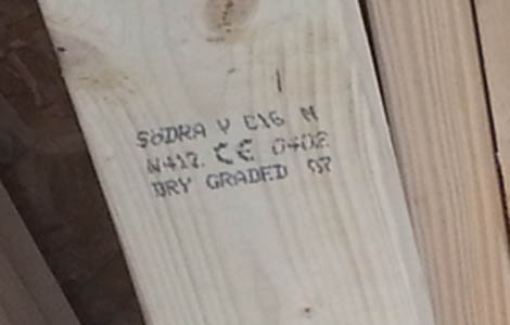

we are having a loft conversion done and a lot of the materials were lifted on to the scaffold before the weekend. I was surprised to see it wasn't covered up. There is a some treated battons, but also a lot of what appears to be untreated timber which I think are for the floor joists, dormer frame etc and also a lot of OSB. (please see pictures)
Its been raining constantly for 3 days and none of it was covered up so it got absolutely saturated, dripping wet. Is this ok to use now? I would've thought it needs to be kept dry or at least allowed to dry out thoroughly before using. If it is used now and enclosed, is that trapping in moisture and potentially causing damp or perhaps warping and shrinking?
thanks in advance
If it's stacked only the top sheet gets soaked, though it's sloppy work to leave it out, the chipboard is the most vulnerable as it turns to mush when wet.
I agree with Foxhole. We always try to sheet-over profiled timbers (e.g skirtings) and sheeting when it has to be stored outdoors, but at least that chipboard flooring is MR (moisture resistant - you can tell by the green colour). We've had P5 MR chip flooring on the current job get soaked a couple of times after installation and it's dried out OK without any problems (although the labourers do vac up the water ASAP in the mornings). Softwood isn't too much of an issue - in fact I find it nails and screws more easily if slightly wet. It will dry out fairly quickly as the build progresses and the drier weather comes. BTW it takes more than a few days of rain to saturate kiln-dried C24
thanks for the replies chaps. that puts my mind at rest. I will ask them to sheet over the materials though. I'm concerned wood lower down that stack can get wet and the water can't evaporate whereas at least the wood on top can dry out when the weather is dryer. I suppose building control will test the moisture content of the wood when they inspect?
certainly wouldn't leave the chipboard out but the rest will be fine.

Lazy builders, get them to cover asap, inspect the chipboard closely as it's installed, anything that looks stained reject it. Bear in mind that moisture resistant chipboard only resists moisture uptake. It is not waterproof.
